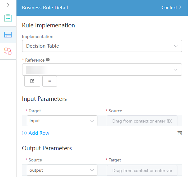

Business Rule
This element generates business rules based on the configuration in the decision table. Then, the system routes the messages to other element nodes based on the output connection gateway of the business rules. During the Business Rule task in the process, the system routes the messages to different route nodes according to the business rules.
- Rule Implementation
- Implementation: The business rules are generated based on the decision table. Select the Decision Table type.
- Reference: Name of an input parameter in the decision table. Only public and global enabled decision tables in the BO that the current project depends on can be used.
- Input Parameters
- Target: Input parameter name of the decision table. Select a value from the drop-down list box.
- Source: Variable in the BPM, which is used to assign a value to the target. Directly enter the value, or drag a variable from the Context page to assign the value of the variable in BPM to the input parameter in the decision table.
- Output Parameters
- Target: Output parameter name of the decision table. Select a value from the drop-down list box.
- Source: Variable in the BPM. The output parameter in the decision table is assigned to the variable in the BPM.
