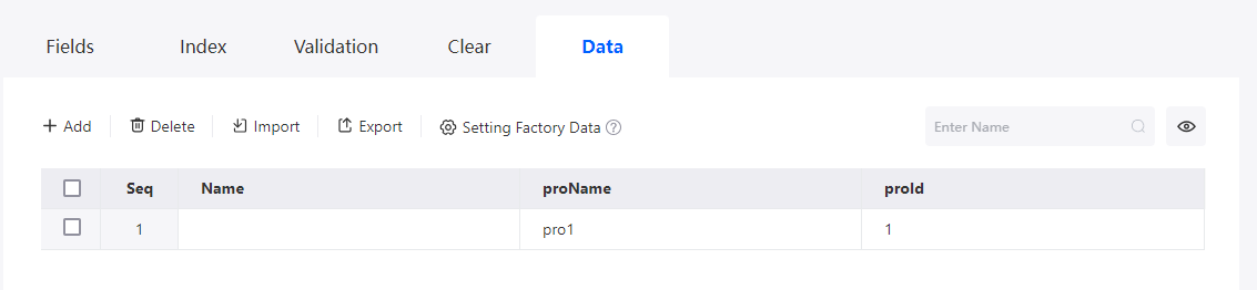

- Create an object model.
- In the navigation pane, choose Page, and click + next to Standard Page.
- At the bottom of the standard page, click Model View.
- Click New, specify Model Name (for example, sqlAdd), select Services for Source, and click Next. Figure 11 Creating a model
- Select the script created in 3 and click the confirm button. Figure 12 Selecting the script
- Click Next and then click OK.
- Return to Designer View and bind the model with the widgets.

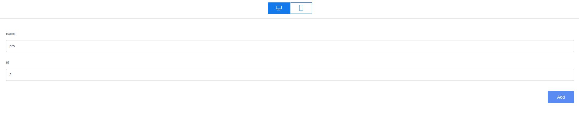

- On the standard page, drag two Input widgets and one Button widget, change the Label of two input widgets to name and id, and set the button Display Name to Add. Figure 13 Final page setting effect
- Select the name input widget, choose Properties > Data Binding and click
next to Value Binding. - Select the model (proName) created in 4 and bind the input widget with the script data. Figure 14 Selecting the model
- Repeat the preceding operations to bind the model (proId) created in 4 to the id input widget. Figure 15 Binding a model to the id input widget
- Add an event for the Add button.
- Select the Add button widget and click the Events tab.
- Click + next to on-click. The page for adding an action is displayed.
- Under Custom Action, enter the custom code and click Create. Figure 16 Customizing an action
In this example, the customized JavaScript code is used to call the service after the submit button is clicked. The service calls the script to add records.
$model.ref('sqlAdd').run().then(function(data){ console.log(data); }).catch(function(error){ console.log('error is', error); });

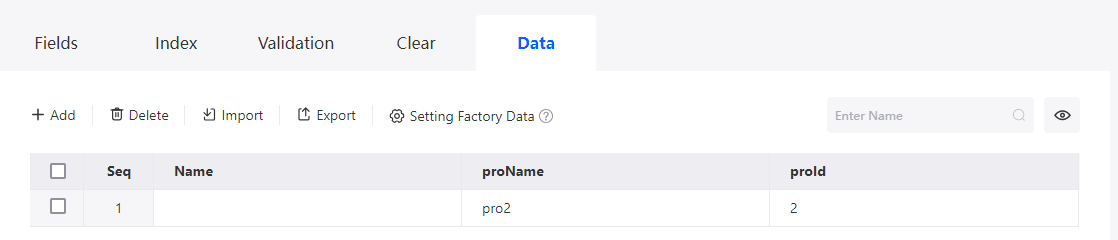

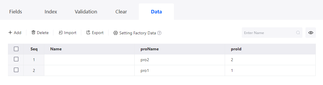

- Return to the standard page and click
to save the page settings. After the page is saved, click
to preview the effect.

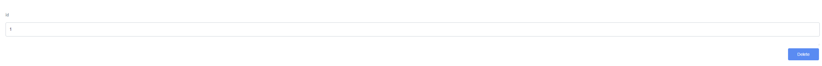

- Drag an Input widget and a Button widget to the standard page, set the Label of the input widget to id, and set the Display Name of the button widget to Delete.
- Select the input widget, choose Properties > Data Binding and click
next to Value Binding. - Bind the input widget with the input parameter id of the sqlDelete model created in 3. Figure 21 Selecting the model
- Add an event for the Delete button.
- Select the Delete button widget and click the Events tab.
- Under Custom Action, enter the custom code and click Create. Figure 22 Customizing an action
The custom JavaScript code in the example is used to call the backend service, and the backend service calls the script to delete data.
$model.ref('sqlDelete').run().then(function(data){ console.log(data); }).catch(function(error){ console.log('error is', error); });
- Click
in the upper part of the page to save the page settings. - After the settings are saved, click
in the upper part of the page to preview the effect.
