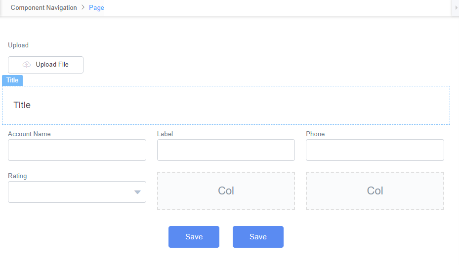

- Open a standard page. Figure 1 Standard page instance

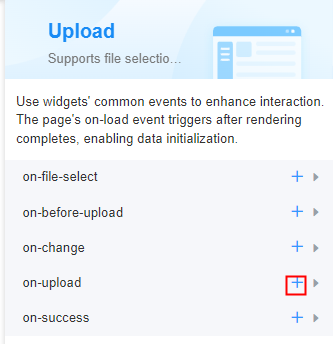

- Select a widget, for example, Upload. In the right pane, switch to the Events tab page and click + next to on-upload. Figure 2 Clicking the plus sign (+) next to on-upload

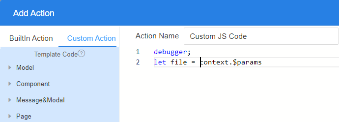

- In the code editing area, use the debugger statement to set breakpoints and click Create. Figure 3 Using the debugger statement to set breakpoints

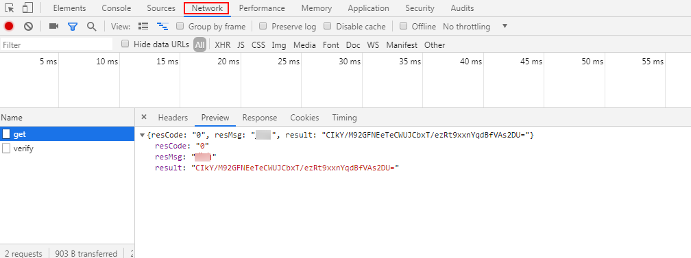

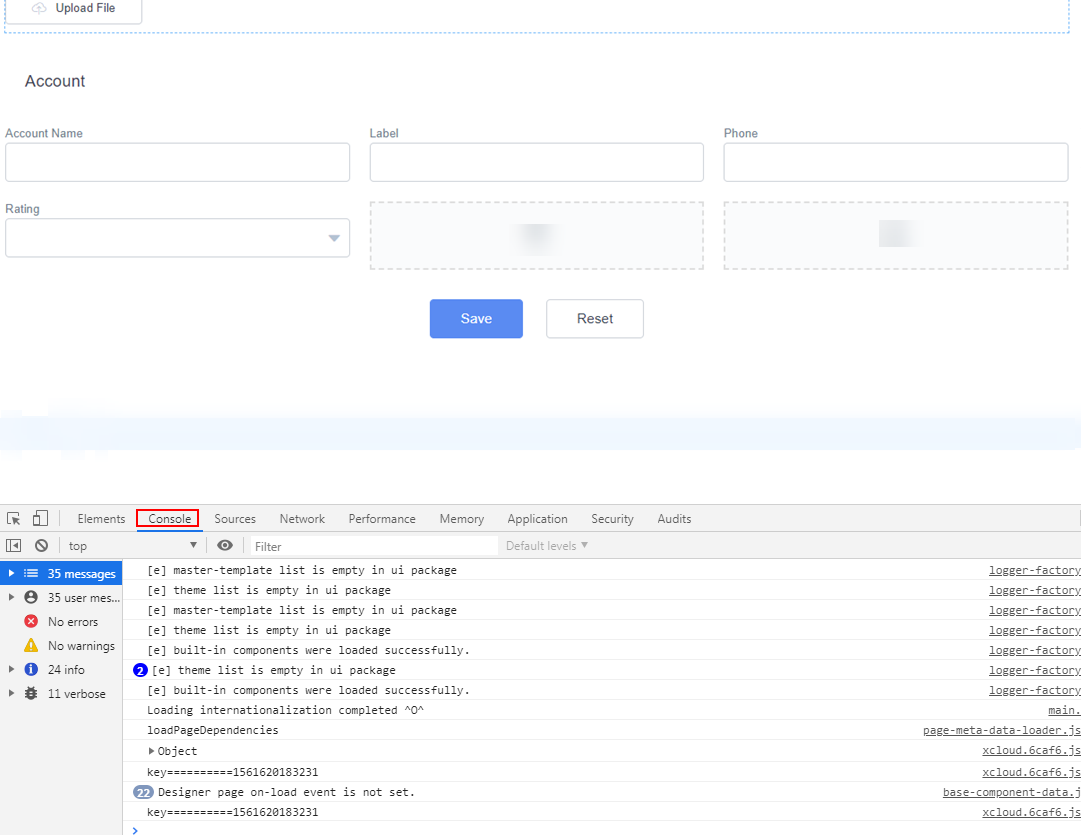

to preview the standard page. - On the preview page that is displayed, press F12 or Ctrl + Shift + I to start the debugging tool. View log information on the Console tab page and network request information on the Network tab page.Figure 4 Viewing log information on the Console tab page
Figure 5 Viewing network request information on the Network tab page

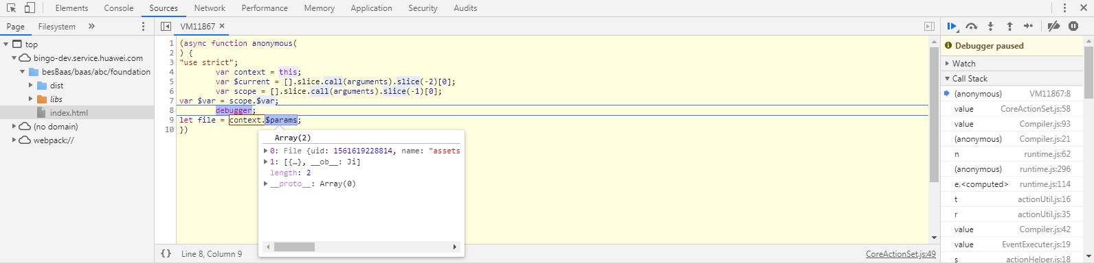

- Click the upload button to upload the file. The debugger statement is used to set a breakpoint in the custom JavaScript code of the uploaded event. Therefore, the event code stops when the debugger statement is executed.
- You can press F8 to go to the next breakpoint or press F10 to go to the next line. Figure 6 Debugging JavaScript code

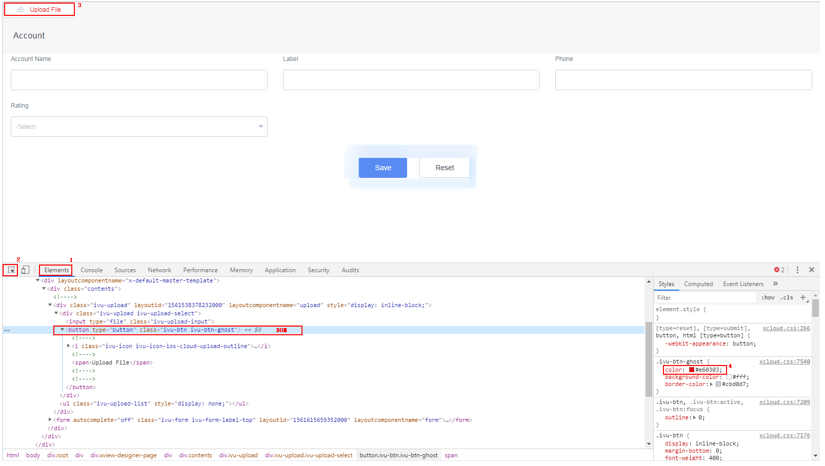

- On the standard page development page, click
- Click the Elements tab and click the selector icon on the left.
- On the preview page, select a widget and debug the style in Styles in the lower right corner. For example, change the font color of Upload File or change the DOM structure. Figure 7 Debugging the DOM structure and style
