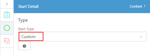

in the upper part of the page to run the BPM. On the BPM design page, you can start a BPM in either of the following ways:- Custom: Set the start type of the Start diagram element to Custom. The event cause is not specified, that is, the trigger condition does not need to be specified. Figure 1 Custom

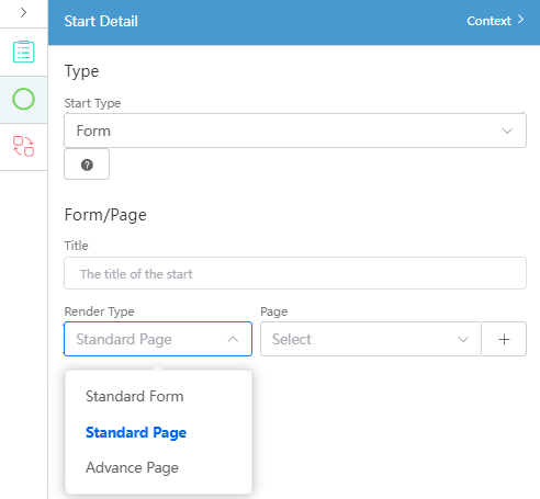

- Form: A BPM is started using forms or pages. If this option is selected, you need to configure a specific form, standard page, or advanced page. Figure 2 Form
