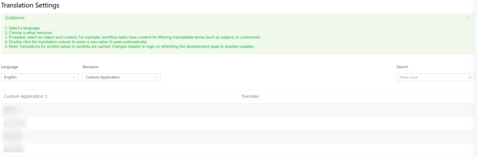

Using an Added Language
After a language is configured and enabled, it will appear in the language area on the right side of the translation page. Translators can then use this language for translation tasks.
Most translation records are used by application developers. Huawei Cloud Astro Zero only uses part of these records, such as those related to custom applications and menus.
- Log in to the Huawei Cloud Astro Zero console and click Access Homepage. The application development page is displayed.
- In the upper left corner of the page, click
and choose Environments > Environment Configuration. - In the navigation pane, choose System Settings > Internationalization Settings > Translation Settings.
- Follow the translation guide to complete the translation.
Figure 1 Translation
