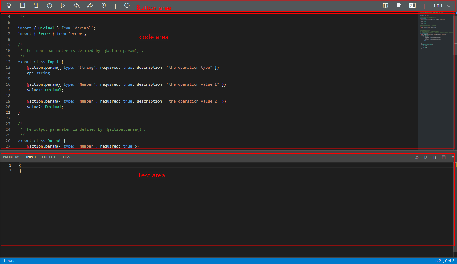

Figure 1 shows the script editing page where you can edit, test, and publish scripts.
- Button area Table 1 describes the icons on the script editing page.
Table 1 Icon description Icon
Description
: Click this icon to activate the script. If this icon is highlighted, the script is activated. After a script is developed, you need to activate the script. Only activated scripts can be found when being called by other resources (such as flows and standard pages).
: Click this icon to deactivate the script. If this icon is not highlighted, the script is deactivated.
Save the script.
Save as a script.
Set script properties, such as visibility and whether to enable overwriting.
Run the script.
Undo and redo operations.
Check the performance, compatibility, and static configuration of the developed script code. For details about code check, see Rules for Checking Script Performance.
Refresh imported scripts to the latest status.
Click this icon to open the script editor in a split-screen view.
After the script is activated, click
in the upper right corner to view the calling relationship of the widget.
Go to the TS script manual.
Compare versions.
Switch versions.
- Code editor
You can develop code in this area to implement functions. The code editor provides functions such as intelligent prompt, code completion, and display of the row and column where the cursor is located. For more information, see AI Code Completion.
The script editing page also supports common shortcut keys in offline editors. For example, you can press Ctrl+S to save the modification, and press Ctrl+H to display the Find and Replace dialog box. You can try various shortcut keys as required.
- Test area
Display area after the code is run. After parameters are input on the input parameter tab page, click
on the right of the test area to run the script. You can check the output result on the output parameter tab page and view issues and logs on the problem and log tab pages, respectively. In addition, you can clear log outputs, run scripts, and dynamically check and save input parameters.

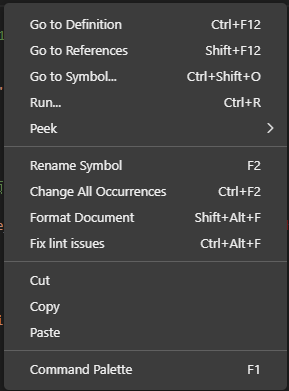

Right-click the code editing area to view the navigation shown in Figure 2. The script editor also provides functions such as intelligent prompt, code completion, and display of the row and column where the cursor is located.

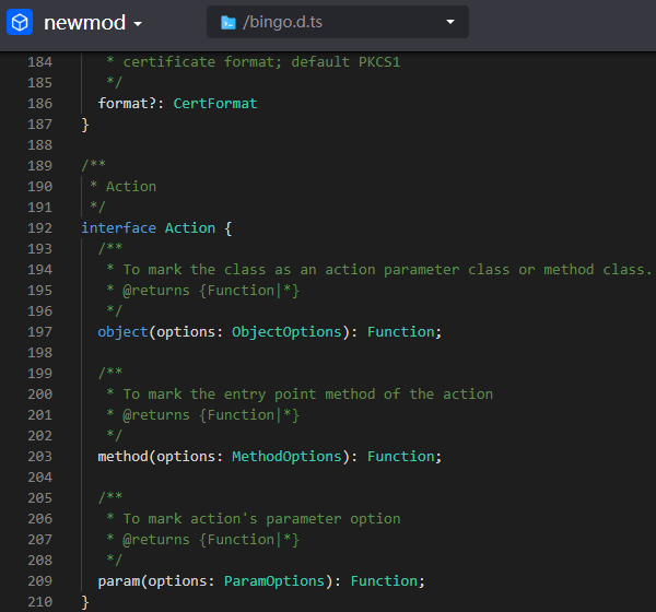

- Go to Definition
Right-click a symbol in the code editing area and choose Go to Definition to search for the symbol code definition.
- Go to References
Right-click the code editing area and choose Go to References to view the symbol reference in the script.
- Go to Symbol
Right-click the code editing area and choose Go to Symbol. Select a symbol to jump to the part of its code definition.
- Run
Right-click the code editing area and choose Run to run the script.
- Peek Definition
Right-click a symbol in the code editing area and choose Peek > Peek Definition to view the code definition.
- Peek References
Right-click a symbol in the code editing area and choose Peek > Peek References to view the code reference.
- Rename Symbol
Right-click a symbol in the code editing area and choose Rename Symbol to rename the symbol.
- Change All Occurrences
Select a string, right-click the code editing area, and choose Change All Occurrences to modify all occurrences of this string throughout the code in batches.
- Format Document/Format Selection
Select a code block, right-click the code editing area or anywhere and choose Format Document to format the code.
- Fix lint issues
Select a code block, right-click the code editing area or anywhere and choose Fix lint issues to fix static specification errors.
- Cut/Copy
Select a code block, right-click the code editing area, and choose Copy to cut or copy the code.
- Command Palette
Right-click the code editing area and choose Command Palette or press F1. The command palette is displayed for you to perform editing functions.

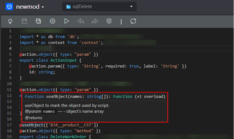

- Hover
Hover the cursor over a symbol to view its definition summary. Press Ctrl and click the symbol to view its detailed definition.
For example, you can hover the cursor over useObject to check its summary, as shown in Figure 3. Press Ctrl and click useObject to view its detailed definition, as shown in Figure 4.

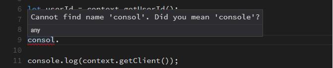

- Errors and warnings
The code with incorrect syntax is marked with red wavy lines. Move the cursor over a line to view the error details.
Figure 6 Errors and warnings

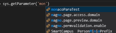

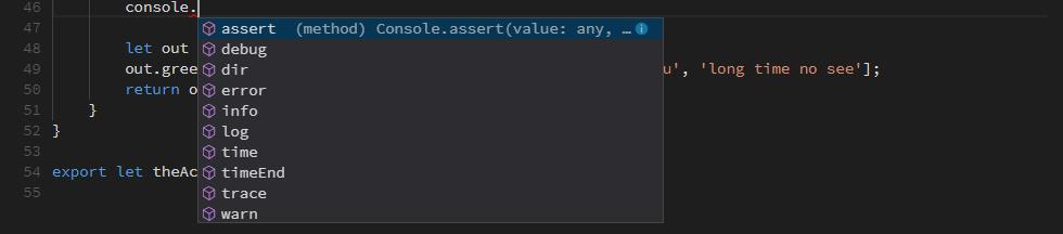

- Code complete
- Complete a symbol. Figure 7 complete_symbol
- Complete an object member. Figure 8 complete_member
- Complete a parameter. Figure 9 complete_parameter

AI Code Completion
The code completion engine learns coding habits from the historical scripts and learns context syntax from the current script. The system provides prompts based on the context and historical code to automatically complete code.
When you write code, code recommendation is automatically triggered. Select the desired content and press Enter to complete it. Move the cursor to the field whose details are to be viewed, copy the text in the floating window, and paste it to the code.
- Common completion: A completion message is displayed when you enter any character during coding.
For example, if you enter @u, the system provides the most likely method in the code editor based on your intent.
Figure 10 Common completion

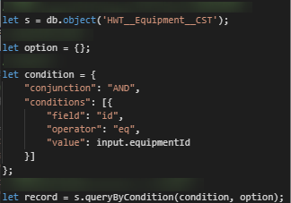

- Custom completion: System dependency libraries are preset in Astro Zero for you to call. You can also configure object data, system parameters, error codes, events, and workflows on the GUI and reference them in scripts. When dependency libraries and configuration items are referenced during script development, a message for completing the potential content is triggered by IDE.
- Dependency library completion: When a dependency code line is introduced to the code, the name of the dependency library is displayed. For example, when import * as xxx from is entered, the name of the dependency library starting with z is displayed. Figure 11 Dependency library completion
- Table name (object name) completion: When object data is introduced to the code, the object name is displayed. For example, when @useObject is entered, the object name starting with m is displayed. Figure 12 Table name completion
- Table field prompt: When table fields are referenced in the code, hover the cursor to the table name to view the table fields in the floating window. For example, all fields are displayed when the cursor is hovered over the table name. Figure 13 Table field prompt
- Error code completion: When a data table is imported to the code, table names are displayed. For example, when setI18nError is entered, error code names are displayed. Figure 14 Error code completion
- Error code prompt: When a data table is imported to the code, table names are displayed. Hover the cursor over the error code name to view the description.
- System parameter completion: When a system parameter is imported to the code, parameter names are displayed. For example, when sys.getParameter is entered, system parameters are displayed. Figure 15 System parameter completion
