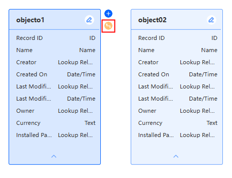

of the target object, and choose Detail to access the object designer. - Click
next to the object. The page for adding an association is displayed.Figure 1 Adding an association

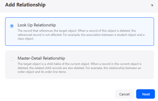

- Select a relationship and click Next.Figure 2 Selecting a relationship type
- Lookup Relationship: You can establish a reference relationship between objects by linking the current field to another object's ID. Once a lookup relationship is set, the current field's value is sourced from the associated object. If you delete the associated object's record does not impact the referencing record.
- Master-Detail Relationship: You can establish a master-slave relationship between objects by linking the current field to another object's ID. This makes the current field's value reliant on the master object. In this setup, deleting a master record also deletes the corresponding slave records, as seen in the relationship between an order and its details.

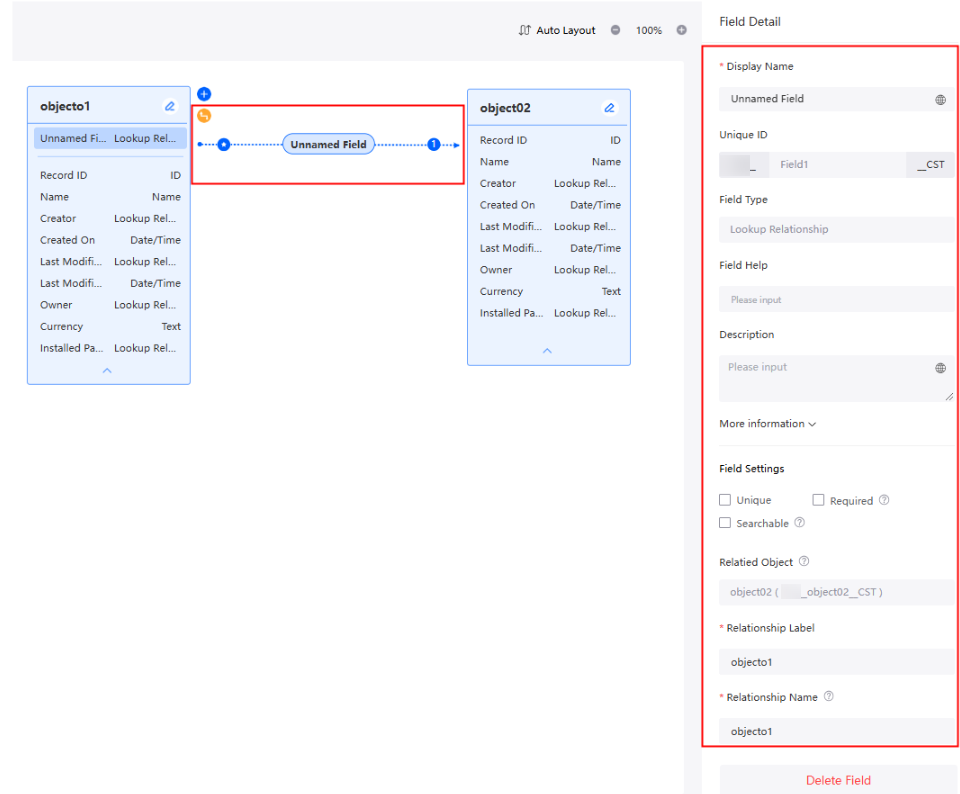

After a relationship is created between the object and the target object, a connection line is generated, as shown in Figure 3.
and
are displayed at both ends of an association relationship, indicating a one-to-many relationship. Currently, both the lookup relationship and the master/slave relationship represent one-to-many relationships. Note that Astro Zero does not support one-to-one relationships.- The arrow indicates the connection from an object with a relationship field to its related object.
- When a relationship line is selected, the attribute panel is displayed on the right, where you can edit or delete the attributes of the relationship field.

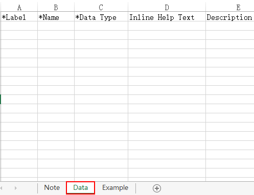

in the object. The object details page is displayed. - On the Fields tab page, choose Batch Create > Download Template. A template is downloaded to the local host.
- Open the downloaded template and click Enable Content in the upper left corner to enable macros.
- Enabling macros is required for verifying field attributes. If macros are not enabled, the template does not verify field attributes.
- If this is your first time using the template, read the instructions (including namespace configuration) in the "Note" sheet. The "Example" sheet provides an example of defining fields in batches.
- Create fields with the template.
Perform the following steps to set the fields to be imported. You can also click here to download an object field template.

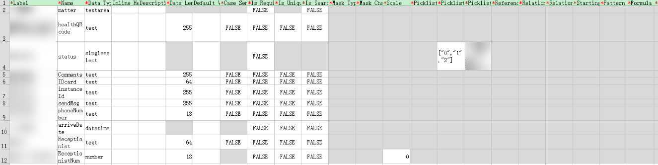

The "Data" sheet includes the type, label, name, data length, and default value of the fields to be created. Columns with an asterisk (*) are mandatory, and columns with a gray background cannot be set.- On the data tab page, set fields as required. Figure 7 Data sheet

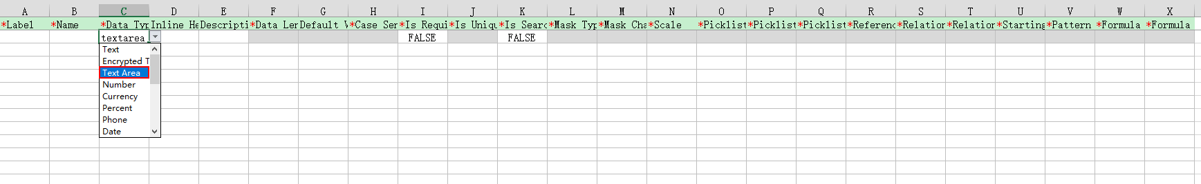

- Click column C (Data Type).
Set the field type. Attribute columns that are not related to this field type are displayed in gray.
Figure 8 Viewing the description about column C
- Click the first row in column C. In the drop-down list box, select Text Area for the first field Namespace__matter__CST. Figure 9 Setting the field type
- Set Label in column A and set Name in column B.
The value in column B must be unique. Columns A and B correspond to Label and Name of custom fields in the object.
Figure 10 Setting the field label and name
- Click each mandatory column and set the attribute values. Figure 11 Setting attribute values

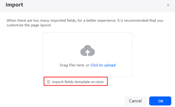

- Return to the object details page. On the Fields tab page, choose Batch Create > Batch Import Fields.
- Select the field template created in 6 and click OK.Figure 12 Selecting fields to be imported from the template

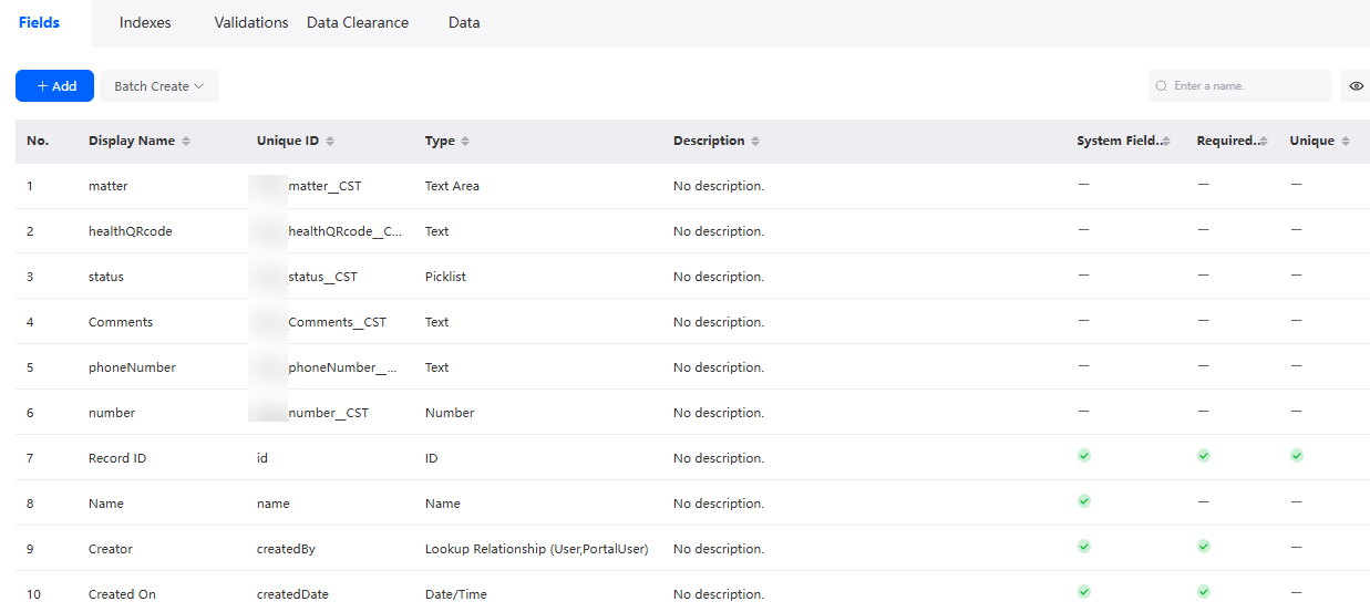

After the import is complete, you can view the imported data in the field list.
Figure 13 Viewing the imported data

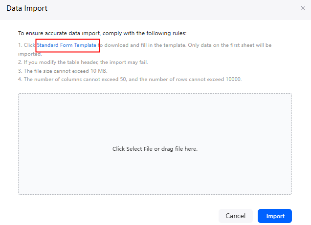

in an object to go to its details page. - On the Data tab page, click Import.

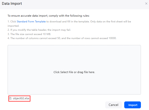

- On the displayed page, click Standard Form Template to download the import template.Figure 14 Downloading a template

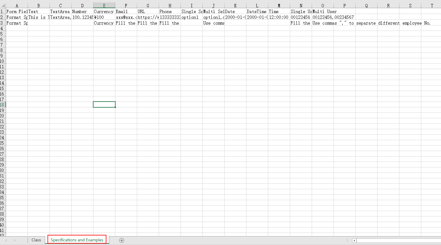

- Open the downloaded template and click the "Specifications and Examples" sheet.Figure 15 Viewing the specifications and example
- Switch to the object table, fill in the fields of the imported data as required, and save the file.
The first row in the file is the column name. The column name must be the same as the unique ID of the field. Otherwise, the field will be discarded during import.
- Return to the data import page, drag the filled template file to the box, and click Import.Figure 16 Importing data in batches
