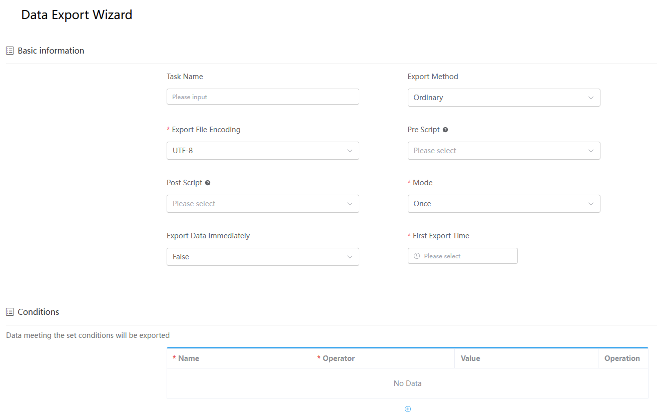

- On the displayed page, click New and set parameters as required.Figure 1 Configuring data export
Table 1 Parameters Parameter
Description
Task Name
Name of the batch data export task.
Export Method
Select a data export mode. Ordinary and Template are available. The default value is Ordinary.
If you want to export the same objects, select Template to avoid repeatedly selecting the same objects during each export. That is, you can create a template in the template area and select the corresponding template to export the same objects.
Export File Encoding
File encoding format, which can be UTF-8 or GBK.
Pre Script
The script to be executed before the exported ZIP package is imported, to clear specified data.
Post Script
The script to be executed after the exported ZIP package is imported, to process specified data.
Mode
Execution times of the export task.
- Once: Data is exported once immediately or at a specified time.
- Multiple times (based on frequency): Data is exported regularly at a specified interval from a given time point.
- By Cron Expression: Data is exported based on the configured Cron expression. A Cron expression is a time-based syntax used to specify the execution time, frequency, and interval of a scheduled task. A Cron expression consists of six fields: second, minute, hour, date, month, and day of the week. For details on the values for each field, see Table 2.
Export Data Immediately
Whether to export data immediately. This parameter is available only when Mode is set to Once.
First Export Time
Time when the export will be executed for the first time. This parameter is available only when Mode is set to Once but Export Data Immediately is set to False, or when Mode is set to Multiple times (based on frequency).
Execute Frequency
Export time unit. This parameter is available only when Mode is set to Multi Times.
Unit
Export time unit. This parameter is available only when Mode is set to Multiple times (based on frequency).
By Cron Expression
If Mode is set to By Cron Expression, you need to set the Cron expression.
Example:
Description Expression Execute at 6:00 every day 0 0 6 * * ? Execute at 0:00, 6:00, and 12:00 daily 0 0 0,6,12 * * ? Execute at 2:00 every Saturday 0 0 2 ? * SAT Trigger at 10:20 AM from Monday to Friday 0 20 10 ? * MON-FRI
Table 2 Cron expression field values Field
Allowed Value
Allowed Special Character
Second
0–59
Not supported
Minute
0–59
Hour
0–23
Date
1–31
Month
1–12
JAN-DEC - * /
Day of Week
1–7
SUN-SAT - * ? /
Table 3 Supported special characters in a cron expression Character
Description
Example
Used to specify additional values.
1,3,4,7,8.
Used to select all values within a field.
If the Minute field is set to *, an event is triggered every minute.
Used to match any value of a field. However, it can be used only in the Date and Day of week fields because the two fields affect each other.
To trigger a scheduled task on the 20th day of each month, regardless of the day of week, use the following format: 13 13 15 20 *?
The 20th day is specified in the Date field, the last character of the Day of week field can only be a question mark (?) instead of an asterisk (*). If the last character is *, it indicates that the event is triggered on any day of a week, which is exclusive with the 20th day of the date field. In this case, the expression is incorrect.
Used to specify ranges.
For the Hour field, the value ranges from 8 to 10, indicating that the incident is triggered every hour from 8:00 to 10:00.
Used to specify increments. An incident is triggered from the specified time and at a fixed interval.
In the Hour field, */3 is equivalent to "every three hours". That is, an incident is triggered at the following time points in a day: 0, 3, 6, 9, 12, 15, 18, and 21.

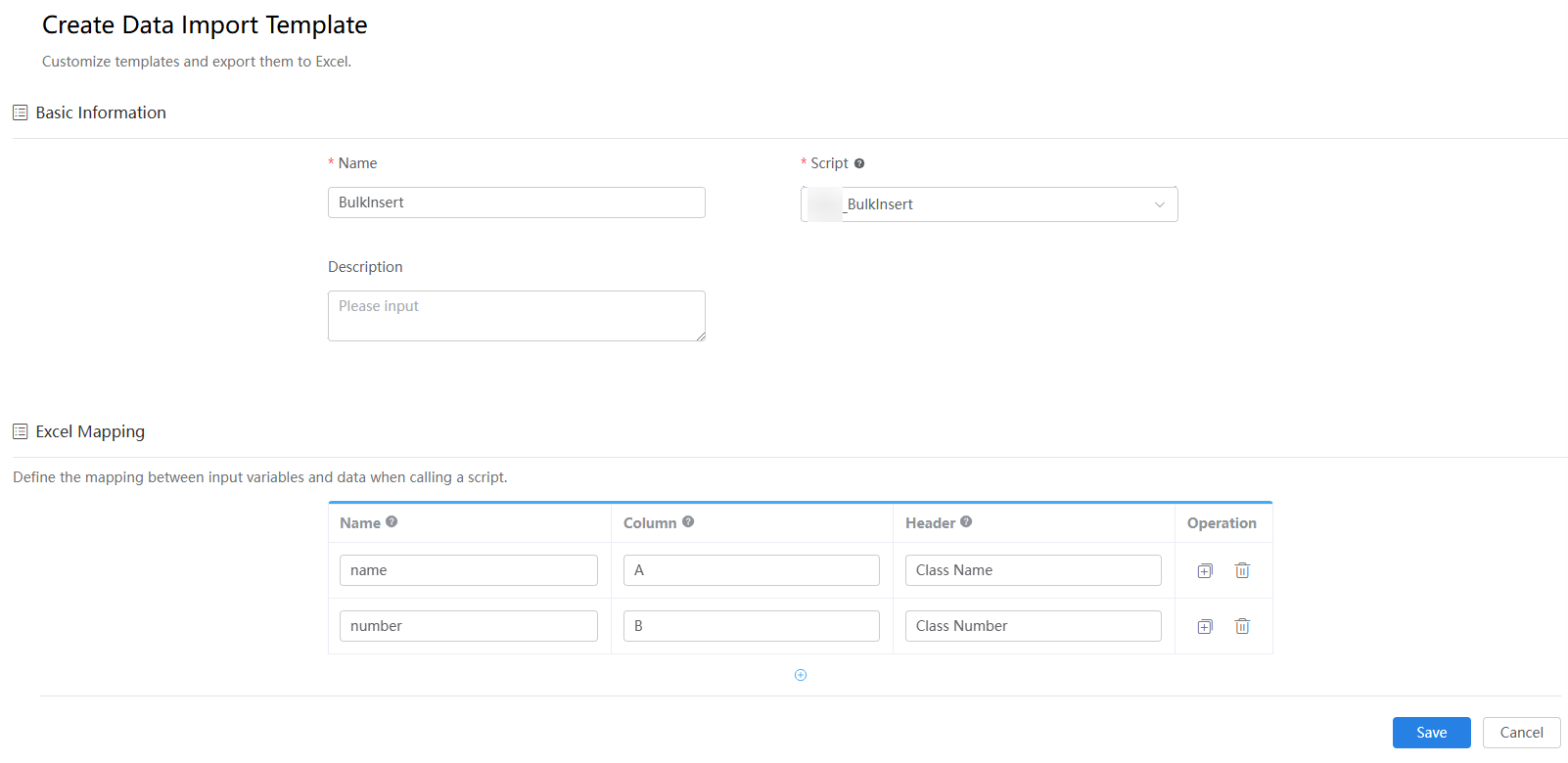

- Create a data import template.
- In the navigation pane, choose Application Maintenance > Data Import > Data Import Templates.
- On the data import template page, click Create.
- Configure parameters. If the script cannot be found, check whether the script is activated. Figure 2 Creating a template
Table 5 Parameters Area
Parameter
Description
Basic information
Name
Name of the data import template. The naming requirements are as follows:
- Value: 1–64 characters.
- Start with a letter and can contain only letters, digits, and underscores (_). Do not end with an underscore (_).
Script
Select the data processing script defined in 1.
Description
Description of the data import template.
Excel mapping
Name
Name of the input parameter variable output to the script. The value must be the same as the input parameter variable name in the script.
Column
Columns in the Excel template are defined in sequence, for example, A, B, and C.
Header
The column name in the first line of the Excel template.
Operation
Copy or delete the item.
- Click Save.

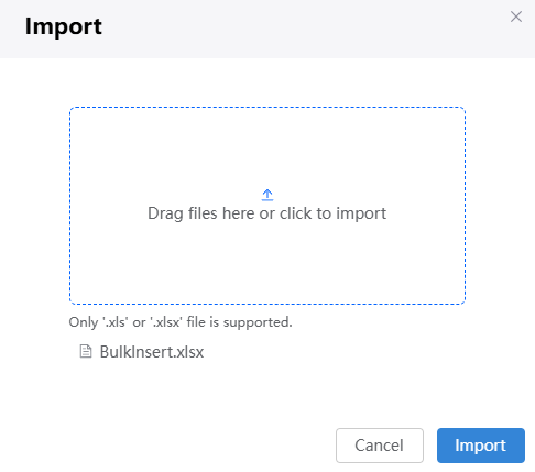

in the row where the template is located and download the template to a local directory. Then, fill data in the template and save it.Figure 3 Filling data
- Click
in the row where the template is located, drag the Excel file recorded in the previous step, and click the button for importing the modified data.Figure 4 Importing data
- In the displayed dialog box, click the confirm button.

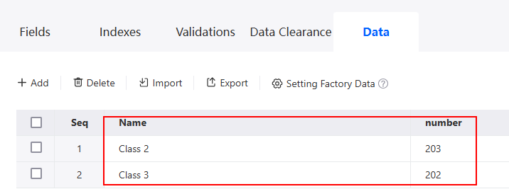

- Choose Application Maintenance > Data Import > Data Import. After the status of the import task changes to completed, view the import result on the data tab page of the object.Figure 5 Viewing the import result

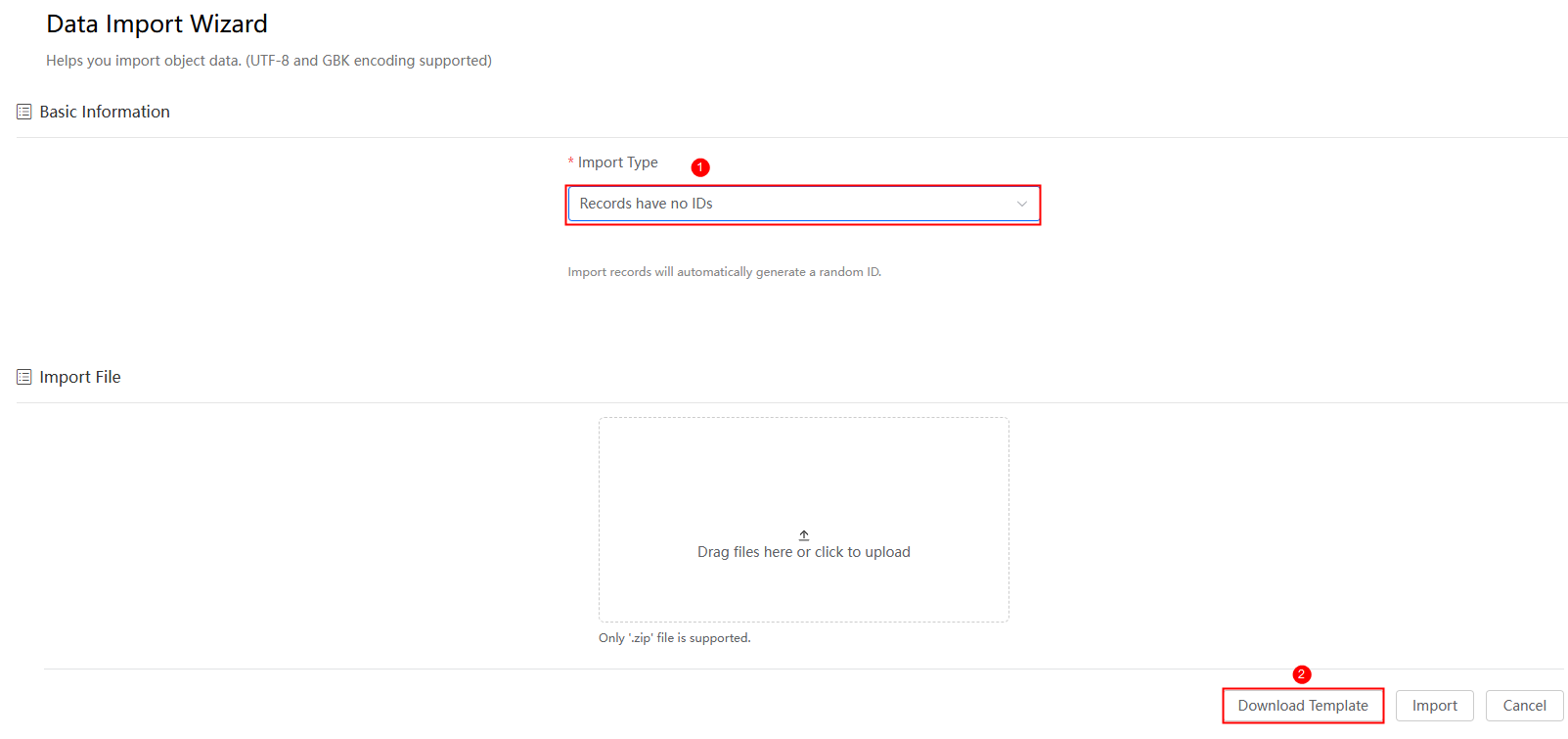

- Set Import Type to Records have no IDs, and click Download Template, as shown in Figure 6.

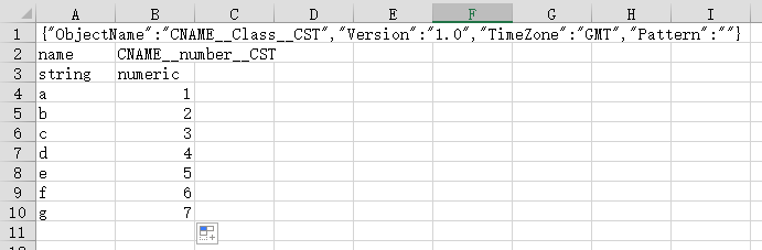

- On the page for download templates, specify Category and click Download to download the template to the local host.
- Decompress the ZIP package, and edit data using the obtained Excel file, as shown in Figure 7.
- Compress the edited data into a ZIP package and import the data. For details, see Importing Object Data.
