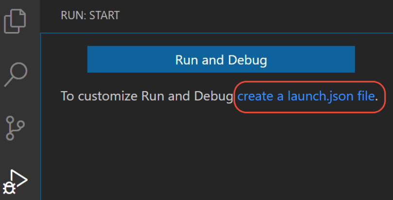

Step 1: Open launch.json.
  • Method 1: Click Run (Ctrl+Shift+D) in the menu bar on the left and click create a launch.json file.

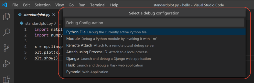

Step 2: Select a language.
To set a Python language, select Python File in Select a debug configuration. The operations for setting other languages are similar.
