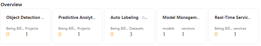

Log in to the ModelArts console. In the navigation pane, choose Overview. In the Overview area, view the jobs that are being billed. Then, stop the jobs as needed.
