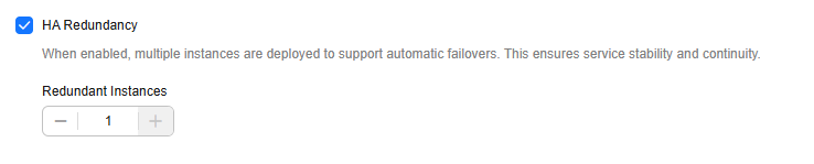

    • Method 1: Set when purchasing the resource pool.
      Figure 1 Setting when purchasing
      Parameters:
      • HA Redundancy: Whether to enable HA redundancy for the resource pool.
        After the function is enabled, the HA redundant node will be isolated, and workloads cannot be scheduled to the redundant node.
        An HA redundant node functions as the standby node for the fault detection function. This node will take over workloads if its active node becomes faulty.
      • Redundant Instances: number of HA redundant instances set for this flavor.
