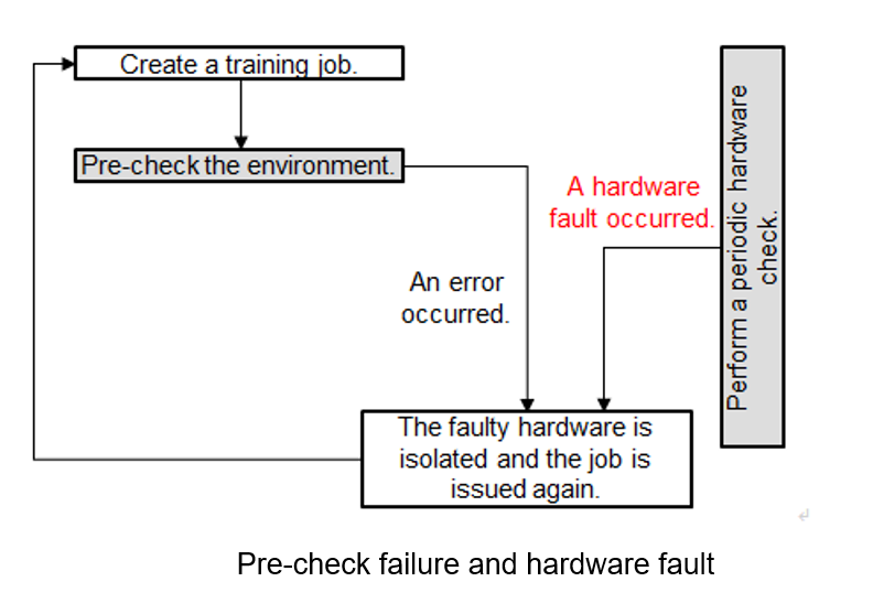

- Scenario 1: The environment pre-check fails, and the hardware is faulty. Then, ModelArts automatically isolates all faulty nodes and issues the training job again.
Figure 1 Pre-check failure and hardware fault

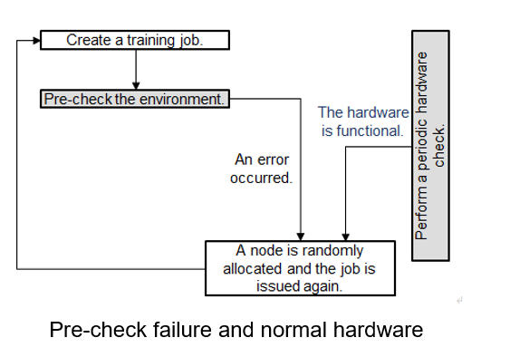

- Scenario 2: The environment pre-check fails but the hardware is functional. Then, ModelArts randomly allocates nodes and issues the training job again.
Figure 2 Pre-check failure but functional hardware

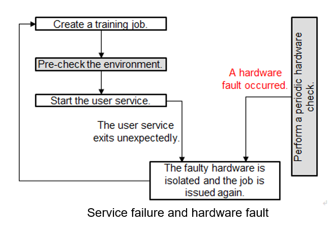

- Scenario 3: The environment pre-check is successful and the user service starts. A hardware fault occurs and the user service exits unexpectedly. Then, ModelArts automatically isolates all faulty nodes and issues the training job again.
Figure 3 Service failure and hardware fault

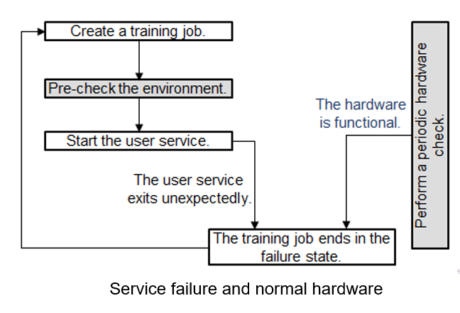

- Scenario 4: The environment pre-check is successful and the user service starts. The hardware is functional. A fault occurs in the user service, the training job ends in the failure state.
Figure 4 Service failure and functional hardware

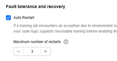

To enable fault tolerance check, enable auto restart when creating a training job.
- Configure fault tolerance check on the ModelArts Standard console:
Enable Auto Restart on the ModelArts management console. Auto Restart is disabled by default, indicating that the job will not be re-issued and the environment pre-check will not be enabled. After Auto Restart is enabled, the number of restart retries ranges from 1 to 128.
Figure 5 Auto Restart

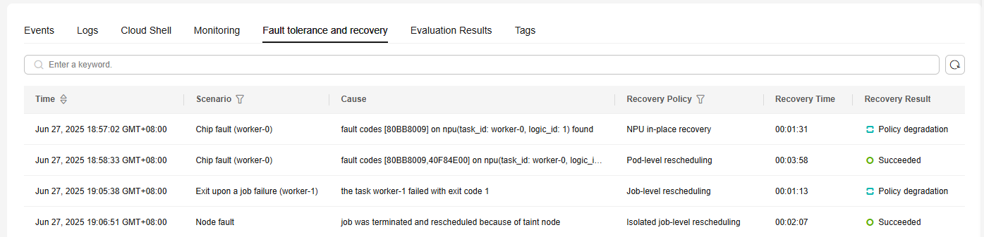

Checking Fault Tolerance and Recovery Details
When a training job fault occurs (such as in-place NPU recovery and job-level rescheduling), the Fault Recovery Details tab appears on the job details page, recording the start and stop details of the training job.
If you enable auto restart when creating a training job, you can view the number of restart times on the training job details page. Restarts displays the current number of restart times and the maximum number of restart times. In the Fault tolerance and recovery tab of the training job details page, you can view the restart details of the training job.
