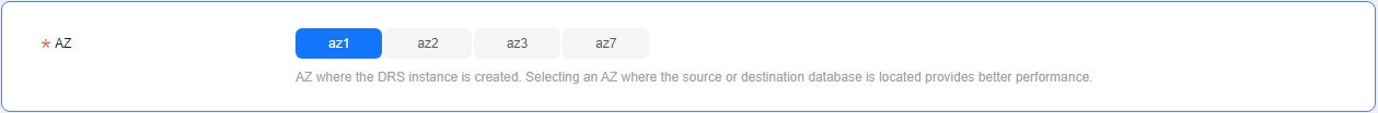

- AZ
Figure 3 AZ
Table 6 Task AZ Parameter
Description
AZ
Select the AZ where you want to create the DRS task. Selecting the one housing the source or destination database can provide better performance.

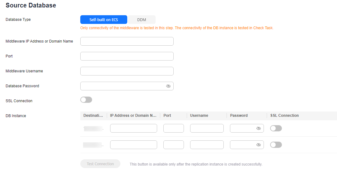

Figure 5 Service database information
Table 8 Service database settings Parameter
Description
Database Type
Select a service database type.
Middleware IP Address or Domain Name
The IP address or domain name of the DDM service middleware.
Port
The port of the DDM service middleware. Value range: 1 to 65535
Middleware Username
The username of the DDM service middleware.
Middleware Password
The password for the DDM service middleware username.
SSL Connection
SSL encrypts the connections between the source and destination databases. If SSL is enabled, upload the SSL CA root certificate.
NOTE:- The maximum size of a single certificate file that can be uploaded is 500 KB.
- If SSL is disabled, your data may be at risk.
DB Instance
Enter the database information based on the actual DN sharded database and data DR relationship of DDM.
For details, see How Do I Configure Source Database Information for a DDM DR Task?

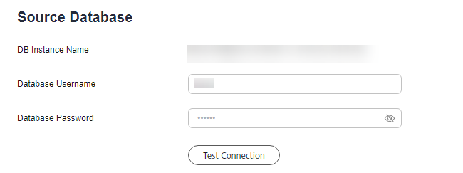

- Select Current cloud as active for Disaster Recovery Relationship in 2.
Figure 7 Service database information
Table 10 Service database settings Parameter
Description
DB Instance Name
The DDM instance you selected when you create the DR task. The instance name cannot be changed.
Database Username
The username for accessing the service database.
Database Password
The password for the database username. You can change the password if necessary. To change the password, perform the following operation after the task is created:
If the task is in the Starting, Initializing, Disaster recovery in progress, or Disaster recovery failed status, in the DR Information area on the Basic Information tab, click Modify Connection Details. In the displayed dialog box, change the password.
The database username and password are encrypted and stored in the system, and will be cleared after the task is deleted.

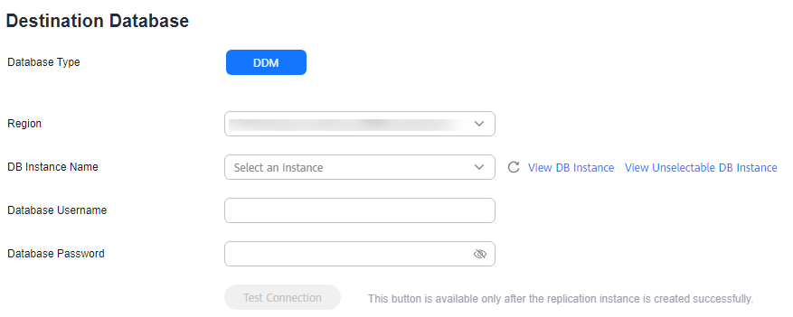

Figure 8 DR database information
Table 11 DR database settings Parameter
Description
Database Type
Type of the DR database.
Region
The region where the DDM DR instance is located.
DB Instance Name
Name of the DR instance.
NOTE:When the DB instance is used as the DR database, it is set to read-only. After the task is complete, the DB instance can be readable and writable.
Database Username
Username for logging in to the DR database.
Database Password
Password for the database username.
The username and password of the DR databases are encrypted and stored in DRS, and will be cleared after the task is deleted.
