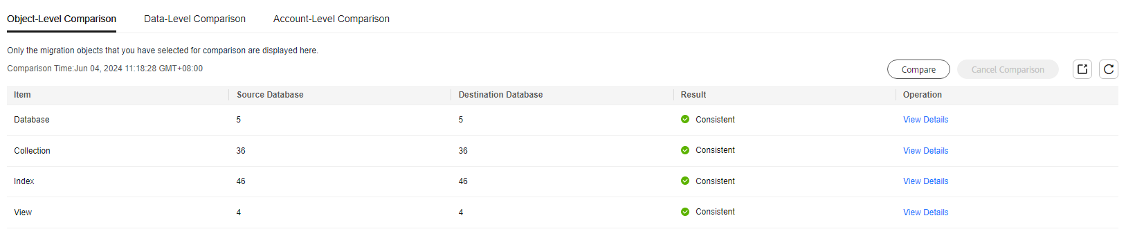

- Check the integrity of the database object. Click Validate Objects. On the Object-Level Comparison tab, click Compare. Wait for a while and click
, and view the comparison result of each comparison item. Figure 1 Comparing objects
Locate a comparison item you want to view and click View Details in the Operation column.

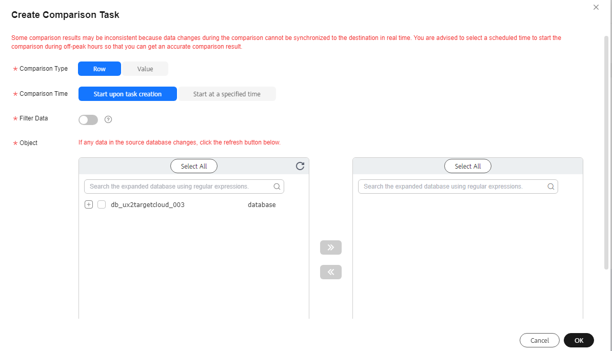

On the Data-Level Comparison tab, click Create Comparison Task. In the displayed dialog box, specify Comparison Method, Comparison Type, Comparison Time, and Object. Then, click OK.
Figure 2 Creating a comparison task
- Comparison Type: compares rows and values.
- After a task enters the incremental phase, you can create a row or value comparison task.
- After the full synchronization is complete, data in the source database cannot be changed. Otherwise, the comparison result will be inconsistent.
- After a task from Oracle to GaussDB Centralized or from Oracle to GaussDB Distributed enters the incremental verification phase, the comparison service starts to extract data from the incremental logs of the tables involved in the task for continuous comparison. If you want to compare the status of other tables, you can cancel the ongoing comparison task and create a comparison task.

- Comparison Time: You can select Start upon task creation or Start at a specified time. There is a slight difference in time between the source and destination databases during synchronization. Data inconsistency may occur. You are advised to compare migration items during off-peak hours for more accurate results.
- Flow Control: You can enable flow control for some comparison tasks. After flow control is enabled, you can set Effective to Always or Scheduled and set Flow Limit to a specific value. If you select Scheduled, you can set the time range based on your service requirements.
- Compare Incremental Data Only: You can enable incremental data comparison for some comparison tasks. This function is available only when you select Dynamic for Comparison Method. In addition, you can select a start time of incremental data.

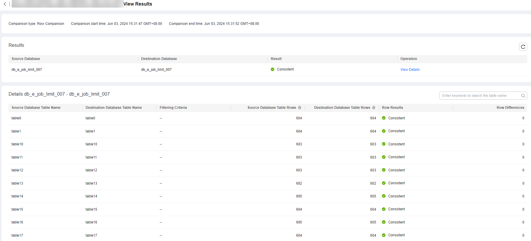

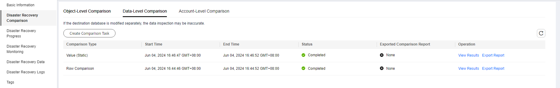

- After the comparison creation task is submitted, the Data-Level Comparison tab is displayed. Click
to refresh the list and view the comparison result of the specified comparison type. Figure 3 Viewing the data-level comparison result

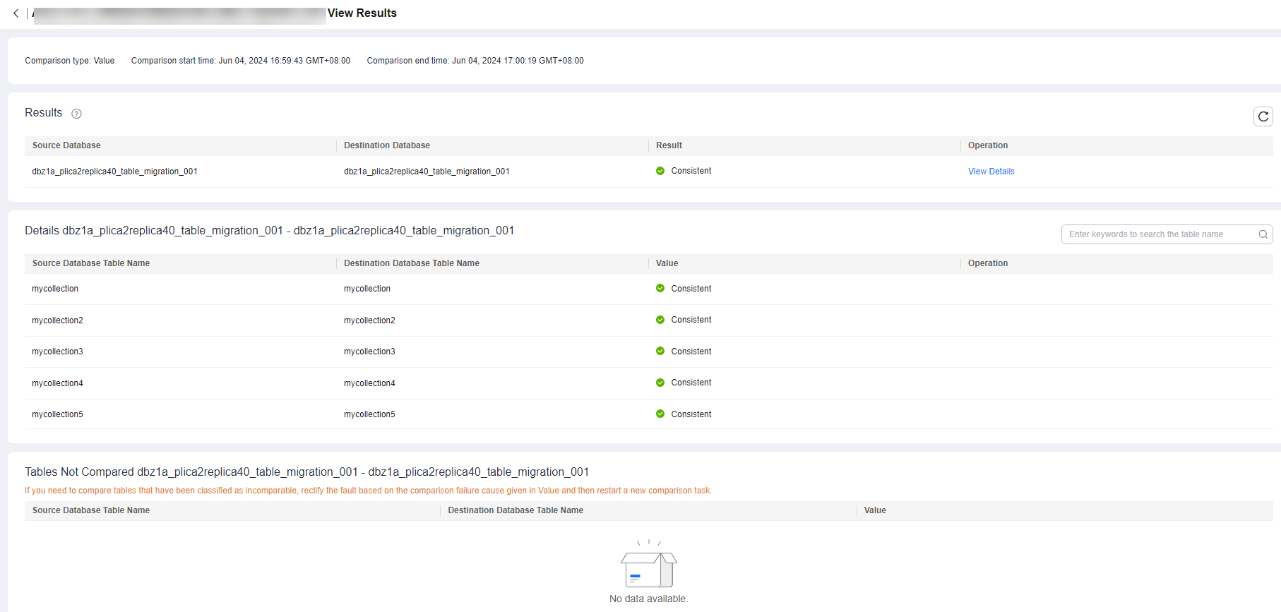

- To view the comparison details, locate the target comparison type and click View Results in the Operation column. On the displayed page, locate a pair of service and DR databases, and click View Details in the Operation column to view detailed comparison results. Figure 4 Row comparison details
Figure 5 Value comparison details
- For running comparison tasks with flow control enabled, you can check the source database extraction speed and incremental delay (available only for dynamic comparison) on the list page.
- Note: The statistics are refreshed every 10 seconds by default.
- For running comparison tasks with flow control enabled, you can click View Results to check the full comparison progress, full data extraction speed, number of inconsistent rows to be reviewed, and detailed progress of each source and destination database table. If the task is a dynamic comparison task, you can also check the incremental comparison delay, incremental comparison speed, incremental comparison position, number of inconsistent rows to be reviewed, and number of rows compared per second.
- You can also view comparison details of canceled comparison tasks.
- You can sort the row comparison results displayed on the current page in ascending or descending order based on the number of rows in the source database table or the destination database table.
- If a negative number is displayed in the differences column, the number of rows in the destination database table is greater than that in the source database table. If a positive number is displayed in the differences column, the number of rows in the source database table is greater than that in the destination database table.

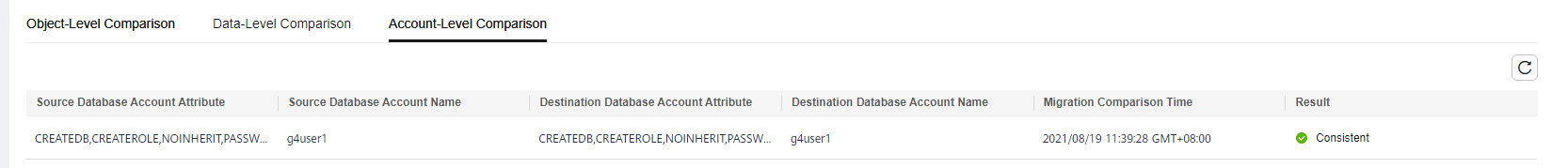

- Check the database accounts and permissions. Click the Account-Level Comparison tab to view the comparison results of database accounts and permissions. Figure 6 Account-level comparison
- Account comparison cannot be performed for tasks in the initialization phase.
