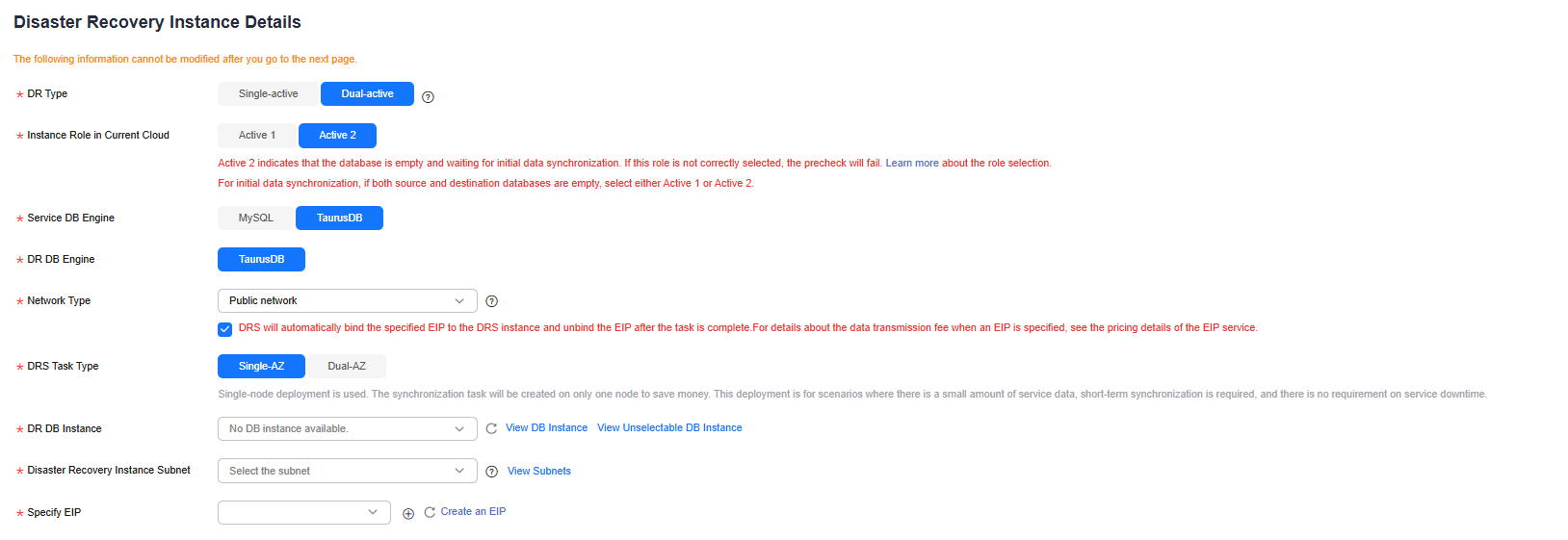

Figure 2 DR instance information
Table 5 DR instance settings Parameter
Description
DR Type
Select Dual-active.
The DR type can be single-active or dual-active. If Dual-active is selected, two subtasks are created by default, a forward DR task and a backward DR task.
NOTE:Only whitelisted users can use dual-active DR. To use this function, submit a service ticket. In the upper right corner of the management console, choose Service Tickets > Create Service Ticket to submit a service ticket.
Current Cloud RDS Instance Role
Select Active 1 or Active 2. This parameter specifies the role of the current RDS DB instance in the DR relationship and is available when DR Type is set to Dual-active. For details about how to choose active 1 and 2, see How Do I Select Active Database 1 and 2 for Dual-Active DR?
- Active 1: Initial data is available on the current cloud database when a task is created.
- Active 2: The instance on the current cloud is empty when a task is created.
Active 2 is used as an example.
Service DB Engine
Select GaussDB(for MySQL).
DR DB Engine
Network Type
The public network is used as an example.
Available options: VPN or Direct Connect and Public network. By default, the value is Public network.
DR DB Instance
The GaussDB(for MySQL) instance you created.
Disaster Recovery Instance Subnet
Select the subnet where the disaster recovery instance is located. You can also click View Subnets to go to the network console to view the subnet where the instance resides.
By default, the DRS instance and the DR DB instance are in the same subnet. You need to select the subnet where the DRS instance resides and ensure that there are available IP addresses. To ensure that the disaster recovery instance is successfully created, only subnets with DHCP enabled are displayed.
Specify EIP
This parameter is available when you select Public network for Network Type. Select an EIP to be bound to the DRS instance. DRS will automatically bind the specified EIP to the DRS instance and unbind the EIP after the task is complete. The number of specified EIPs must be the consistent with that of DB instances.
For details about the data transfer fee generated using a public network, see EIP Price Calculator.

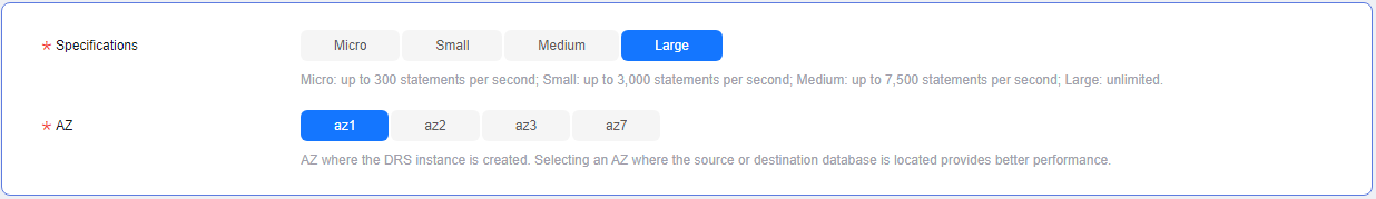

- Specifications
Figure 3 Specifications
Table 6 Specifications Parameter
Description
Specifications
DRS instance specifications. Different specifications have different performance upper limits. For details, see Real-Time DR.
NOTE:DRS allows you to upgrade specifications only for real-time DR tasks from MySQL to MySQL, from MySQL to GaussDB(for MySQL), and from GaussDB(for MySQL) to GaussDB(for MySQL). Task specifications cannot be downgraded. For details, see Changing Specifications.
AZ
Select the AZ where you want to create the DRS task. Selecting the one housing the source or destination database can provide better performance.

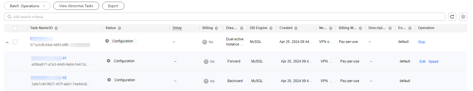

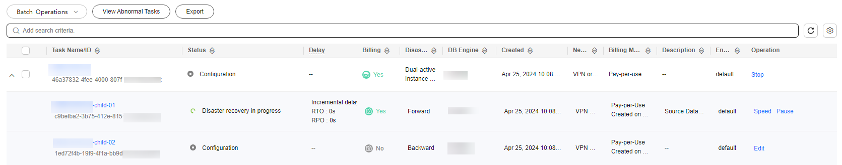

- On the Disaster Recovery Management page, after the task is created, locate the forward subtask and click Edit in the Operation column. The Configure Source and Destination Databases page is displayed.
Figure 5 DR task list

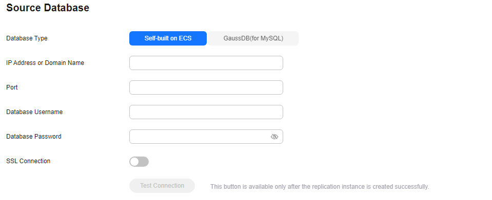

Figure 6 Service database information
Table 8 Service database settings Parameter
Description
Database Type
By default, Self-built on ECS is selected.
The source database can be a Self-built on ECS or an RDS DB instance. After selecting RDS DB instance, select the region where the source database resides and the region cannot be the same as the region where the destination database resides. The region where the destination database is located is the region where you log in to the management console. To use the RDS DB instance option, submit a service ticket.
IP Address or Domain Name
The IP address or domain name of the service database.
Port
The port of the service database. Range: 1 – 65535
Database Username
The username for accessing the service database.
Database Password
The password for the service database username. You can change the password if necessary. To change the password, perform the following operation after the task is created:
If the task is in the Starting, Initializing, Disaster recovery in progress, or Disaster recovery failed status, in the Connection Information area on the Basic Information tab, click Modify Connection Details. In the displayed dialog box, change the password.
SSL Connection
SSL encrypts the connections between the source and destination databases. If SSL is enabled, upload the SSL CA root certificate.
NOTE:- The maximum size of a single certificate file that can be uploaded is 500 KB.
- If SSL is disabled, your data may be at risk.
Region
The region where the service DB instance is located. This parameter is selected by default. This parameter is available only when the source database is an RDS DB instance.
DB Instance Name
The name of the service DB instance. This parameter is available only when the source database is an RDS DB instance.
Database Username
Database Password
The IP address, domain name, username, and password of the service database are encrypted and stored in DRS and will be cleared after the task is deleted.

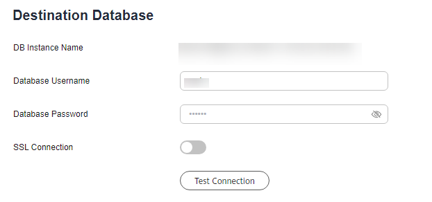

Figure 7 DR database informationTable 9 DR database settings Parameter
Description
DB Instance Name
The GaussDB(for MySQL) instance you selected when creating the DR task. This parameter cannot be changed.
Database Username
The username for accessing the DR database.
Database Password
The password for the database username. The password can be changed after a task is created.
The database username and password are encrypted and stored in DRS, and will be cleared after the task is deleted.

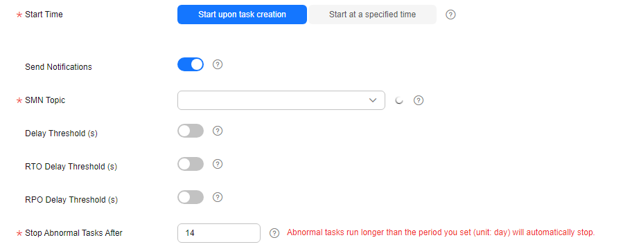

- On the displayed page, specify Start Time, Send Notification, SMN Topic, Synchronization Delay Threshold, RPO Synchronization Delay Threshold, RTO Synchronization Delay Threshold, and Stop Abnormal Tasks After for the forward subtask. After confirming that the configured information is correct, click Submit to submit the forward DR task.
Figure 10 Task startup settings
Table 11 Task and recipient description Parameter
Description
Start Time
Set Start Time to Start upon task creation or Start at a specified time based on site requirements.
NOTE:After a DR task is started, the performance of the service and DR databases may be affected. You are advised to start a DR task during off-peak hours.
Send Notifications
SMN topic. This parameter is optional. If the status or latency metric of the disaster recovery task is abnormal, DRS will send a notification.
SMN Topic
This parameter is available only after you enable Send Notifications and create a topic on the SMN console and add a subscriber.
For details, see Simple Message Notification User Guide.
During disaster recovery, a synchronization delay indicates a time difference (in seconds) of synchronization between the service and DR database.
If the synchronization delay exceeds the threshold you specify, DRS will send alarms to the specified recipients. The value ranges from 0 to 3,600. To avoid repeated alarms caused by the fluctuation of delay, an alarm is sent only after the delay has exceeded the threshold for six minutes.
NOTE:- Before setting the delay threshold, enable Send Notification.
- If the delay threshold is set to 0, no notifications will be sent to the recipient.
If the synchronization delay from the DRS instance to the DR database exceeds the threshold you specify, DRS will notify specified recipients. The value ranges from 0 to 3,600. To avoid repeated alarms caused by the fluctuation of delay, an alarm is sent only after the delay has exceeded the threshold for six minutes.
NOTE:- Before setting the RTO delay threshold, enable Send Notification.
If the synchronization delay from the DRS instance to the service database exceeds the threshold you specify, DRS will notify specified recipients. The value ranges from 0 to 3,600. To avoid repeated alarms caused by the fluctuation of delay, an alarm is sent only after the delay has exceeded the threshold for six minutes.
- In the early stages of an incremental disaster recovery, the synchronization delay is long because a large quantity of data is awaiting synchronization. In this case, no notifications will be sent.
Number of days after which an abnormal task is automatically stopped. The value must range from 14 to 100. The default value is 14.
NOTE:- You can set this parameter only for pay-per-use tasks.
- Tasks in the abnormal state are still charged. If tasks remain in the abnormal state for a long time, they cannot be resumed. Abnormal tasks run longer than the period you set (unit: day) will automatically stop to avoid unnecessary fees.
- Return to the Disaster Recovery Management page. After the forward subtask enters the Disaster recovery in progress state, locate the backward subtask and click Edit in the Operation column. The Configure Source and Destination Databases page of the backward subtask is displayed.
Figure 11 DR task list
- On the Configure Source and Destination Databases page, click Test Connection for both the source and destination databases to check whether they have been connected to the DR instance. After the connection tests are successful, click Next.
- On the displayed page, specify Start Time, Send Notification, SMN Topic, Synchronization Delay Threshold, RPO Synchronization Delay Threshold, RTO Synchronization Delay Threshold, and Stop Abnormal Tasks After for the backward subtask. After confirming that the configured information is correct, click Submit to submit the backward DR task.
- After the task is submitted, view and manage it on the Disaster Recovery Management page.
- You can view the task status. For more information about task status, see Task Statuses.
- You can click
in the upper-right corner to view the latest task status.
- By default, DRS retains a task in the Configuration state for three days. After three days, DRS automatically deletes background resources, but the task status remains unchanged. When you reconfigure the task, DRS applies for resources again.
