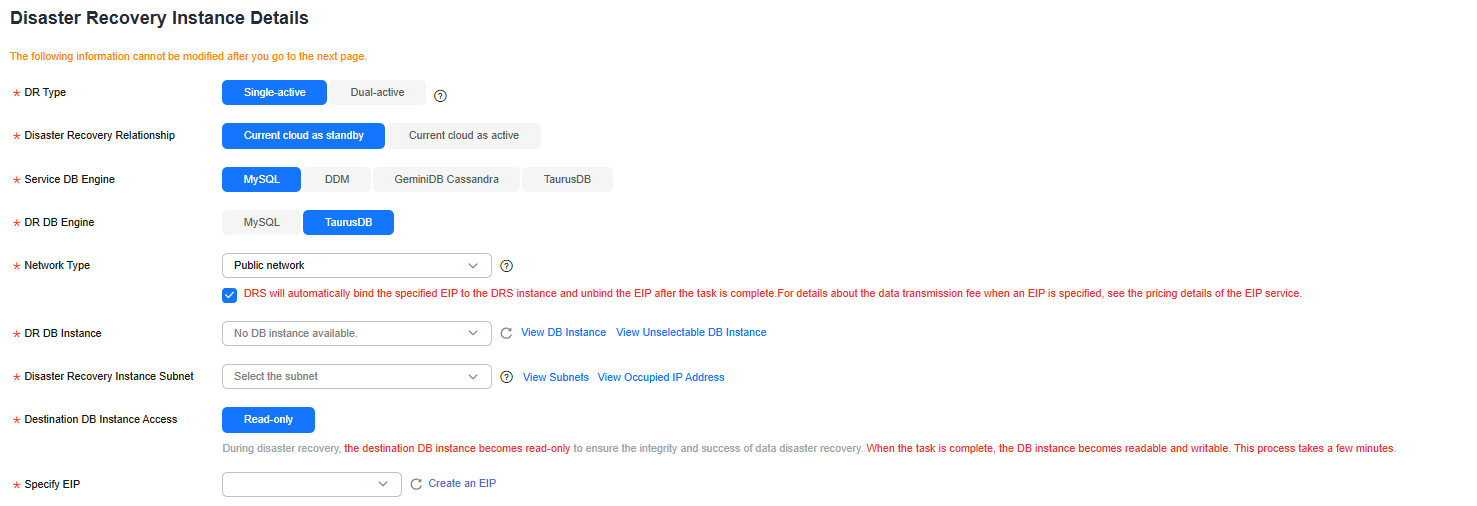

    • DR instance information
      Figure 2 DR instance information
      Table 5 DR instance settings
      Parameter
      Description
      DR Type
      Select Single-active.
      The DR type can be single-active or dual-active. If Dual-active is selected, two subtasks are created by default, a forward DR task and a backward DR task.
      NOTE:
      The Dual-active option is in restricted use. To use this function, submit a service ticket.
      Disaster Recovery Relationship
      Select Current cloud as standby. This parameter is available only when you select Single-active.
      By default, Current cloud as standby is selected. You can also select Current cloud as active.
      • Current cloud as standby: The DR database is on the current cloud.
      • Current cloud as active: The service database is on the current cloud.
      Service DB Engine
      Select MySQL.
      DR DB Engine
      Select TaurusDB.
      Network Type
      The public network is used as an example.
      Available options: VPN or Direct Connect and Public network. By default, the value is Public network.
      DR DB Instance
      TaurusDB instance you have created as the destination database of the DR task.
      Disaster Recovery Instance Subnet
      Select the subnet where the disaster recovery instance is located. You can also click View Subnets to go to the network console to view the subnet where the instance resides.
      By default, the DRS instance and the DR DB instance are in the same subnet. You need to select the subnet where the DRS instance resides and ensure that there are available IP addresses. To ensure that the disaster recovery instance is successfully created, only subnets with DHCP enabled are displayed.
      Destination DB Instance Access
      Select Read-only. This parameter is available only when you select Single-active.
      • During disaster recovery, the entire DR database instance becomes read-only. To change the DR database to Read/Write, you can change the DR database (or destination database) to a service database by clicking Promote Current Cloud on the Disaster Recovery Monitoring tab.
      • If a DR task fails, the DR database does not automatically change to the read/write state.
      • If a DR task is paused, you can disable read-only for the DR database. For details, see Disabling or Enabling Read-Only.
      • After read-only is disabled and the DR task is resumed, the DR database automatically changes to read-only. The read-only settings of the DR DB instance are also affected by the access settings of the DB instance itself. Therefore, you are advised not to set the access settings of the DB instance on the RDS console.
      • After the DR task is complete, the DR database changes to Read/Write.
      • When the external database functions as the DR database, the user with the superuser permission can set the database to read-only.
      • If a DRS instance node is rebuilt due to a fault, to ensure data consistency during the DRS task restoration, the current cloud standby database is set to read-only before the task is restored. After the task is restored, the synchronization relationship recovers.
      Specify EIP
      This parameter is available when you select Public network for Network Type. Select an EIP to be bound to the DRS instance. DRS will automatically bind the specified EIP to the DRS instance and unbind the EIP after the task is complete. The number of specified EIPs must be the consistent with that of DB instances.
      For details about the data transfer fee generated using a public network, see EIP Price Calculator.

      NOTE:
      DRS allows you to upgrade specifications only for real-time DR tasks from MySQL to MySQL, from MySQL to TaurusDB, and from TaurusDB to TaurusDB. Task specifications cannot be downgraded. For details, see Changing Specifications.
      AZ
      Select the AZ where you want to create the DRS task. Selecting the one housing the source or destination database can provide better performance.

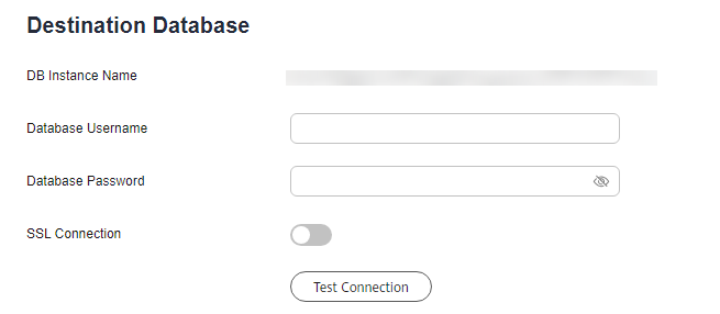

    Figure 6 DR database information
    Table 9 DR database settings
    Parameter
    Description
    DB Instance Name
    The TaurusDB instance you selected when creating the DR task. This parameter cannot be changed.
    Database Username
    The username for accessing the DR database.
    Database Password
    The password for the database username. The password can be changed after a task is created.
    If the task is in the Starting, Initializing, Disaster recovery in progress, or Disaster recovery failed status, in the Connection Information area on the Basic Information tab, click Modify Connection Details. In the displayed dialog box, change the password.
    The database username and password are encrypted and stored in DRS, and will be cleared after the task is deleted.
