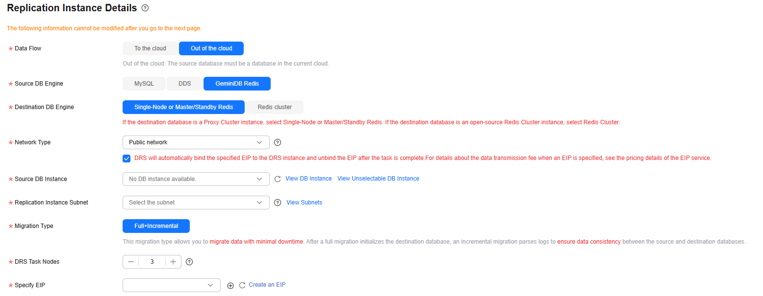

    • Replication instance information
      Figure 2 Replication instance information
      Table 5 Replication instance settings
      Parameter
      Description
      Data Flow
      Select Out of the cloud.
      The source database is a database on the current cloud.
      Source DB Engine
      Select GeminiDB Redis.
      Destination DB Engine
      Select Single-Node or Master/Standby Redis.
      Network Type
      Available options: VPC, VPN or Direct Connect, and Public network. VPN or Direct Connect is selected in this example.
      • VPC is suitable for migrations between cloud databases of the same account in the same region and VPC.
      • Public network is suitable for migrations from on-premises databases or external cloud databases to destination databases.
      • VPN or Direct Connect is suitable for migrations from on-premises databases to cloud databases or between databases across regions on the cloud using a VPN, Direct Connect, Cloud Connect, VPCEP, or a VPC peering connection.
      Source DB Instance
      Select the source GeminiDB Redis instance you have created.
      Replication Instance Subnet
      The subnet where the replication instance resides. You can also click View Subnets to go to the network console to view the subnet where the instance resides.
      By default, the DRS instance and the destination DB instance are in the same subnet. You need to select the subnet where the DRS instance resides, and there are available IP addresses for the subnet. To ensure that the replication instance is successfully created, only subnets with DHCP enabled are displayed.
      Migration Type
      • Full+Incremental: This migration type allows you to migrate data without interrupting services. After a full migration initializes the destination database, an incremental migration initiates and parses logs to ensure data consistency between the source and destination databases.
        NOTE:
        If you select Full+Incremental, data generated during the full migration will be continuously synchronized to the destination database, and the source remains accessible.
      DRS Task Nodes
      Specifies the number of nodes to be migrated using DRS. One DRS task node connects to two to three shards on the source database. If the source GeminiDB Redis database is a primary/standby instance, the number of DRS task nodes can only be 1.
      Specify EIP
      This parameter is available when you select Public network for Network Type. Select an EIP to be bound to the DRS instance. DRS will automatically bind the specified EIP to the DRS instance and unbind the EIP after the task is complete. The number of specified EIPs must be the consistent with that of DB instances.
      For details about the data transfer fee generated using a public network, see EIP Price Calculator.

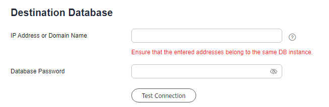

    • Destination database configuration
      Figure 7 Destination database information
      Table 10 Destination database settings
      Parameter
      Description
      IP Address or Domain Name
      IP address or domain name of the destination database in the IP address/Domain name:Port format. The port of the destination database. Range: 1 - 65535
      • If a single-node or proxy instance is used, ensure that the entered IP addresses or domain names belong to the same instance. If a proxy cluster instance is used, enter the ELB address.
      • If the destination is master/standby Redis 5.0, enter all IP addresses and ports of the master, slave, and sentinel nodes for the destination database connection testing. The passwords of the master, slave, and sentinel nodes must be the same.
      • If the destination is master/standby Redis 4.0 and the requirepass parameter (a password) is set on the master and slave nodes, DRS regards the master/standby Redis as a single-node Redis. The master/standby switchover of the destination database is not supported. For the destination database connection testing, enter only the IP address and port of the master node.
      • If the destination is master/standby Redis 4.0 and the requirepass parameter (a password) is not set on the master or slave node, the master/standby switchover of the destination database is supported. For the destination database connection testing, enter all IP addresses and ports of the master, slave, and sentinel nodes.
      Database Password
      Password for logging in to the destination database
      The password of the destination database is encrypted and stored in the database and the replication instance during the migration. After the task is deleted, the password is permanently deleted.
