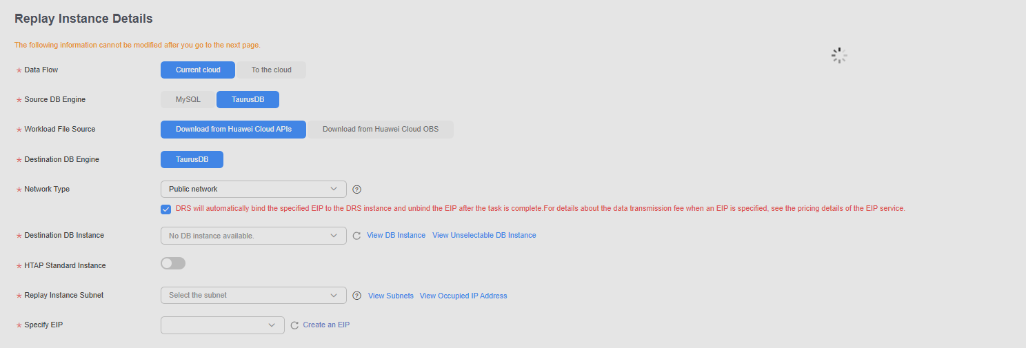

- Replay instance information Figure 2 Replay instance information
Table 4 Replay instance settings Parameter
Description
Data Flow
Select Current cloud.
- Current cloud refers to the workload replay scenario where both source and destination databases are Huawei Cloud DB instances.
- To the cloud refers to the workload replay scenario where the destination database is a Huawei Cloud DB instance and data needs to be transferred.
Source DB Engine
Select TaurusDB.
Workload File Source
Specifies where the workload file in the source database is from.
- Download from Huawei Cloud APIs: Obtain audit log files through the API corresponding to Huawei Cloud services.
- Download from Huawei Cloud OBS: Obtain workload files from Huawei Cloud OBS buckets.
Destination DB Engine
Select TaurusDB.
Network Type
Public network is used as an example.
Available options: Public network, VPC, VPN or Direct Connect
Destination DB Instance
The TaurusDB DB instance you created. Ensure that baseline data has been developed in the destination database.
Replay Instance Subnet
Select the subnet where the replay instance is located. You can also click View Subnets to go to the network console to view the subnet where the instance resides.
By default, the DRS instance and the destination DB instance are in the same subnet. You need to select the subnet where the DRS instance resides, and there are available IP addresses for the subnet. To ensure that the replay instance can be successfully created, only subnets with DHCP enabled are displayed.
Specify EIP
This parameter is available when you select Public network for Network Type. Select an EIP to be bound to the DRS instance. DRS will automatically bind the specified EIP to the DRS instance and unbind the EIP after the task is complete.
For details about the data transfer fee generated using a public network, see EIP Price Calculator.

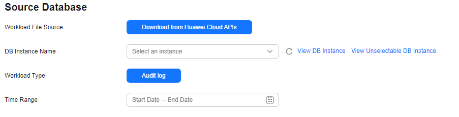

- Source database information when Download from Huawei Cloud APIs is selected for Workload File Source Figure 5 Source database information
Table 7 Source database settings Parameter
Description
DB Instance Name
Select a TaurusDB instance for which SQL Explorer has been enabled. For details about how to enable SQL Explorer, see Configuring SQL Explorer for a DB Instance.
Workload Type
Only SQL Explorer is supported.
Time Range
Select the time range for audit logs.

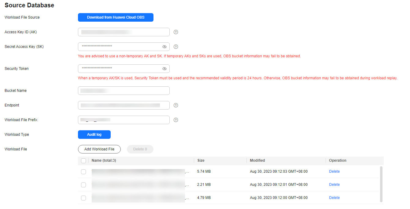

- Source database information when Download from Huawei Cloud OBS is selected for Workload File Source Figure 6 Source database information
Table 8 Source database settings Parameter
Description
Access Key ID (AK)
Access key ID, which is a unique identifier used in conjunction with a secret access key to sign requests cryptographically.
Secret Access Key (SK)
Used together with the access key ID to sign requests cryptographically. It identifies a request sender and prevents the request from being modified.
- Based on the principle of least permission, the AK/SK permissions must be minimized. If you can use both temporary and permanent AKs/SKs, you are advised to use a temporary AK/SK. Permanent AKs/SKs are used only in scenarios where temporary AKs/SKs cannot meet requirements. For example, if a large number of logs need to be downloaded for a long time, temporary AKs/SKs may become invalid due to timeout.
- AK/SK information of the user is encrypted and temporarily stored in the system until the task is deleted.
Security Token
When a temporary AK/SK is used, Security Token must be used, and the recommended validity period is 24 hours. Otherwise, OBS bucket information may fail to be obtained during workload replay.
Bucket Name
Name of the OBS bucket for storing workload files.
Endpoint
OBS provides an endpoint for each region. An endpoint can be considered as the domain name of OBS in a region, and is used to process access requests from the region.
Workload File Prefix
Prefix of a file name in the OBS bucket. Only files whose names start with this prefix will be displayed.
Workload Type
Only Audit log is supported.
Workload File
Select the required workload file.
