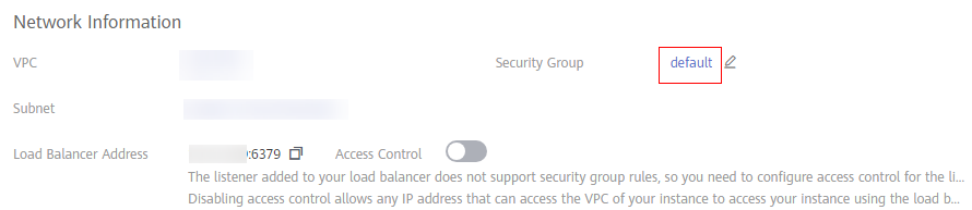

- Click the instance name to go to the Basic Information page.
- In the Network Information area, click the value of the Security Group parameter.
Figure 1 Network information

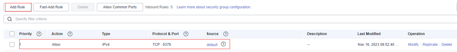

- Click the Inbound Rules tab and click Add Rule. Then, specify parameters as shown in the following figure.
Figure 2 Inbound rules
You can also specify parameters by referring to Configuring Security Group Rules.
