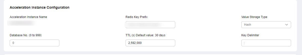

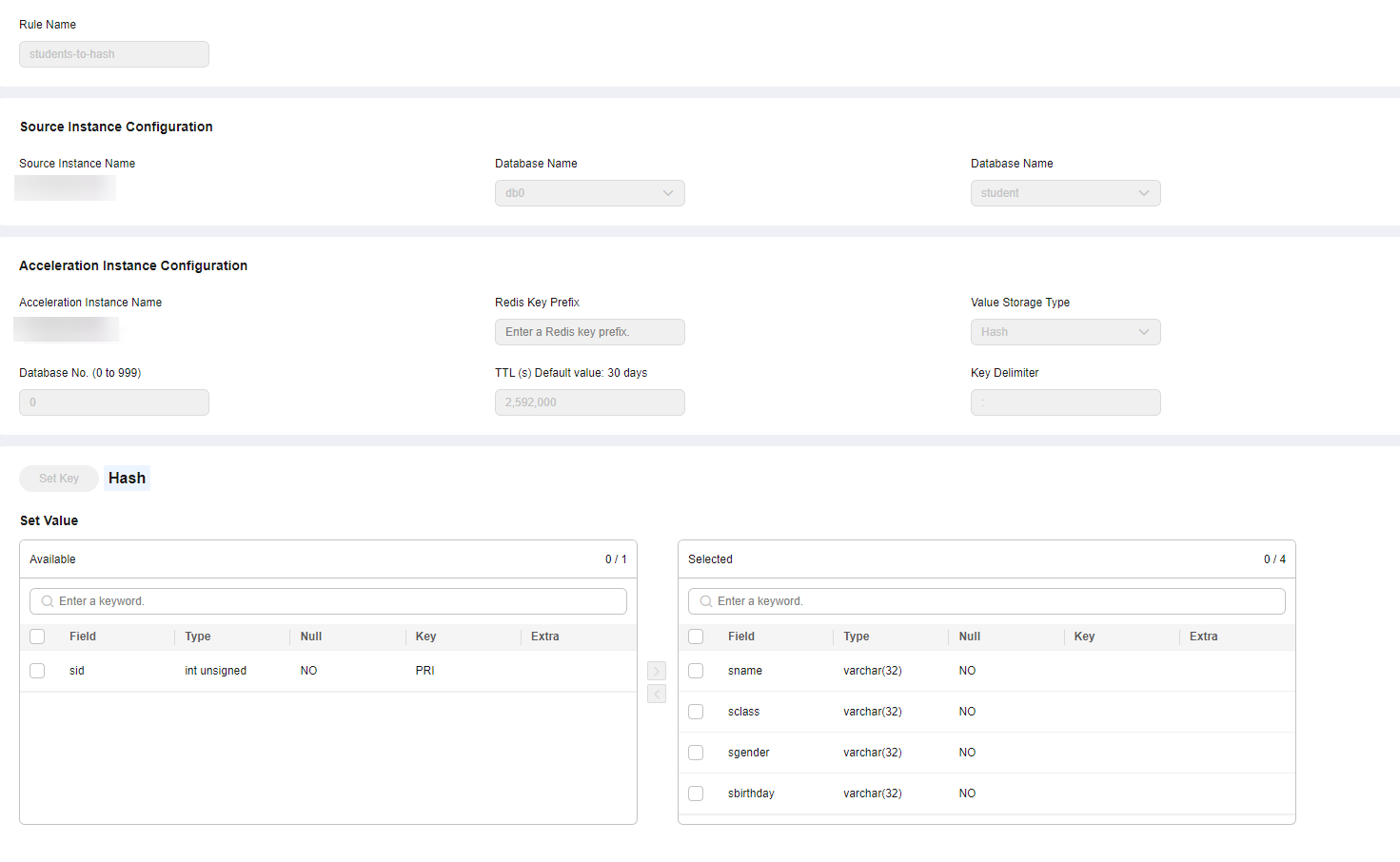

- A Redis key prefix and a delimiter in a new rule can neither include those nor be included in those specified for an existing rule. For example, if the key prefix in a new rule is pre1: and is separated by a comma (,) and the key prefix in an existing rule is pre1 and is separated by a colon (:), the new rule cannot be created.

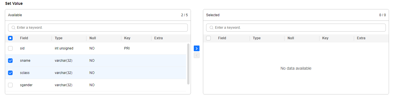

- Currently, the ENUM, SET, and JSON data cannot be synchronized.

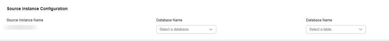

- Currently, only single-table queries are supported during lightweight incremental synchronization. Joint queries are not supported.

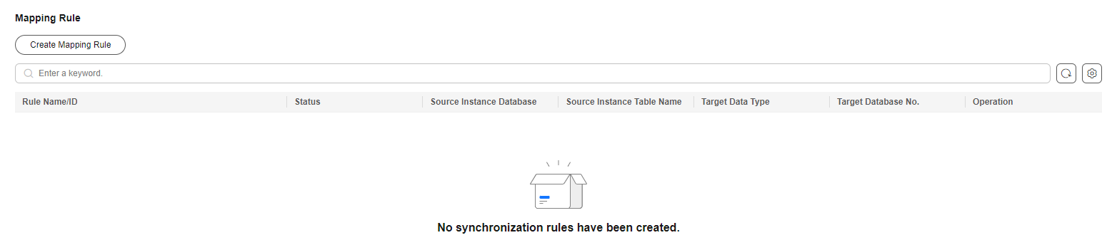

- When you purchase a TaurusDB instance, if you select Buy Now for memory acceleration, a GeminiDB instance is automatically provisioned with DB Cache enabled. You can skip instance creation and start from Creating a Mapping Rule.
Procedure
