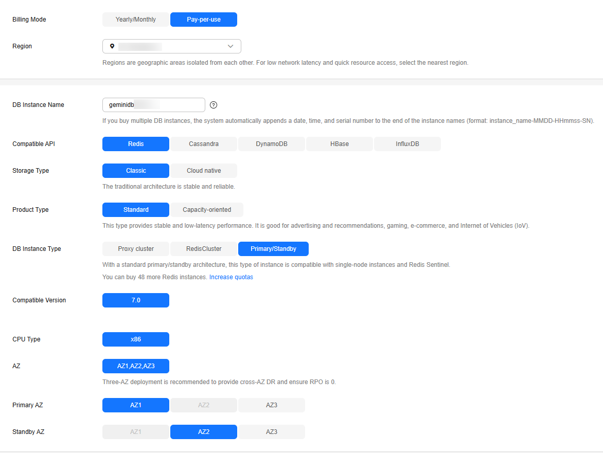

  3. On the displayed page, select a billing mode, configure instance specifications, and click Next.
The following parameters are for reference only. Select proper specifications as needed. Table 1 lists details about the parameters.
Figure 1 Billing mode and basic information
Parameter
Example Value
Description
Billing mode description
Pay-per-use
Billing mode of an instance
  • Yearly/Monthly: A prepaid billing mode in which you pay for resources before using it. Bills are settled based on the subscription period. The longer the subscription term, the bigger the discount. This mode is a good option for long-term stable services.
  • Pay-per-use is a postpaid mode. You are billed based on how long you have actually used GeminiDB. Pricing is listed on a per-hour basis, and bills are calculated down to the second. This mode allows you to adjust resource usage easily. You neither need to prepare for resources in advance, nor end up with excessive or insufficient preset resources.
Region
Select CN-Hong Kong.
Region where a tenant is located
NOTE:
To reduce network latency, select a region nearest from which you will access the instance. Instances deployed in different regions cannot communicate with each other over a private network. After you buy an instance, you cannot change its region.
DB Instance Name
User-defined
The instance name:
  • Can be the same as an existing instance name.
  • Can contain 4 to 64 characters and must start with a letter. It is case-sensitive and allows only letters, digits, hyphens (-), and underscores (_).
Compatible API
Redis
GeminiDB is compatible with mainstream NoSQL databases, including Redis, DynamoDB, Cassandra, HBase, InfluxDB, and MongoDB. You can select GeminiDB APIs by following How Do I Select an API?
Storage Type
Classic
  • Classic: classic architecture with decoupled storage and compute
Product Type
Standard
  • Standard: Stable and low-latency performance is provided for common scenarios such as advertising and recommendation, gaming, e-commerce, and Internet of Vehicles (IoV).
  • Capacity-oriented: Large-capacity key-value storage is suitable for average performance requirements and expectations of low costs.
DB Instance Type
Primary/Standby
Primary/Standby
A primary/standby instance is compatible with a standalone Redis node and Redis Sentinel. This instance type is used when hash tags are unavailable.
Compatible Version
7.0
7.0, 6.2 (including 6.2.X), 5.0, and earlier versions
CPU Type
x86
x86 CPUs use the Complex Instruction Set Computing (CISC) instruction set. Each instruction can be used to execute low-level hardware operations. Executing these instructions is complex and time-consuming.
AZ
AZ 1, AZ 2, and AZ 3
Availability zone where the instance is created. An AZ is a part of a region with its own independent power supplies and networks. AZs are physically isolated but can communicate with each other over a private network. If there are multiple AZs, you need to select primary and standby AZs.
Instances can be deployed in a single AZ or three AZs.
  • If low network latency is required, deploy your instance in one AZ.
  • To meet disaster recovery requirements, select three AZs and specify primary and standby AZs.
    • Primary AZ: AZ where a primary node is located
    • Standby AZ: AZ where a standby node is located

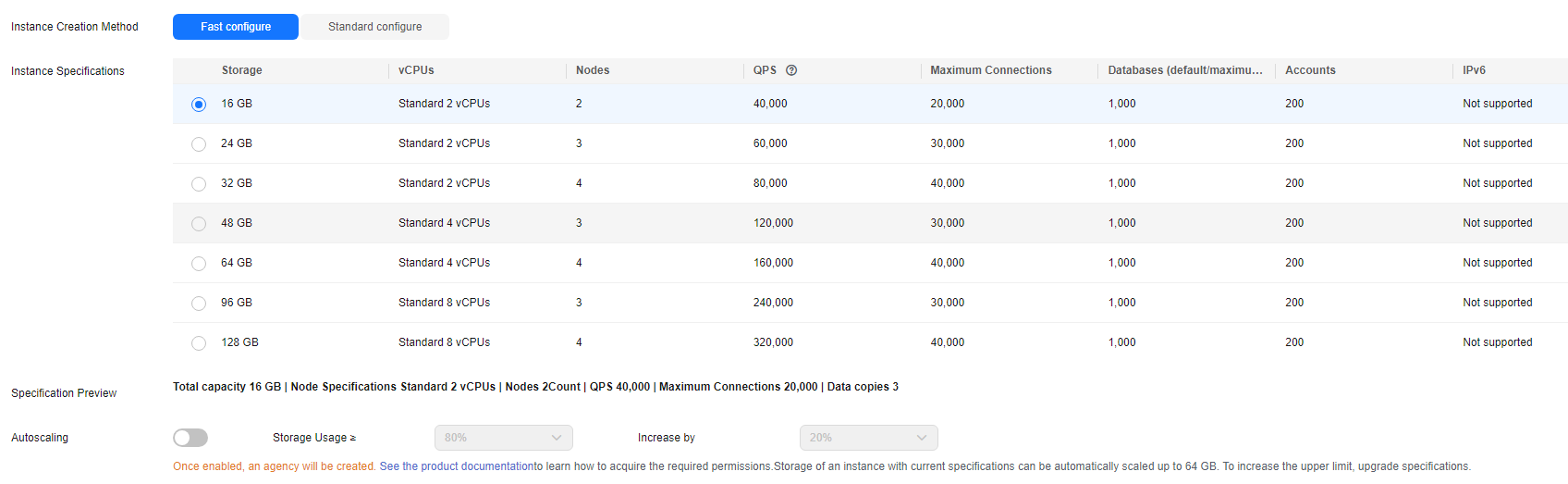

Instance Creation Method
Fast configure
Two options are available:
  • Fast configure
    Provides you with recommended specifications. You can select one of them based on service requirements, without the need to specify the specifications, node quantity, and storage space.
  • Standard configure
    Provides a standard process to configure instance specifications, including specifying the specifications, node quantity, and storage space.
Instance Specifications
2U8GB
Higher CPU specifications provide better performance. Select specifications as needed.
For details, see Instance Specifications.

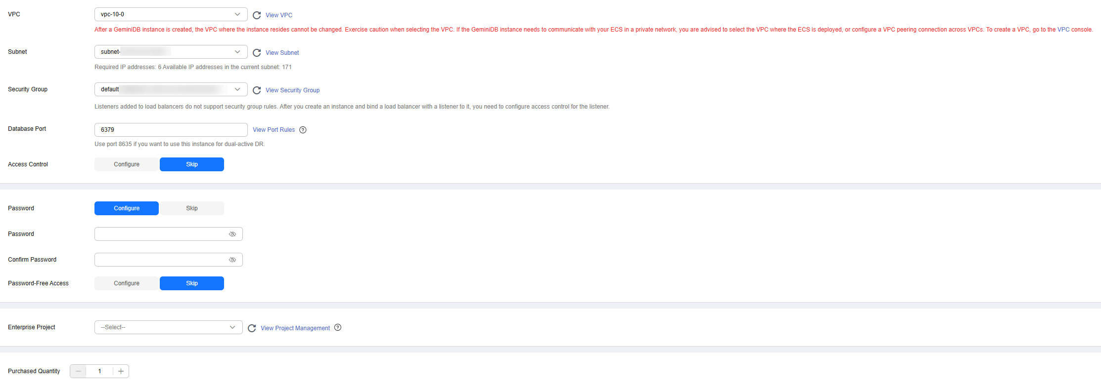

VPC
default_vpc
Virtual private network where your instances are located. A VPC isolates networks for different services. You can select an existing VPC or create a VPC.
NOTE:
  • After a GeminiDB Redis instance is created, its VPC cannot be changed.
  • If you want to connect to a GeminiDB Redis instance through an ECS over an internal network, the GeminiDB Redis instance and the ECS must be in the same VPC. If they are not in the same VPC, you can create a VPC peering connection to enable access.
Subnet
default_subnet
A subnet provides dedicated network resources that are logically isolated from other networks for security purposes.
Database Port
6379
Port number for accessing a database. If you do not specify a port number, default port 6379 is used. You can specify a port number based on your requirements. The port number ranges from 1024 to 65535 except 2180, 2887, 3887, 6377, 6378, 6380, 8018, 8079, 8091, 8479, 8484, 8999, 12017, 12333, and 50069.
Access Control
Skip
  • Skip: Access is restricted based on the VPC access policy by default.
  • Configure:
Specify how access is controlled. Three options are available:
All IP addresses: All IP addresses can access the instance.
Whitelist: Only IP addresses in a group can access the instance.
Blacklist: IP addresses in a group cannot access the instance.
Password
Skip
  • Skip: You can set the database password after creating an instance.
  • Configure: You can set the database password when creating an instance.
Password
Configured based on the password policy
If Password is set to Configure, you need to set the database password.
  • Must be 8 to 32 characters long.
  • Can contain at least two types of the following characters: uppercase letters, lowercase letters, digits, and special characters ~!@#%^*-_=+?
  • For security reasons, set a strong password. The system will verify the password strength.
Keep your password secure. The system cannot retrieve it if it is lost.
Password-Free Access
Skip
If you configure password-free access for a CIDR Block of an instance, you do not need to enter a password when connecting to the instance.
For details, see Table 5.
Enterprise project
default
This parameter is provided for enterprise users.
An enterprise project groups cloud resources, so you can manage resources and members by project. The default project is default.
Select an enterprise project from the drop-down list. For more information about enterprise projects, see Enterprise Management User Guide.

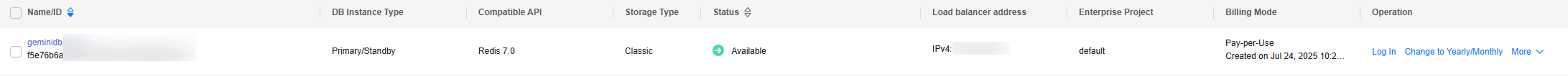

7. On the Instances page, view and manage the created instance.
  • Creating an instance takes about 5 to 9 minutes. During the process, the instance status becomes Creating.
  • After the instance is created, its status becomes Available.
Figure 4 Available instance

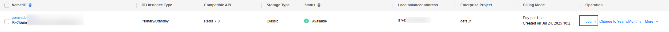

  2. In the instance list, locate the target instance and click Log In in the Operation column.
    Figure 5 Logging in to a GeminiDB Redis instance

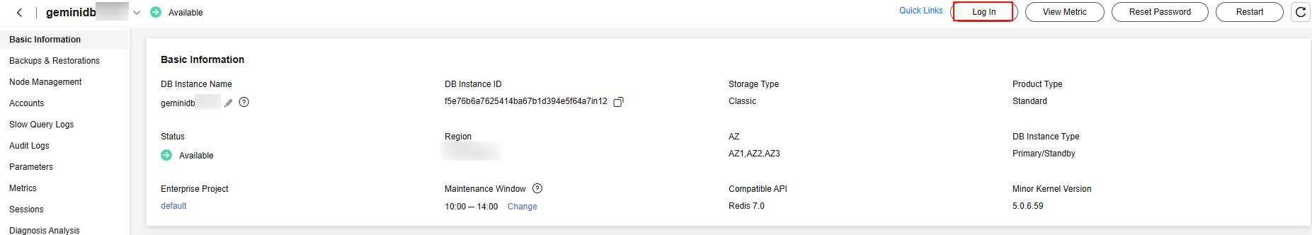

    Alternatively, click the instance name to go to the Basic Information page. Click Log In in the upper right corner of the page.
    Figure 6 Logging in to a GeminiDB Redis instance

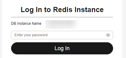

  3. Enter a password for logging in to the instance.
    Figure 7 Logging in to a GeminiDB Redis instance

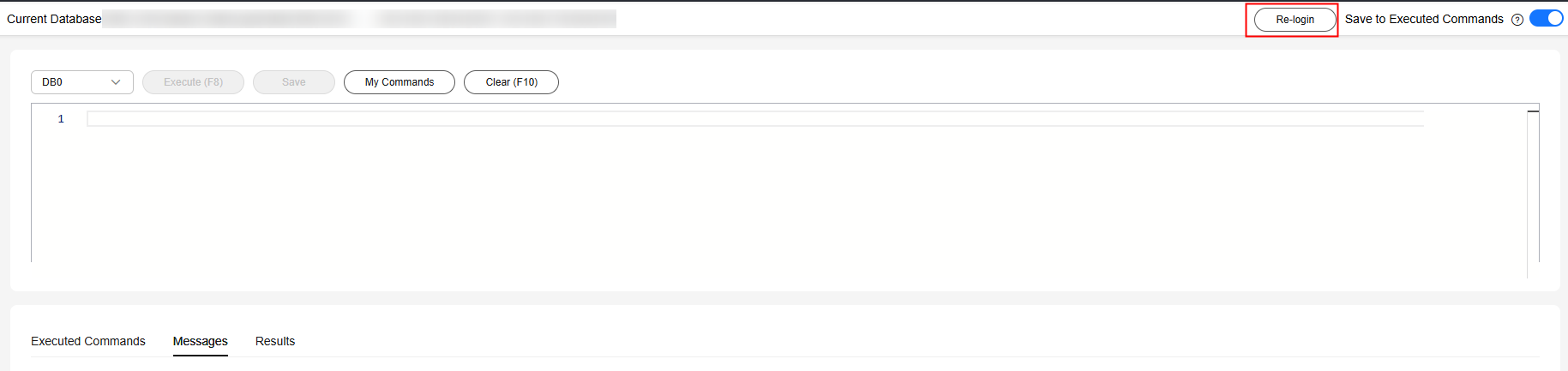

    If you need to log in again after the password is reset, click Re-login in the upper right corner and use the new password.
    Figure 8 Re-login

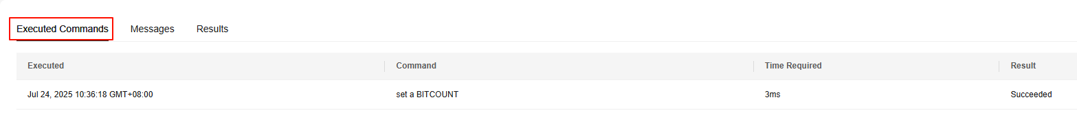

    • Save commands to the execution record.
      This function is enabled by default to save the recently executed commands for your later query.
      Then you can click the Executed Commands tab on the lower page to view historical commands.
      Figure 10 Viewing executed commands
      If this function is disabled, the commands executed subsequently are not displayed. You can click next to Save Executed SQL Statements in the upper right corner to disable this function.

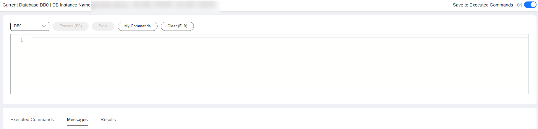

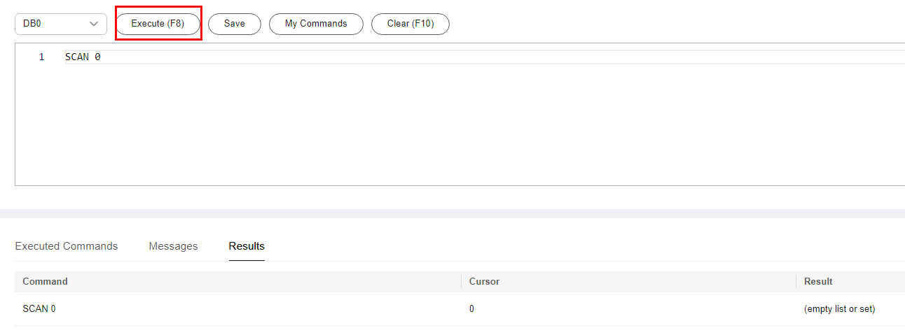

    • Execute a command.
      Enter a command in the command window and click Execute or F8.
      • Do not use transactions, Lua scripts, Pub/Sub commands, or other commands that have blocking semantics.
      • For an instance that supports multiple databases, you can change the current database on the console but cannot change it using a SELECT statement.
      Figure 11 Executing a command
      After a command is executed, you can view the execution result on the Results page.

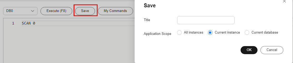

    • Save a command.
      You can save a command to all instances, the current instance, or the current database. Then you can view details in My Commands.
      Figure 12 Saving a command

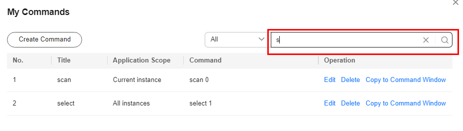

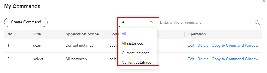

    • View my commands.
      Common commands are displayed the My Commands page.
      You can set a filter to narrow the scope of commands. If you select All, all commands saved in the current account are displayed.
      Figure 13 Filtering commands
      Alternatively, you can enter a command title or statement in the search box to search for the corresponding command.
      Figure 14 Searching for a command

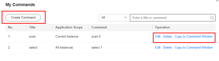

      On the My Commands page, you can also create, edit, and delete a command or copy it to the command window.
      Figure 15 Managing a command

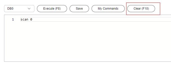

    • Clear a command.
      You can also press F10 to clear the command in the command window.
      Figure 16 Clearing a command
