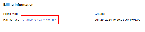

    Alternatively, click the instance name to go to the Basic Information page. In the Billing Information area, click Change to Yearly/Monthly in the Billing Mode field.
