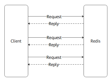

GeminiDB Redis API is a request–reply model service.
Figure 1 Command execution process of GeminiDB Redis API
  1. A client sends a command to a server running the GeminiDB Redis instance.
  2. The server receives the command and waits in a queue for processing.
  3. The server processes the command.
  4. The server sends the result to the client.
Steps 1 and 4 are I/O operations, which are slow and affected by network conditions. Therefore, bottlenecks may occur.

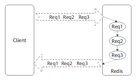

To reduce network costs and fully utilize performance of GeminiDB Redis API, you can execute multiple commands in a pipeline at once without waiting for individual command reply.
Figure 2 Accessing a GeminiDB Redis instance using a pipeline
The I/O operation is performed once to issue three commands.
Using a pipeline can reduce read() and write() system calls of a client and server and improve program execution efficiency.
