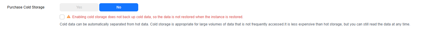

    Purchase Cold Storage
    Cold storage stores historical data that is not frequently queried. When purchasing a GeminiDB Influx instance, you can purchase cold storage and configure the retention policy to specify the retention period of hot data. In this way, hot data will be automatically archived in cold storage after the retention period expires, reducing storage costs. The value can be:
    • Yes
      Set the cold storage capacity to suit your service requirements.
    • No
      You do not want to purchase cold storage.
    For more information about cold and hot data separation, see Cold and Hot Data Separation.
    If you do not enable cold storage when creating an instance, you can enable it later based on service requirements. For details, see Enabling Cold Storage.
    NOTE:
    Cold storage cannot be disabled after being enabled.
    Cold Storage
    The cold storage space is an integer from 500 GB to 1,024,000 GB. You can add at least a multiple of 10 GB each time.
    After an instance is created, you can scale up its cold storage. For details, see Scaling Up Cold Storage.
