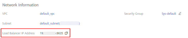

  • In the preceding code, 172.xx.xx.xx indicates the load balancer IP address of the GeminiDB Redis instance that you want to connect to.
    You can click the instance name to go to the Basic Information page and obtain the load balancer IP address in the Network Information area.
    Figure 1 Viewing the load balancer IP address
  • 6379 in the preceding code is the port of the instance to be connected. Replace it with the actual port number. For details about how to obtain the port number, see Viewing the IP Address and Port Number of a GeminiDB Redis Instance.

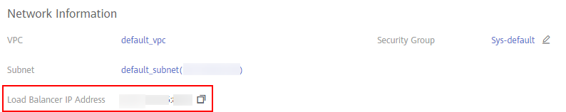

    Figure 2 Viewing the load balancer IP address
