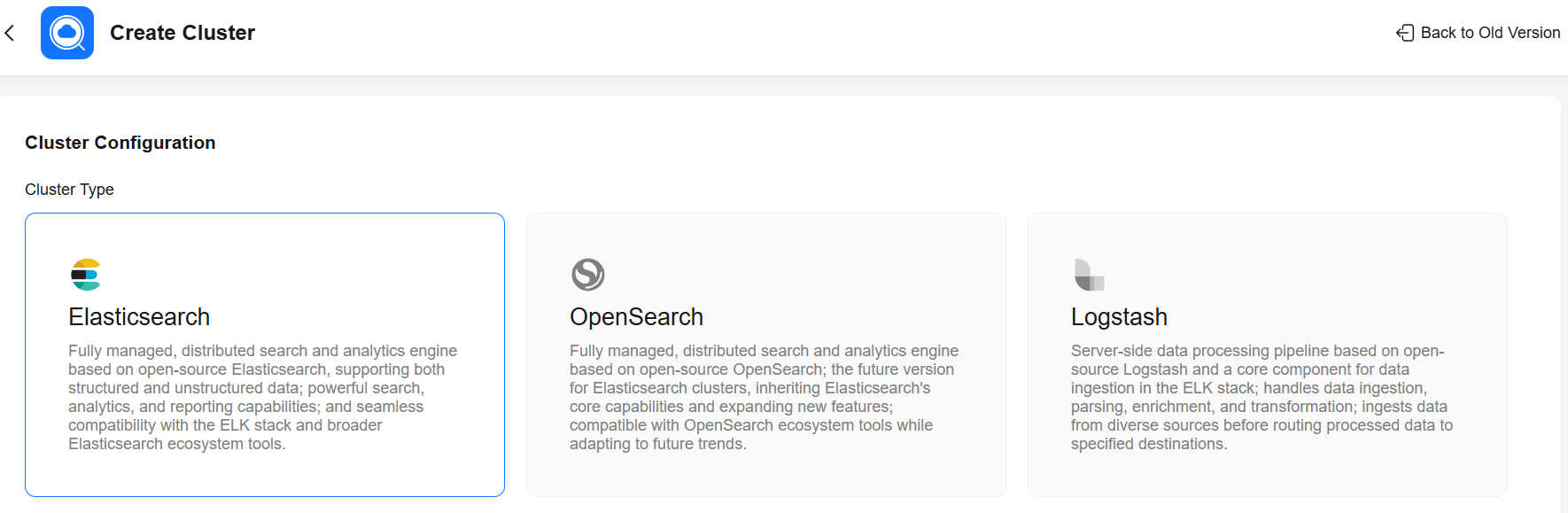

- In the upper right corner, click Create Cluster. The new-version UI for creating a cluster is displayed by default. Figure 1 Create Cluster (new version)
- Select the cluster type and version.
Table 2 Cluster configuration Parameter
Example
Description
Cluster Type
Elasticsearch
Select Elasticsearch.
Cluster Version
7.10.2
Select a cluster version from the drop-down list.
