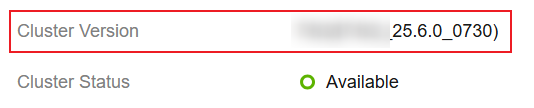

  9. Confirm the upgrade result.
    1. In the cluster list, click the name of the target cluster. The cluster information page is displayed.
    2. On the Overview tab, check the cluster version in the Cluster Information area to determine whether the upgrade is successful.
      Figure 2 Checking the cluster version
