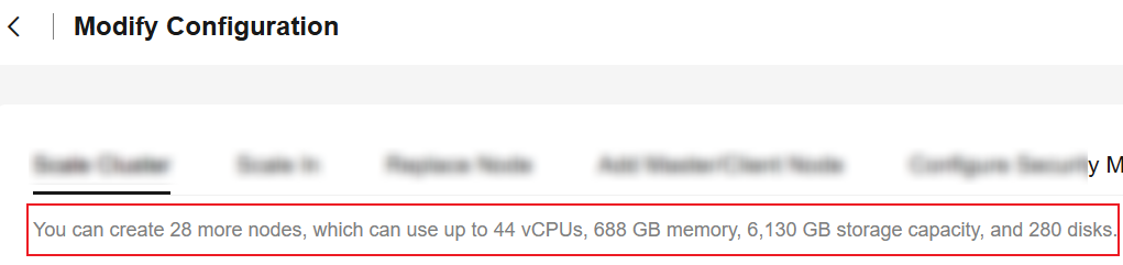

  • Your CSS resource quotas are sufficient for the capacity expansion you are about to perform. You can check available resources on the Modify Configuration page.
    Figure 1 Checking available resources
