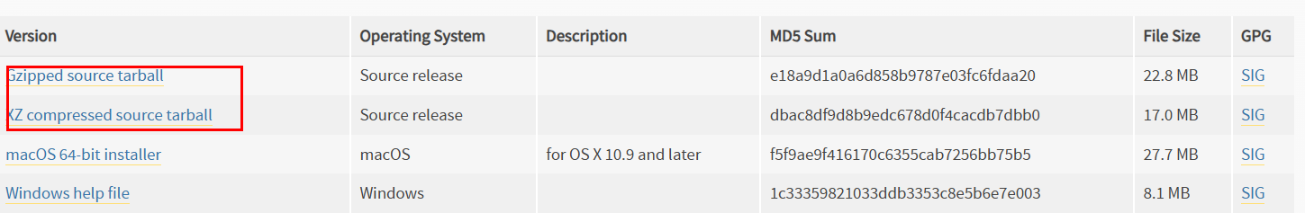

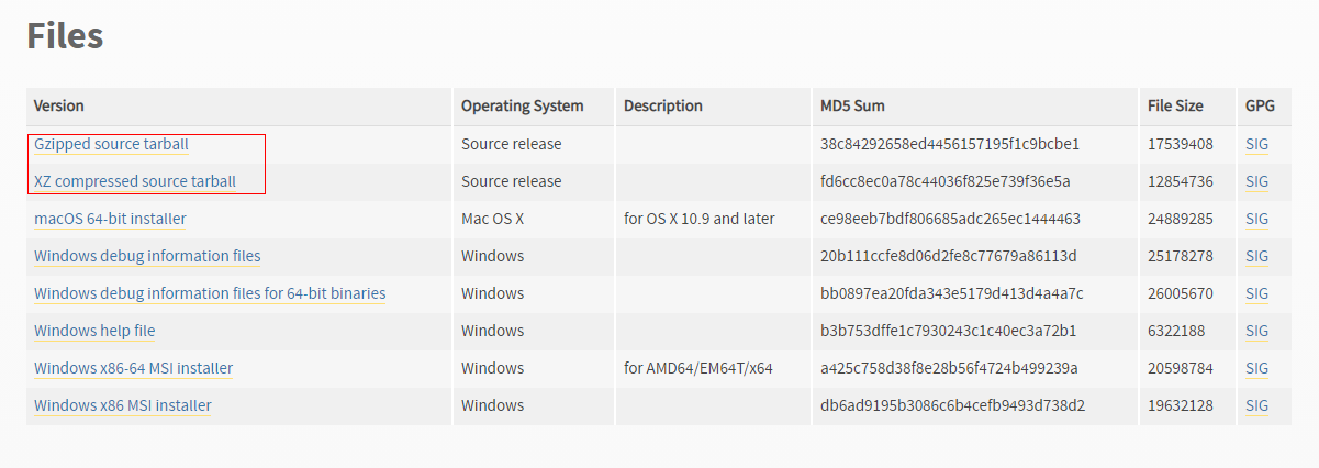

  1. Create an ECS to migrate the metadata of the source cluster.
    1. Create an ECS. Select CentOS as the OS of the ECS and 2U4G as its flavor. The ECS must be in the same VPC and security group as the CSS cluster.
    2. Test the connectivity between the ECS and the source and destination clusters.
      Run the curl http://{ip}:{port} command on the ECS to test the connectivity. If 200 is returned, the connection is successful.
      IP indicates the access address of the source or destination cluster. port indicates the port number. The default port number is 9200. Use the actual port number of the cluster.
  2. Install Python for executing the migration script.
    Select a proper Python installation method based on the ECS (executor) environment.
