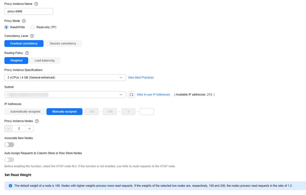

- On the displayed page, set required parameters and click Next. Figure 1 Creating a proxy instance

Table 1 Parameter description Parameter
Description
Proxy Instance Name
The name can consist of 4 to 64 characters and must start with a letter. Only letters (case-sensitive), digits, hyphens (-), and underscores (_) are allowed.
Proxy Mode
You can select Read/Write, Read-only (TP), or Read-only (AP) as needed.
- Read/Write: All write requests are forwarded only to the primary node, and all read requests are forwarded to the selected nodes based on the read weights or active connections. The default read weight of a node is 100.
- Read-only (TP): Write requests are not forwarded to any node. All read requests are forwarded to the selected read replicas based on the read weights or active connections. The read requests are not forwarded to the primary node, even if the primary node is selected.
- Only read requests are supported in the read-only (TP) mode. If write requests are forwarded to any node, an error message is displayed.
- DDL, DML, and temporary table operations are not supported in the read-only (TP) mode.
- Read-only (AP): Write requests are not forwarded to any node. All read requests are forwarded to the selected nodes based on the read weights. This mode is in the OBT phase. To use it, submit a service ticket.
- Only the weighted routing policy is supported in the read-only (AP) mode. The weights of AP nodes cannot be all 0.
- Binlog pull is not supported.
- Session consistency is not supported. Only eventual consistency is supported.
- Transaction splitting is not supported.
- The feature for assigning requests to row and column store nodes is not supported.
- Session-level connection pooling is not supported.
- ALT is not supported.
- New nodes cannot be automatically associated with a proxy instance.
Consistency Level
The consistency level can only be configured when the kernel version of your TaurusDB instance is 2.0.28.1 or later. For details about how to check the kernel version, see How Can I Check the Version of a TaurusDB Instance?
Value:
- Eventual consistency
After a proxy instance is created, consecutive SELECT requests within the same session are routed to different nodes based on their configured weights. Due to varying replication latencies between the primary node and the read replicas, the SELECT queries may return inconsistent results. As a result, the proxy instance ensures only eventual consistency by default.
To offload read requests from the primary node to read replicas, you can select eventual consistency.
To prevent data inconsistencies across multiple SELECT requests caused by eventual consistency, the database proxy provides session-level consistency. It guarantees that within a session, each SELECT query returns the latest data written by previous operations in the same session.
To use session consistency, the kernel version of your proxy instance must be 2.7.4.0 or later.
- Global consistency
Global consistency ensures data consistency in different sessions. It means that once data is written, you can immediately query the updated data.
You can select global consistency when there are more read operations than write operations.
Global consistency is only available when the TaurusDB instance kernel is 2.0.57.240900 or later and the proxy instance kernel is 2.25.06.000 or later.
For more information about consistency levels, see Changing the Consistency Level of a Proxy Instance.
Routing Policy
Value:
- Weighted: Read requests are assigned to nodes based on the weights you specify.
- Load balancing: There are two load balancing modes.
- Load balancing (database nodes): Read requests are distributed based on the number of active connections on each database node. Read requests are routed to nodes with fewer active connections. This mode requires database proxy kernel version 2.22.07.000 or later.
- Load balancing (proxy nodes): The proxy instance independently tracks the number of active connections on each database node and prioritizes routing read requests to the node with the fewest active connections. This mode requires database proxy kernel version 2.26.09.000 or later.
- Nearby AZ: A proxy node preferentially routes read requests to the database nodes in the same AZ as the proxy node.
To use the Nearby AZ routing policy, ensure that the proxy instance's engine version is 2.23.12.000 or later.
For more information about routing policies, see Changing the Routing Policy of a Proxy Instance.
Proxy Instance Specifications
You can select the proxy instance specifications as needed.
- Kunpeng general computing-plus: 2 vCPUs | 4 GB, 4 vCPUs | 8 GB, and 8 vCPUs | 16 GB
- General-enhanced: 2 vCPUs | 4 GB, 4 vCPUs | 8 GB, and 8 vCPUs | 16 GB
Subnet
This function is in the OBT phase. To use it, submit a service ticket.
When creating a proxy instance, you can specify a subnet for the proxy instance. If the subnet where the TaurusDB instance is associated with is a secondary CIDR block, you can only select the same subnet as the TaurusDB instance for the proxy instance.
IP Addresses
IPv4 addresses can be automatically or manually assigned.
- Automatically-assigned: When you create a proxy instance, TaurusDB automatically assigns an IPv4 proxy address.
- Manually-assigned: You can enter an available IPv4 address within the subnet CIDR block as the proxy address of the TaurusDB instance. You can click View In-use IP Addresses to view the IP addresses that have been used.
Proxy Instance Nodes
You can enter an integer from 2 to 16. The default value is 2.
Number of recommended proxy instance nodes = (Number of vCPUs of the primary node + Total number of vCPUs of all read replicas)/(4 x Number of vCPUs of the proxy instance), rounded up.
AZ Assignment Mode
Select either of the following modes:
- Auto Assign: randomly assigns proxy nodes to AZs, with a preference for matching the AZ of the TaurusDB node.
- Manual assign: assigns proxy nodes to the AZs you specify.
Node AZ
Select the AZs where proxy nodes will be deployed.
Associate New Nodes
After Associate New Nodes is enabled, new read replicas will be automatically associated with the proxy instance.
New Node Weight
If Routing Policy is Weighted, you need to configure read weights for the new nodes. The default weight of a node is 100. Nodes with higher weights process more read requests.
Auto Assign Requests to Column Store or Row Store Nodes
After this function is enabled, a proxy instance distributes requests based on the actual execution cost of a SQL statement to maximize the query performance. For details about the usage and constraints, see Enabling Request Distribution Among Row Store and Column Store Nodes for Complex OLAP Queries.
Database Nodes
Select nodes to be associated with the proxy instance for processing read requests. The nodes displayed in the list include TaurusDB nodes (the primary node and read replicas) and HTAP nodes (BE nodes and FE nodes).
- If Routing Policy is Load balancing, you do not need to configure read weights for selected nodes. Read requests are forwarded to nodes with fewer active connections.
- If Routing Policy is Weighted, you need to configure read weights of the primary node and read replicas. Read requests are forwarded to nodes based on the weights you specify.
For example, the read weights assigned to one primary node and two read replicas are 100, 200, and 200, respectively.
In the read/write mode, the primary node and two read replicas process read requests in the ratio of 1:2:2. The primary node processes 20% of read requests, and each read replica processes 40% of read requests. Write requests are automatically routed to the primary node.
In the read-only mode, the read weight of the primary node does not take effect, and the two read replicas process 50% of read requests, respectively.
