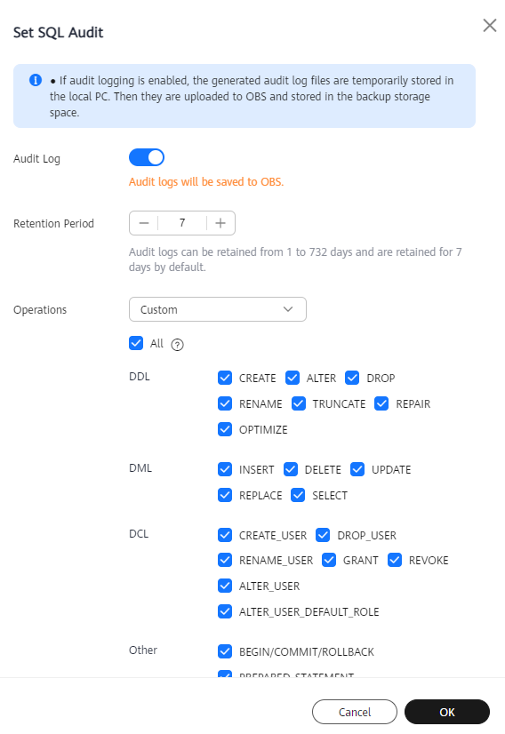

  5. Click Set SQL Audit. In the displayed dialog box, enable Audit Log and set Retention Period and Operations. Audit logs can be retained from 1 to 732 days and are retained for 7 days by default.
    Figure 1 Setting SQL audit
    After SQL audit is enabled, Data Definition Language (DDL), Data Manipulation Language (DML), Data Control Language (DCL), and other operation types are supported. For details, see the following tables.
    The SQL statements executed by PreparedStatement and scheduled tasks through a MySQL client will be treated as PREPARED_STATEMENT and CREATE, respectively. However, the SQL statements executed by PreparedStatement through JDBC will not be recorded.

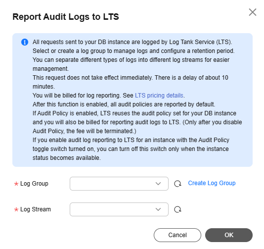

  5. Click next to Report Audit Logs to LTS.
  6. In the displayed dialog box, select a log group and log stream, and click OK.
    Figure 2 Reporting audit logs to LTS

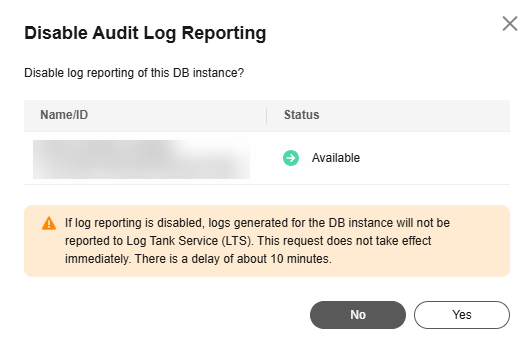

  6. In the displayed dialog box, click Yes.
    Figure 4 Disabling audit log reporting
