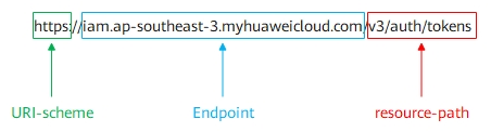

Request URI
Although a request URI is included in the request header, most programming languages or frameworks require the request URI to be transmitted separately.
A request URI consists of four parts: {URI-scheme} :// {Endpoint} / {resource-path}? {query-string}
The following table describes the parameters.
| Parameter | Description |
| URI-scheme | Protocol used to transmit requests. All APIs use HTTPS. |
| Endpoint | Domain name or IP address of the server bearing the REST service. The endpoint varies between services in different regions. It can be obtained from Regions and Endpoints. For example, the endpoint of IAM in the AP-Singapore region is iam.ap-southeast-3.myhuaweicloud.com. |
| resource-path | The resource path, that is, the API access path, is obtained from the URI of a specific API. For example, the resource-path of the API used to obtain a user token is /v3/auth/tokens. |
| query-string | (Optional) Query a parameter. The query parameter is prefixed with a question mark (?), in the format of Parameter name=Parameter value. For example, limit=10 indicates that a maximum of 10 data records will be queried. |
For example, to obtain the IAM token in region AP-Singapore, obtain the endpoint of this region (iam.ap-southeast-3.myhuaweicloud.com) and find the resource path (/v3/auth/tokens) in the URI for obtaining a user token. Then, construct the URI as follows:
https://iam.ap-southeast-3.myhuaweicloud.com/v3/auth/tokens
