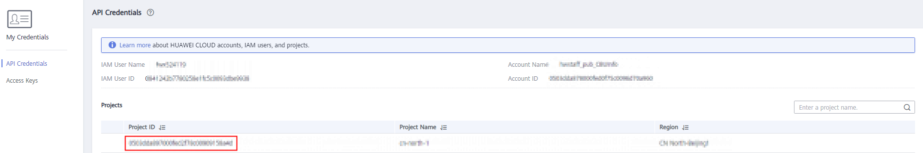

A project ID is required for some URLs when an API is called. To obtain an ID, do as follows:
  1. Log in to CSE.
  2. Move the cursor to the username in the upper right corner and select My Credentials from the drop-down list.
  3. On the Projects tab, obtain the required project ID in the project list.
    Figure 1 Viewing a project ID
