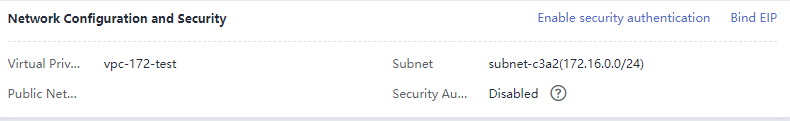

Binding an EIP
ServiceComb engines that are bound with EIPs can be accessed from the public network.
- Click the target engine.
- In the Network Configuration and Security area, click Bind EIP.
- Read the security risk prompt in the displayed dialog box and select I understand the security risks.
- In the EIP drop-down list, select the EIP to be bound. You can only select an EIP in the same enterprise project as the ServiceComb engine.
- Click OK.

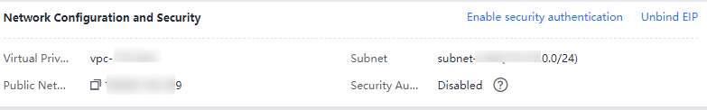

Unbinding an EIP
If an EIP has been bound to a ServiceComb engine, you can unbind the EIP from the engine to disable the public network access to the engine.
- In the Network Configuration and Security area, click Unbind EIP.
- In the displayed dialog box, click OK.
