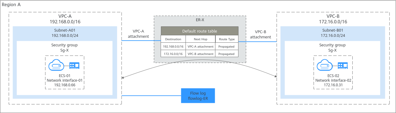

Solution Architecture
In this example, enterprise router ER-X is used to connect two VPCs (VPC-A and VPC-B). To view the traffic between the two VPCs and locate issues, you need to create a flow log for the enterprise router to collect the logs of VPC-A attachment.
Figure 1 Viewing the traffic between ECSs in different VPCs

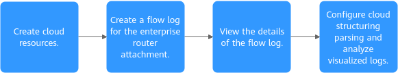

Figure 2 shows the process for viewing the traffic between ECSs in different VPCs.
Figure 2 Process for viewing traffic between VPCs connected by an enterprise router

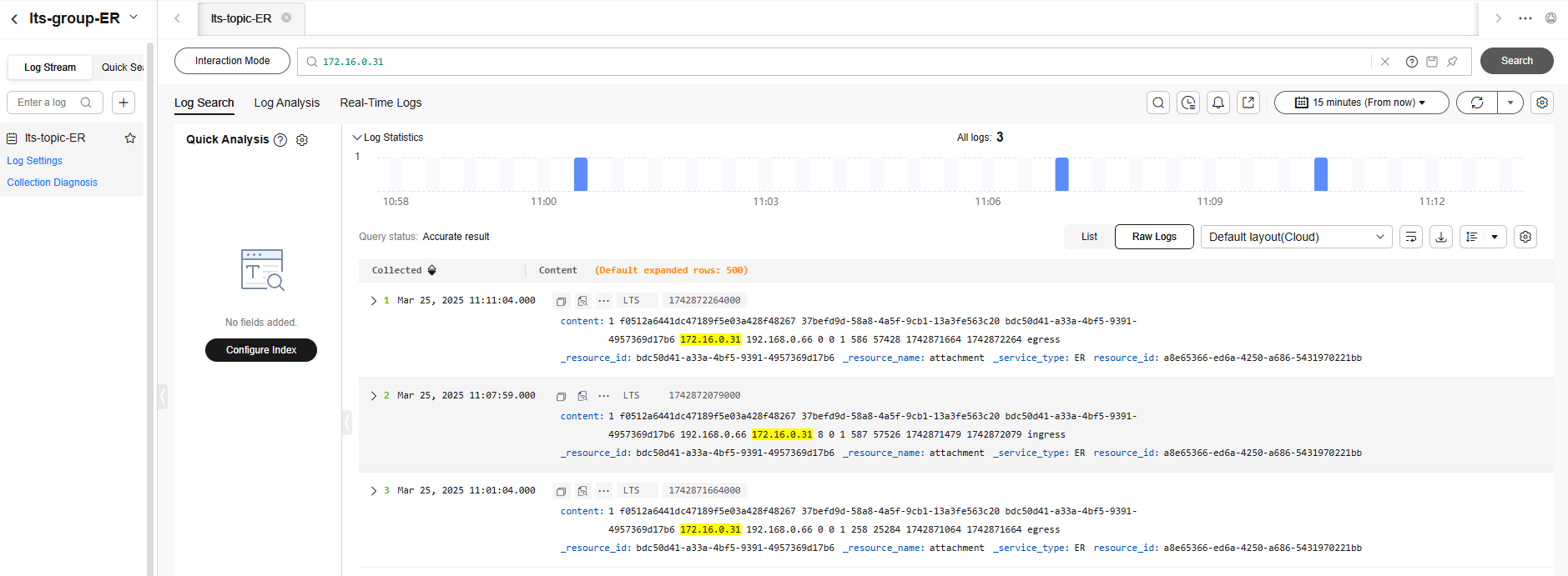

  3. Wait for about 10 minutes and view the flow log information. For details, see Viewing Details About a Flow Log.
    You can enter the IP address (172.16.0.31) of ECS-02 in the search box to quickly filter the logs of the communication between ECS-01 and ECS-02.
    Figure 3 Viewing logs

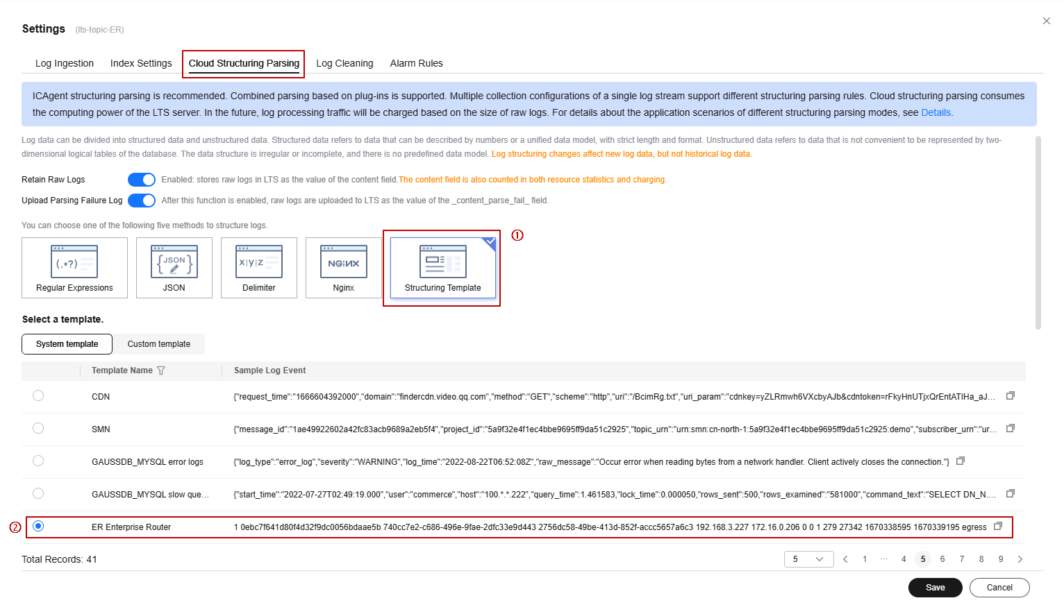

Step 4: Configure Cloud Structuring Parsing and Analyze Visualized Logs for the Enterprise Router Flow Log
LTS allows you to search for and analyze collected logs and displays log analysis results in a visualized manner.
  1. Configure cloud structuring parsing.
    Table 4 shows the parameter settings in this example. For details, see Cloud Structuring Parsing.
    Figure 4 Configuring cloud structuring parsing
    Table 4 Parameters for configuring cloud structuring parsing
    Step
    Operation
    Select Structuring Template to structure logs.
    2
    In the system template list, select ER Enterprise Router.

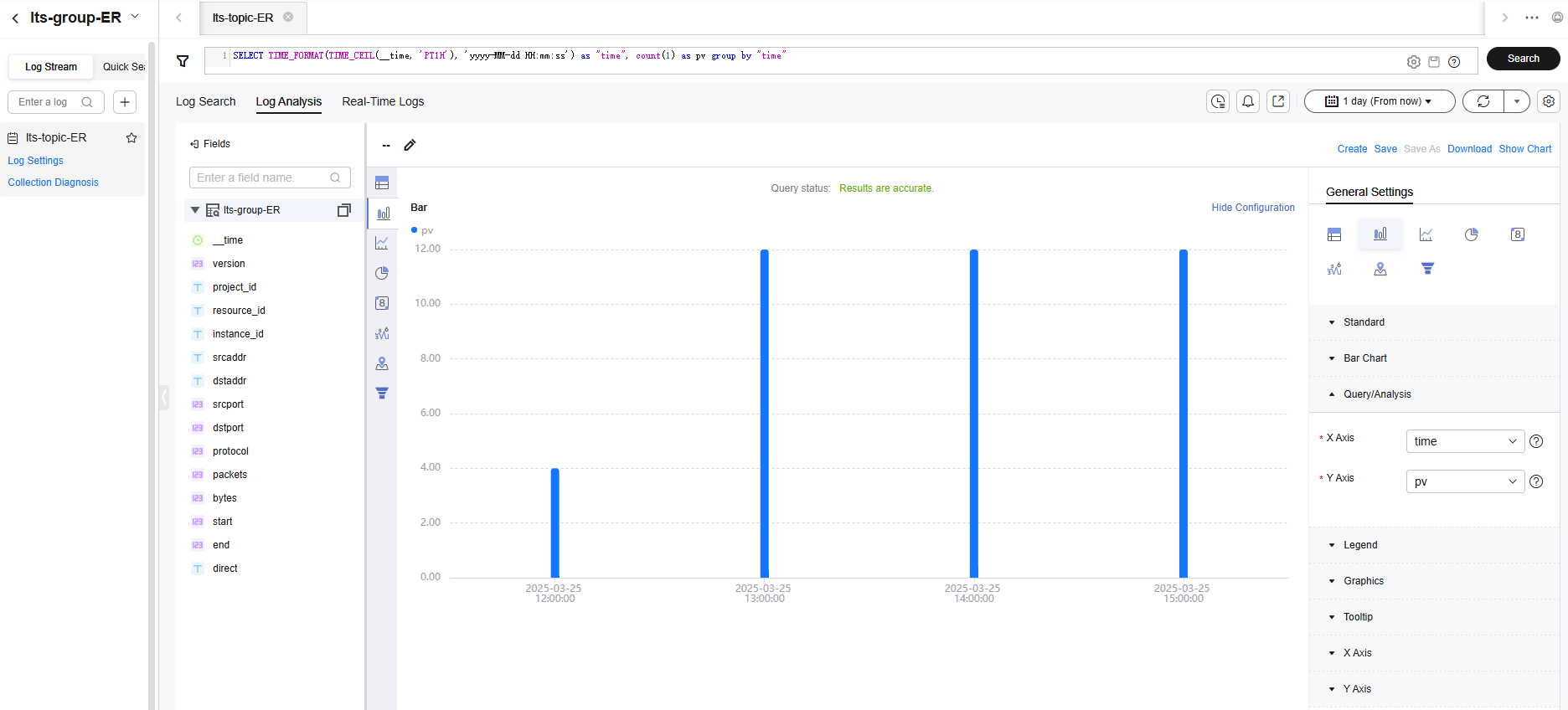

    • Visualize logs in statistical charts. Statistical charts, such as tables, bar charts, and line charts, are rendered by LTS based on SQL query syntax.
      1. On the Log Analysis tab, enter the required statement in the search box by referring to Using SQL Analysis Syntax to obtain the required logs.
        The following takes the traffic of ECS-01 every hour as an example.
        SELECT TIME_FORMAT(TIME_CEIL(__time, 'PT1H'), 'yyyy-MM-dd HH:mm:ss') as "time", count(1) as pv group by "time"
      2. On the right of the page, configure the time and other information.
        In this example, you can view the hourly traffic data within a day. For more information about the statistical charts, see Statistical Charts.
        Figure 5 Traffic bar chart

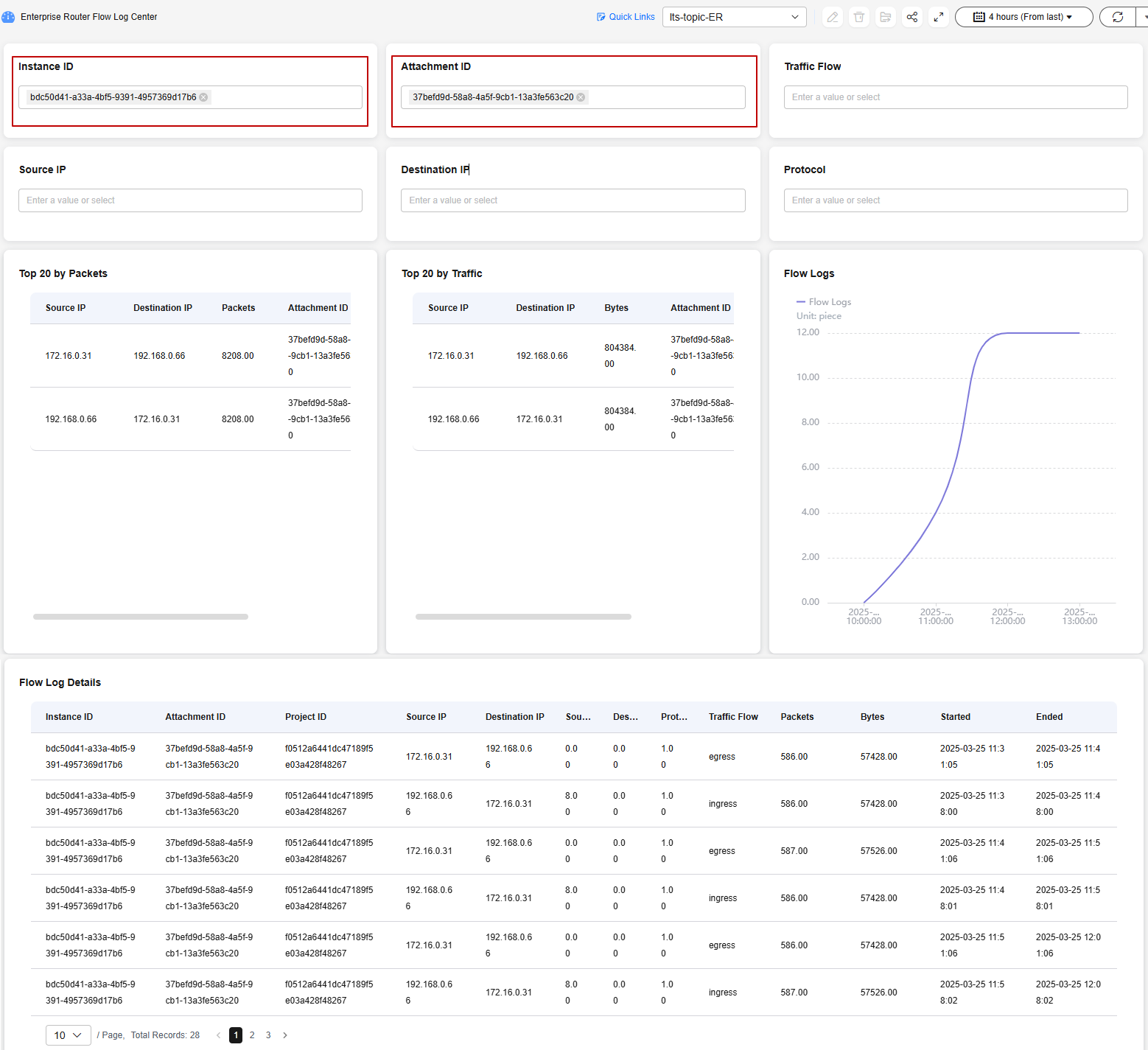

    • Visualize logs in dashboards. The dashboard is a real-time data visualization tool provided by LTS.
      1. After an enterprise router flow log is created, choose Dashboards > ER dashboard templates > Enterprise Router Flow Log Center on the LTS console.
        On the enterprise router dashboard details page, wait for several minutes and view the flow log data. In this example, select the instance and the attachment to view flow log information. For more dashboard information, see ER Dashboard Template.
        Figure 6 Enterprise router flow log dashboard
