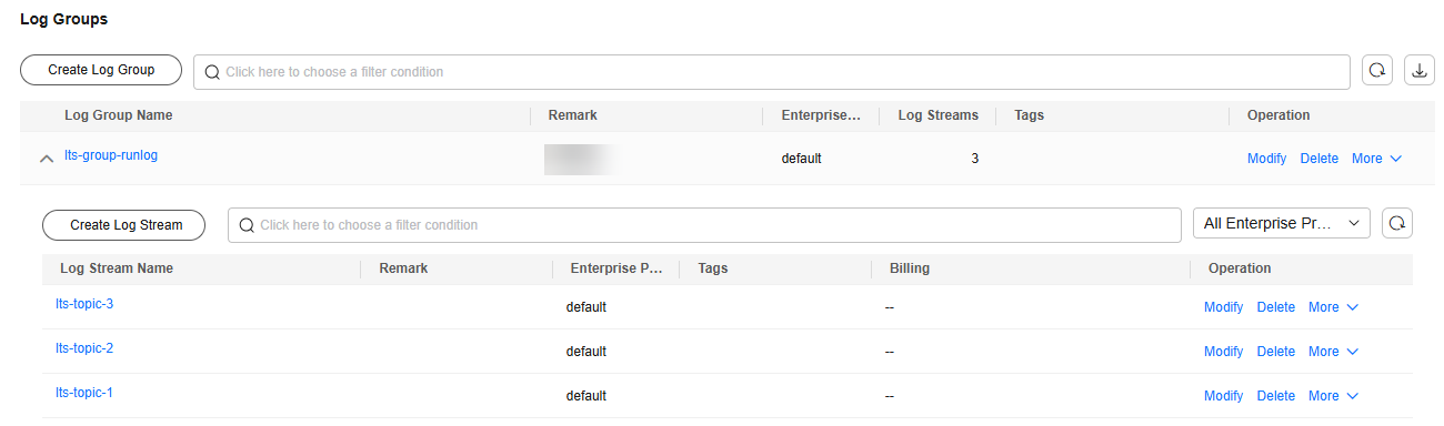

Creating a Log Stream
- Log in to the LTS console.
- On the Log Management page, click
on the left of the target log group. - Click Create Log Stream. On the displayed page, set log stream parameters by referring to Table 1.

- Click OK. The created log stream will be displayed under the log group. Figure 1 Creating a log stream

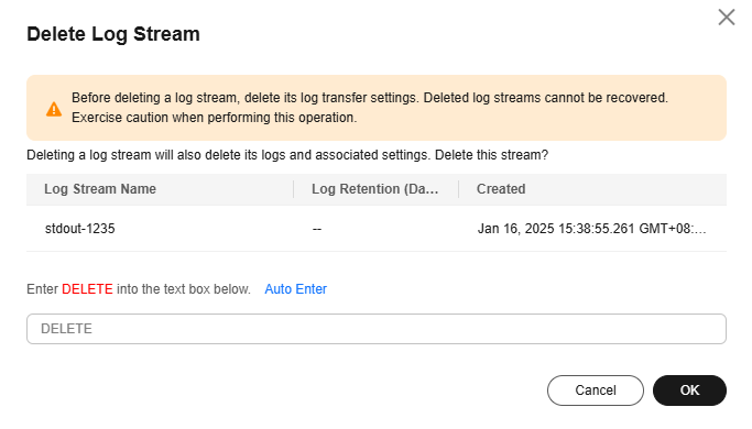

Deleting a Log Stream
You can delete a log stream that is no longer needed. Deleting a log stream will also delete the log data in the log stream.
Before deleting a log stream, check if it is being used by other services, such as log ingestion configurations, log transfer tasks, or log alarm rules. Deleting it while in use may interrupt log reporting.
- Deleting a log stream will cause exceptions in log-related services. Deleted log streams cannot be restored. Exercise caution when performing this operation.
- If a log stream has associated objects, deleting the log stream will also delete the associated objects. Exercise caution when performing this operation.
- In the log stream list, locate the target log stream and click Delete in the Operation column.
- In the displayed dialog box, enter DELETE or click Auto Enter. Figure 2 Deleting a log stream
- Click OK.
The log stream is successfully deleted once it no longer appears in the log stream list.
