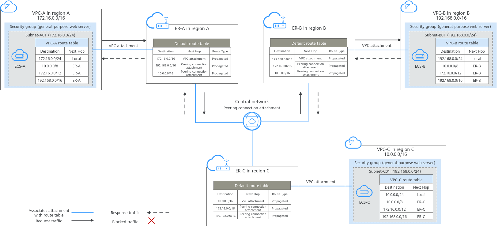

Architecture
For nearby access, an enterprise runs workloads in regions A, B, and C. The VPCs in each region need to communicate with each other. To achieve this, you can:
  1. Create an enterprise router in each region: ER-A in region A, ER-B in region B, and ER-C in region C.
  2. Create a central network and add ER-A, ER-B, and ER-C to the central network as attachments so that the three enterprise routers can communicate with each other.
  3. In region A, attach VPC-A01 and VPC-A02 to ER-A so that the two VPCs can communicate with each other. Perform the same operations in regions B and C. In this way, the VPCs in the three regions can communicate with each other over the central network.
Figure 1 Communication between VPCs in different regions

Network Planning
Figure 2 shows the network planning for communication between VPCs across regions. For details about the network planning, see Table 2.
In this example, one VPC is created and attached to an enterprise router in each region. Make the plan based on your service requirements.
Figure 2 Cross-region VPC network planning
Table 1 Network traffic flows
Traffic Flow
What to Do
Request traffic: from VPC-A to VPC-B
  1. In the route table of VPC-A, there are routes with the next hop set to enterprise router ER-A to forward traffic from VPC-A to ER-A.
  2. In the route table of enterprise router ER-A, there is a route with the next hop set to the peering connection attachment and destination to 192.168.0.0/16 to forward traffic from ER-A to enterprise router ER-B.
  3. In the route table of enterprise router ER-B, there is a route with the next hop set to the VPC-B attachment to forward traffic from ER-B to VPC-B.
Response traffic: from VPC-B to VPC-A
  1. In the route table of VPC-B, there are routes with the next hop set to enterprise router ER-B to forward traffic from VPC-B to ER-B.
  2. In the route table of enterprise router ER-B, there is a route with the next hop set to the peering connection attachment and destination to 172.16.0.0/16 to forward traffic from ER-B to enterprise router ER-A.
  3. In the route table of enterprise router ER-A, there is a route with the next hop set to the VPC-A attachment to forward traffic from ER-A to VPC-A.

  1. Create an enterprise router in each of the three regions.
    For details, see Creating an Enterprise Router.
    Specify a unique ASN for each enterprise router.
  2. Create a VPC in each of the three regions.
    For details, see Creating a VPC with a Subnet.
  3. Create an ECS in each of the three regions.
    For details, see Purchasing an ECS in Custom Config Mode.
  4. Create a central network and add the enterprise routers to the central network as attachments.
    1. Create a central network and add the enterprise routers to the central network as attachments.
      For details, see Creating a Central Network.
    2. On the Enterprise Router console, view the peering connection attachments.
      For details, see Viewing Details About an Attachment.
      If the status of the peering connection attachments is Normal, the attachments are available.
      Default Route Table Association and Default Route Table Propagation are enabled when you create enterprise routers. After peering connection attachments are created for the enterprise routers, Enterprise Router will automatically:
      • Associate the peering connection attachment with the default route table of each enterprise router.
      • Propagate the peering connection attachment to the default route table of each enterprise router. The route tables automatically learn routes from each other.
  5. Purchase three global connection bandwidths to connect networks in different regions.
    For details, see Purchasing a Global Connection Bandwidth.
Step 2: Create a VPC Attachment for Each Enterprise Router
Create a VPC attachment for each enterprise router. For details about resource planning, see Table 5.
  1. In region A, attach VPC-A to enterprise router ER-A.
    1. Attach the VPC to the enterprise router.
      In this example, enable Auto Add Routes to save you from manually configuring routes in the VPC route table.
      For details, see Creating VPC Attachments for an Enterprise Router.
      Default Route Table Association and Default Route Table Propagation are enabled when you create the enterprise router. After VPCs are attached to the enterprise routers, Enterprise Router will automatically:
      • Associate the VPC attachments with the default route table of the enterprise router.
      • Propagate the VPC attachments to the default route table of the enterprise router. The route table automatically learns the VPC CIDR blocks as the destination of routes.
    2. (Optional) Add routes to the VPC route table for traffic to route through the enterprise router.
      Skip this step if you have enabled Auto Add Routes in the previous step. For details about routes, see Table 3.
      For details, see Adding Routes to VPC Route Tables.
  2. In region B, attach VPC-B to enterprise router ER-B by referring to 1.
  3. In region C, attach VPC-C to enterprise router ER-C by referring to 1.
Step 3: Assign Cross-Site Connection Bandwidths for the Central Network
To allow cross-region VPC communications, you need to assign cross-region connection bandwidths on the central network based on service requirements by referring to Table 5.
By default, Cloud Connect allocates 10 kbit/s of bandwidth for testing connectivity between regions. After the peering connection attachments are created, you can verify the network connectivity between VPCs. For details, see Step 4: Verify Network Connectivity.
To ensure your workloads run normally, you need to purchase global connection bandwidths and assign cross-site connection bandwidths.
  1. Assign a cross-site connection bandwidth from the purchased global connection bandwidth for the communication between region A and region B.
    For details, see Assigning a Cross-Site Connection Bandwidth.
  2. Assign a cross-site connection bandwidth from the purchased global connection bandwidth for the communication between region A and region C.
  3. Assign a cross-site connection bandwidth from the purchased global connection bandwidth for the communication between region B and region C
