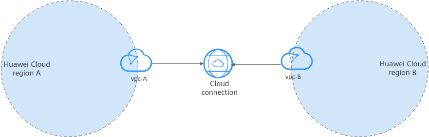

Solution Architecture
You have a VPC (vpc-A) in a region (CN Southwest-Guiyang1) and another VPC (vpc-B) in a different region (CN North-Beijing4). The two VPCs need to communicate with each other.
You need to create a cloud connection and load both VPCs to the cloud connection.
Figure 1 Communication between VPCs in different regions using the same account

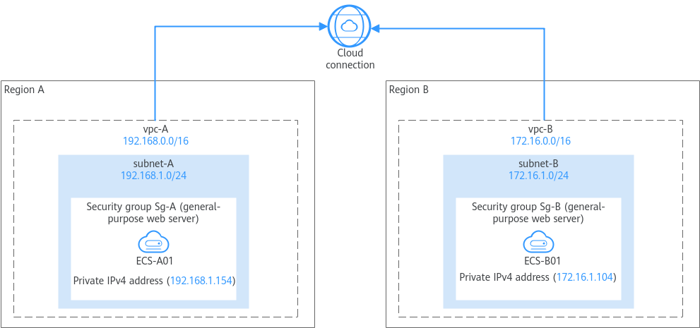

Planning the Network
Figure 2 and Table 1 show the network planning and description for communication between VPCs in different regions.
Figure 2 Cross-region VPC network planning

Planning Resources
The VPCs and ECSs must be in different regions, but they can be in any AZs.
The following resource details are only for your reference. You can modify them if needed.
  • Table 2 describes the two VPCs in detail. Their CIDR blocks cannot overlap with each other.

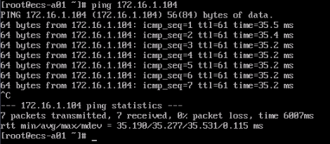

Log in to the ECSs and verify the network connectivity between VPCs.

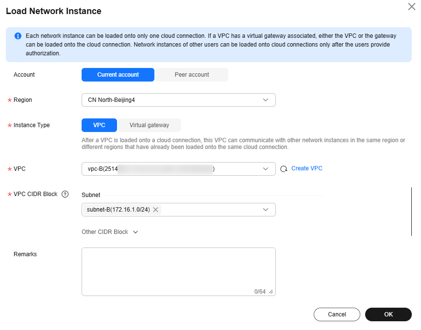

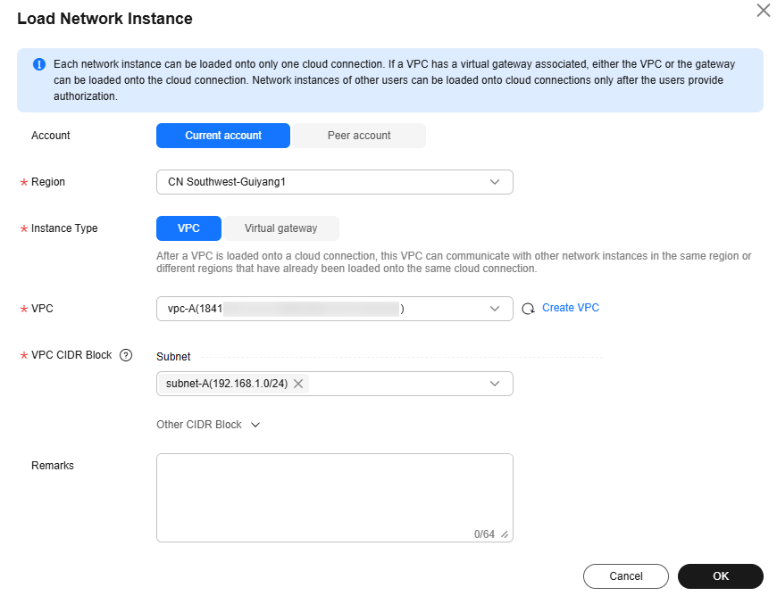

Step 4: Load Network Instances
Load the VPCs that need to communicate with each other to the cloud connection created in the previous step.
  1. Go to the Cloud Connections page.
  2. Click the name of the cloud connection to go to the Basic Information tab.
  3. Click the Network Instances tab.
  4. Click Load Network Instance.
  5. Configure the parameters based on Table 9 and click OK.
    Figure 4 Loading vpc-A in the same account
    Table 9 Parameters for loading network instances in the same account
    Parameter
    Example Value
    Description
    Account
    Current account
    Specifies the account that provides the network instance.
    Select Current account.
    Region
    Specifies the region where the VPC you want to connect is located.
    Instance Type
    VPC
    Specifies the type of the network instance that needs to be loaded to the cloud connection. There are two options:
    • VPC
    • Virtual gateway
    Select VPC.
    VPC
    vpc-A
    Specifies the VPC you want to load to the cloud connection.
    This parameter is mandatory if you have set Instance Type to VPC.
    VPC CIDR Block
    subnet-A
    Specifies the subnets in the VPC and custom CIDR blocks.
    If you have set Instance Type to VPC, you need to configure the following two parameters:
    • Subnet
    • Other CIDR Block: Add one or more custom CIDR blocks as needed.
    Remarks
    Provides supplementary information about the network instance.
  6. In the displayed dialog box, click Continue Loading. Then, click to load vpc-B in the same account but in a different region (CN North-Beijing4).
    Figure 5 Loading vpc-B in the same account

Step 7: Verify Network Connectivity
Log in to each ECS and verify the network connectivity between VPCs.
  1. Log in to ECS-A01.
    Multiple methods are available for logging in to an ECS. For details, see Logging In to an ECS.
    In this example, use VNC provided on the management console to log in to the ECSs.
  2. Ping the other ECS to verify the network connectivity between VPCs.
    ping <private-IP-address-of-ECS-B01>
    Example command:
    ping 172.16.1.104
    If the following information is displayed, vpc-A and vpc-B are connected.
