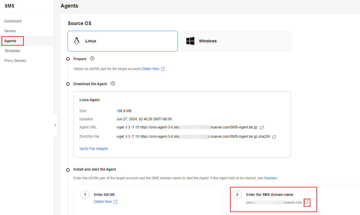

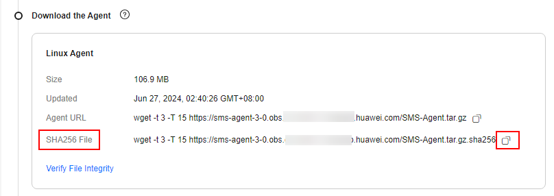

- Select the Linux card, and in the Linux Agent area, click the
icon next to Agent URL to copy the Agent download command. Run the command on the source server to download the Agent installation package.
- Copy and run the commands to download the CMS and CRL files to the Linux source server, then verify the integrity of the Agent installation file. For details, see How Do I Verify the Integrity of the Agent Installation File?

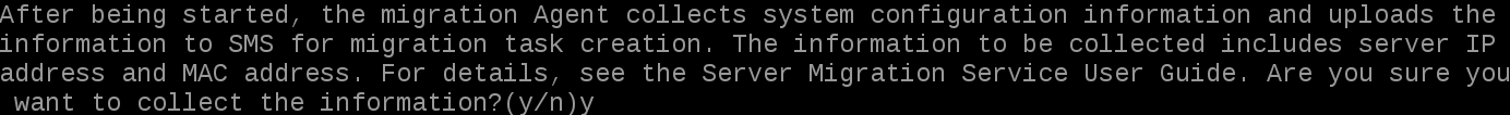

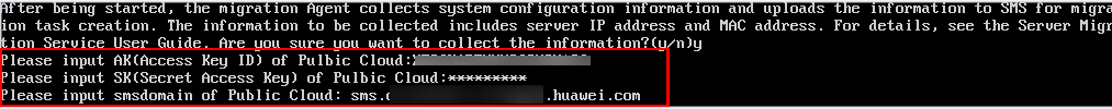

- Read the displayed information carefully, enter y, and press Enter. Figure 1 Entering y
- Enter the AK/SK pair for the Huawei Cloud account that you are migrating to and the SMS domain name. You can obtain the SMS domain name on the Agents page of the SMS console, as shown in Figure 3. Figure 2 Entering the AK/SK pair
If the EPS service has been enabled for your Huawei Cloud account, after you entered the AK/SK pair, the Agent will list all enterprise projects your account is allowed to access. You can select the enterprise project you would like to migrate the source server to. This enables you to isolate permissions, resources, and finance during the migration. For details, see Migrating a Server into an Enterprise Project.

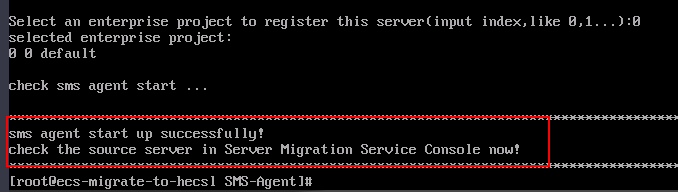

When the information shown in the figure below is displayed, the SMS-Agent has been started up and will automatically start reporting source server information to SMS. You can go to the Servers page on the SMS console to check the record of the source server.Figure 4 Agent running

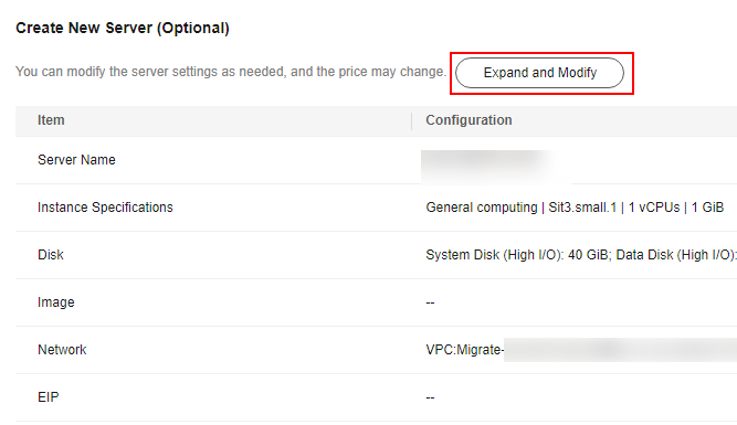

- Create new: SMS automatically purchases a target server based on the configured specifications.
If you select Create new, the system automatically recommends server specifications, including the server name, AZ, VM specifications, disk information, EIP, VPC, subnet, and security group. You can modify these settings as needed.

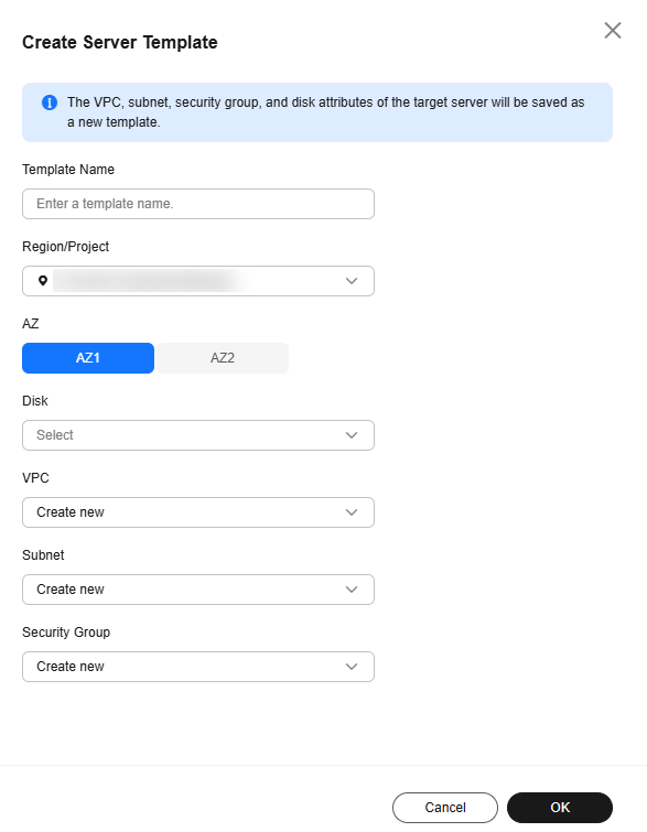

- If you select Custom Template for Server Template, the system automatically sets the AZ, instance specifications, disk type, VPC, subnet, and security group based on the template. You can adjust the settings. For details about how to create a custom template, see Creating a Server Template.

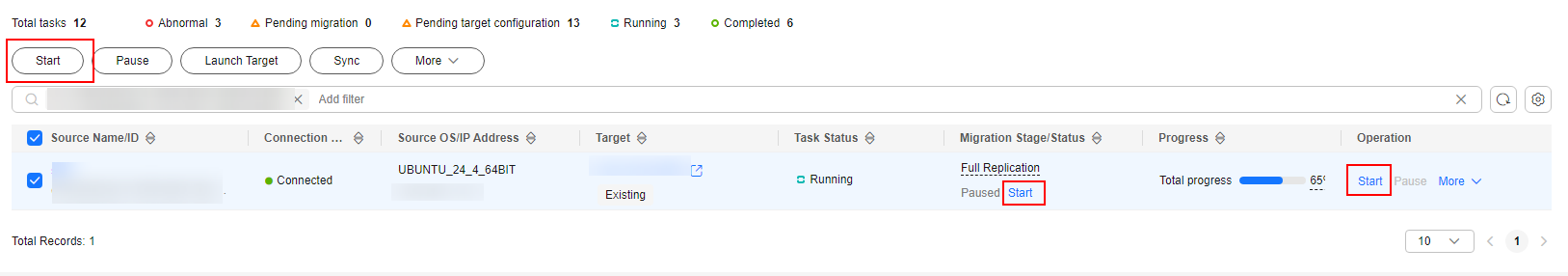

- Save the settings and start migration.

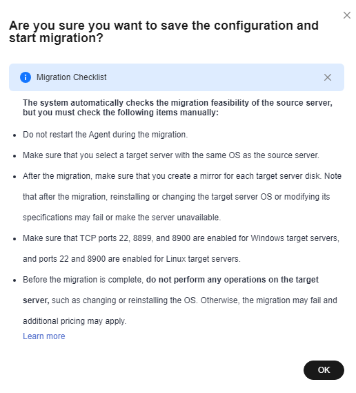

After configuring the target server settings, review them in the summary panel and choose whether to start the migration now or later.
- Saving the settings and starting the task immediately
- Click Save and Start.
- In the displayed dialog box, read the migration conditions and click OK. Return to the migration server list. The task status becomes Running, indicating that the migration has started.
- Saving the settings and starting the task later
- After you confirm that the settings are correct, click Save.
- In the displayed dialog box, read the migration conditions and click OK. Return to the migration server list. The task status becomes To be started, indicating that the migration is not started.
To start the migration, click Start in the Migration Stage/Status column.

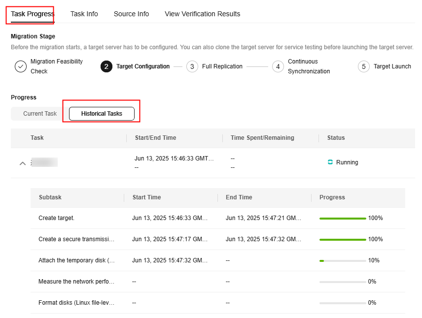

Step 3: Start Full Replication
A full replication replicates all data from the source server to the target server. The replication speed depends on the outbound bandwidth of the source server or the inbound bandwidth of the target server, whichever is smaller.
- Click the source server name to view the migration progress.
- If Enable Continuous Synchronization is set to No when you defined the migration task, the system automatically launches the target server after the full replication is complete. If Finished and Migration completed show in the Migration Stage/Status column, the target server has been launched.
- If Enable Continuous Synchronization is set to Yes when you defined the migration task, the task stage and status change to continuous sync after the full replication is complete. In this state, the system automatically synchronizes any new or modified disk data from the source server to the target server. If you want to stop continuous synchronization and launch the target server, perform operations described in Launching a Target Server.
- After the target server is launched, if there are data changes on the source server, you can synchronize the incremental data to the target server.
- After the migration and service cutover are complete, you need to adjust the configurations of the target server based on service requirements. For details, see What Configuration Items Do I Need to Modify for the Target Server After the Migration Is Complete?

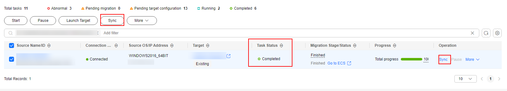

Step 4: Synchronize Incremental Data

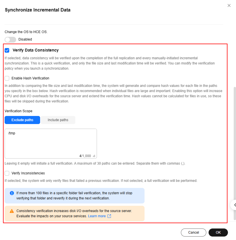

The data changes on the target server will be overwritten by the data synchronized from the source server. For details, see Will an Incremental Synchronization Overwrite the Existing Data on a Launched Target Server?
- In the server list, locate the source server you want to synchronize, and click Sync above the list, or choose More > Sync in the Operation column.
- In the Sync Incremental Data dialog box, carefully read the tips and enable Verify Data Consistency if needed. For details about this option, see How Do I Verify Data Consistency Between the Source and Target Servers? Then click OK.

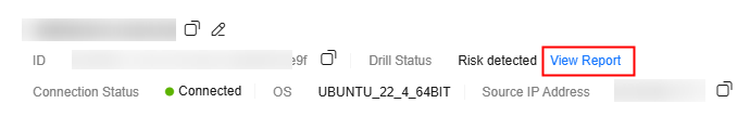

Checking the Migration Drill Status and Report
If Migration Drill is enabled when you configure a migration task, you can check the migration drill status and report.
- In the server list, click the name of the source server to expand the migration task details.
- On the Task Progress tab, check the status and progress of the migration drill.
- In the upper part of the task details page, click View Report next to Drill Status. In the report displayed on the right, check the drill details, check items, and check results.
