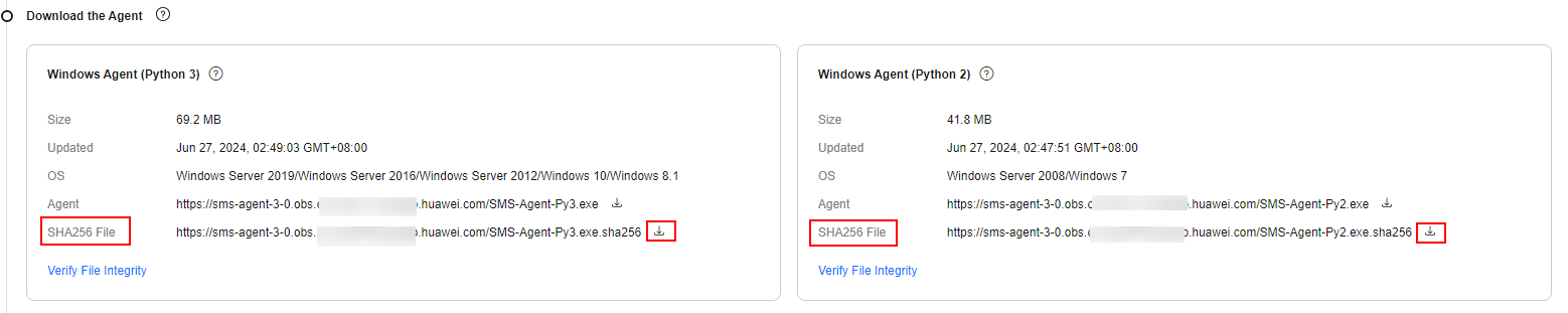

Step 1: Install and Start the Agent on the Source Server
Download the Agent from the SMS console, install it on the source server, and start the Agent. Enter the AK/SK pair for the Huawei Cloud account that you are migrating to and the SMS domain name. After the Agent is started, it reports information about the source server to SMS.
There are two options for Windows. Select the one that matches the source server OS.
Table 1 SMS-Agent versions
OS Version
SMS-Agent version
Description
Windows Server 2012, Windows Server 2016, Windows Server 2019, Windows Server 2022, Windows Server 2025, Windows 8.1, Windows 10, and Windows 11
GUI-based Windows Agent (Python 3)
Windows Agent (Python 2) can run on Windows of later versions.
Windows Server 2008 and Windows 7
CLI-based Windows Agent (Python 2)

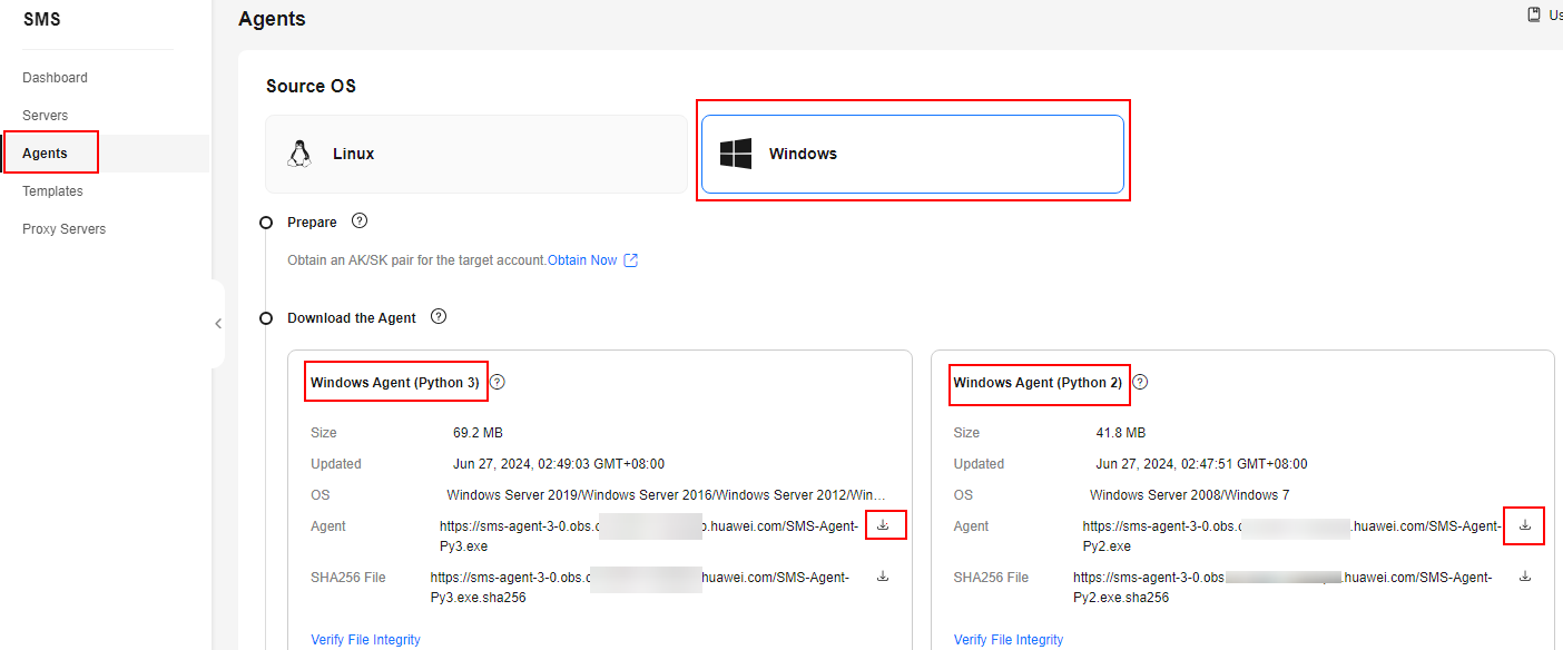

  1. Download the Agent installation file.
    1. Sign in to the SMS console.
    2. In the navigation pane, choose Agents.
    3. Select the Windows card, locate the Agent that matches the source server OS, and click the icon next to Agent.
    4. Read and agree to the service agreement, and click Yes to download the Agent installation file.

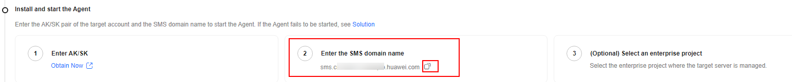

  2. Install the Agent.
    The following describes how to install the Windows Agent (Python 3). For details about how to install the Windows Agent (Python 2), see Installing the Windows Agent (Python 2).
    1. Transmit the SMS-Agent-Py3.exe file to the source server.
    2. Log in to the source server as user Administrator and double-click the SMS-Agent-Py3.exe file to open the SMS-Agent installation interface.
    3. Click Install and wait for the installation to complete.
    4. Click Finish to open the SMS-Agent GUI.
    5. Enter the AK/SK pair for the Huawei Cloud account that you are migrating to and the SMS domain name. You can obtain the SMS domain name on the Agents page of the SMS console.
    6. (Optional) If the EPS service has been enabled for your Huawei Cloud account, after you enter the AK/SK pair, the Agent will list all enterprise projects your account is allowed to access. You can select the enterprise project you would like to migrate the source server to. This enables you to isolate permissions, resources, and finance during the migration. For details, see Migrating a Server into an Enterprise Project.
    7. Click start.
    8. Carefully review the Privacy Statement and click Yes if you want to continue. If Upload success. Waiting for the SMS instruction is displayed, the Windows Agent starts. You can then proceed to configure the target server on the SMS console.

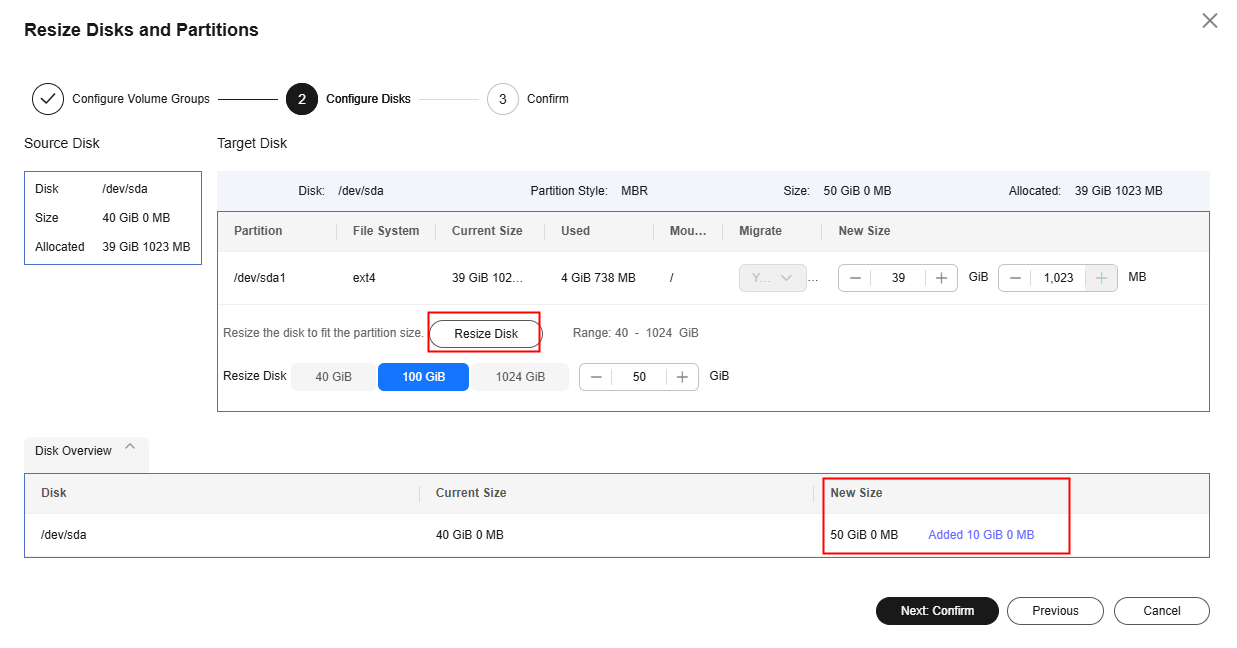

    Resize Disks and Partitions
    Disabled: The number of disks and partition size of the target server are the same as those of the source server.
    Enabled: You can adjust the number of target disks and partition size. For details, see Resizing Disks and Partitions on Windows.
  1. In the Migration Settings area, enable Resize Disks and Partitions and click Resize Disks and Partitions.
  2. Click Resize Disk and adjust the size of each disk as required. As shown in Resizing disks and partitions on Windows, you can view the resized disks at the bottom of the window.
    • If the total partition size after resizing is larger than the disk size, you need to expand the disk capacity to fit the partition size.
    • If the total partition size after resizing is much smaller than the disk size, you can downsize the disk.
    Figure 4 Resizing disks and partitions on Windows
  3. Click Next: Confirm. Confirm the configurations and click OK.
    Once disks and partitions are resized, this function cannot be undone directly. To restore your original settings, locate the resizing task and choose More > Delete in the Operation column, and then restart the Agent on the source server to reconfigure your target server parameters.
