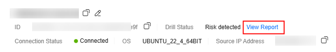

Starting a Migration Drill
Migration drills help you fully assess the feasibility and identify potential risks of a migration task beforehand. The system verifies if security group ports are set correctly, domains connect normally, and necessary permissions are available. If issues are identified, the system offers remediations to minimize risks and disruptions during migration.
After this function is enabled, the system automatically launches a migration drill before starting the full replication. The entire migration drill takes 5 to 15 minutes, and pay-per-use resources incur costs during this period. For details, see Billing. A migration drill does not transmit source data, so the fee incurred in the drill is low.
You can review the drill results in the task details. For details, see Checking the Migration Drill Status and Report.

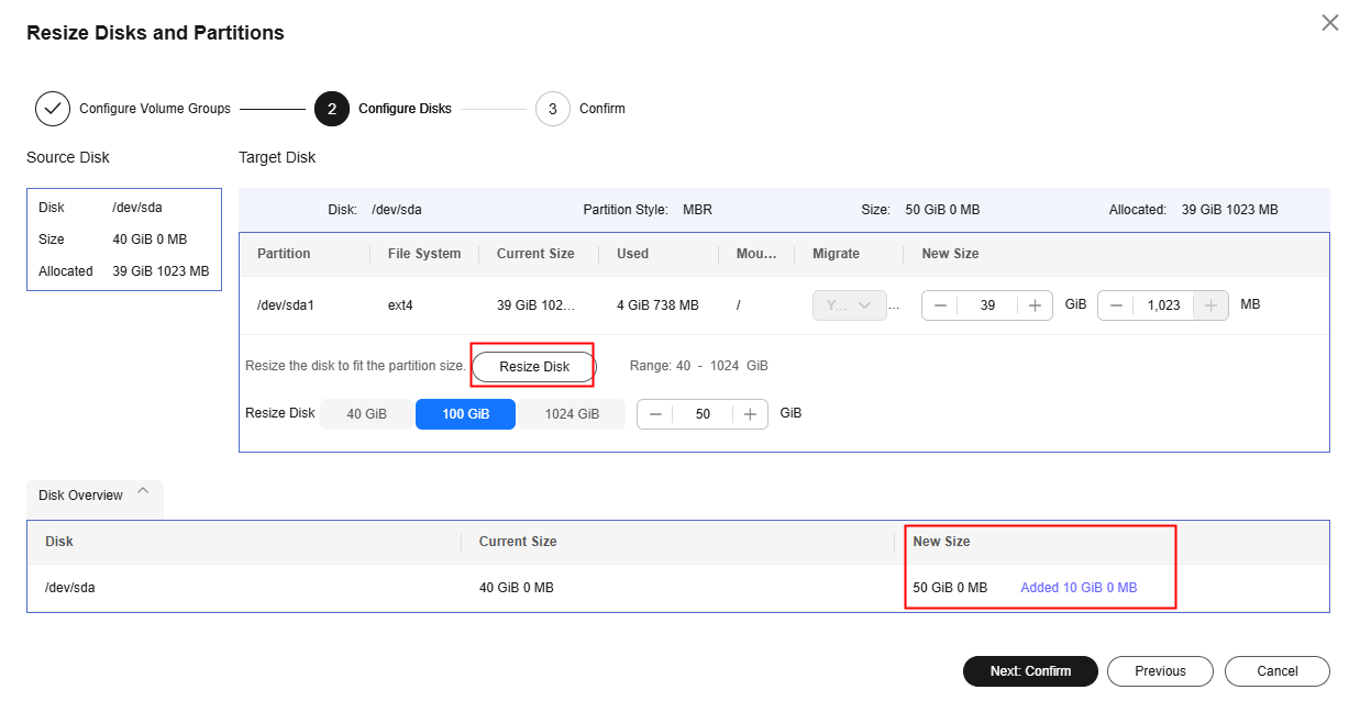

Resize Disks and Partitions
Disabled: The number of disks and partition size of the target server are the same as those of the source server.

  1. In the Migration Settings area, enable Resize Disks and Partitions and click Resize Disks and Partitions.
  2. Configure volume groups.
    • If the source server uses LVM, you can resize logical and physical volumes.
    • If the source server does not use LVM, skip this step.
    Figure 4 Configuring volume groups
  3. Click Next: Configure Disks.
  4. Click Resize Disk and adjust the size of each disk as required. As shown in Resizing disks and partitions on Linux, you can view the resized disks at the bottom of the window.
    • If the total partition size after resizing is larger than the disk size, you need to expand the disk capacity to fit the partition size.
    • If the total partition size after resizing is much smaller than the disk size, you can downsize the disk.
    Figure 5 Resizing disks and partitions on Linux
  5. Click Next: Confirm. Confirm the configurations and click OK.
    Once disks and partitions are resized, this function cannot be undone directly. To restore your original settings, locate the resizing task and choose More > Delete in the Operation column, and then restart the Agent on the source server to reconfigure your target server parameters.
If Migration Drill is enabled when you configure a migration task, you can check the migration drill status and report.
  1. In the server list, click the name of the source server to expand the migration task details.
  2. On the Task Progress tab, check the status and progress of the migration drill.
  3. In the upper part of the task details page, click View Report next to Drill Status. In the report displayed on the right, check the drill details, check items, and check results.
