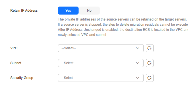

- In the Advanced Settings area, set Retain IP Address to Yes, read the on-screen warning and disclaimer, and click Confirm.
Here only describes how to configure the Retain IP Address parameter. Set other parameters as required.
- In the VPC drop-down list, select the VPC that contains the private IP address segments of the source servers.
In the Subnet drop-down list, select the subnet that contains the private IP addresses of the source servers. The system will check whether the selected subnet contains the private IP addresses of all the source servers. You can proceed with creating the workflow only if this condition is met.
In the Security Group drop-down list, select a security group as required.
