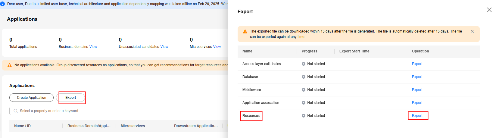

  3. Click Export above the application list.
  4. Locate the Resources row and click Export in the Operation column. In the displayed dialog box, select Servers or Databases from the Resource Type drop-down list, and click Confirm to generate a file.
    Figure 2 Exporting resource information

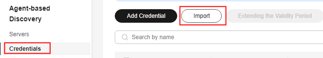

  7. On the Credentials page of the MgC Agent console, click Import above the list.
    Figure 3 Importing credentials

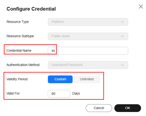

  3. In the credential list, locate the desired credential and click Modify in the Operation column. In the displayed Configure Credential dialog box, change the credential name and validity period.
    The options for setting the validity period include:
    • Custom: Set the number of days the credential remains valid. The validity period starts when you click OK to save the credential. After this period ends, the credential becomes invalid. The default period is 60 days. You can specify an integer ranging from 1 to 365. You can extend the validity period for the credential when it is in the Unexpired, Expire soon, or Expired state.
    • Unlimited: The credential remains valid permanently. You can manually delete the credential when it is no longer needed.
