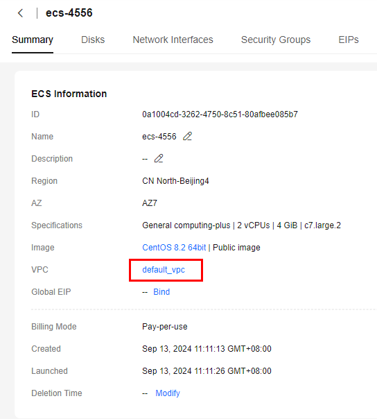

- Check whether the ECS and RDS for MySQL instance are in the same region and VPC.
Figure 5 ECS information
Figure 6 Overview
- If they are not in the same region, purchase another ECS. The ECS and DB instance in different regions cannot communicate with each other. To reduce network latency, deploy your DB instance in the region nearest to your workloads.
- If the ECS and DB instance are in different VPCs, change the VPC of the ECS to that of the DB instance. For details, see Changing a VPC.

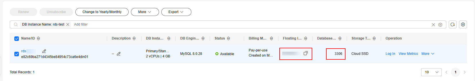

- On the Instances page of the RDS console, check the floating IP address and database port of the DB instance.
Figure 7 Connection information

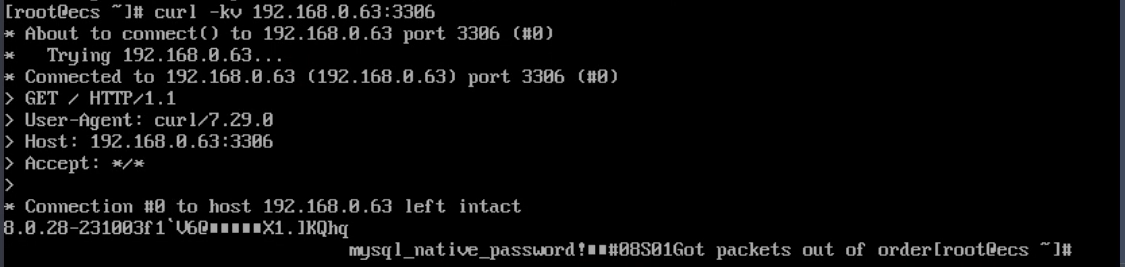

- After logging in to the ECS, check whether the floating IP address and database port obtained in 2 can be connected.
curl -kv Floating_IP_address:Port
Example:
curl -kv 192.168.0.4:3306
- If yes, network connectivity is normal. Go to 4.
Figure 8 Normal network connectivity

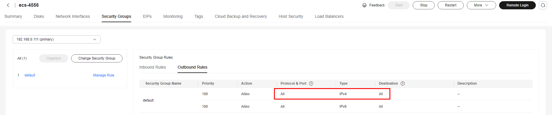

- If no, check the security group rules.
- Check the outbound rules of the ECS security group. By default, all outgoing network traffic is allowed.
If not all outgoing traffic is allowed, add an outbound rule for the floating IP address and port of the DB instance.
Figure 9 ECS security group

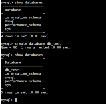

- Create a database, for example, db_test.
create database db_test;
Figure 12 Creating a database

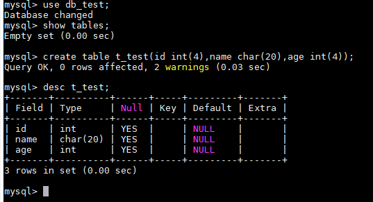

- Create a table, for example, t_test.
create table t_test(id int(4), name char(20), age int(4));
Figure 13 Creating a table

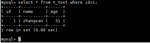

- Query the updated table data.
select * from t_test where id=1;
Figure 17 Querying updated data

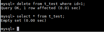

- Delete the data record whose id is 1 from the table.
delete from t_test where id=1;
Figure 18 Deleting table data

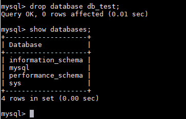

- Delete the database.
drop database db_test;
Figure 20 Deleting a database
