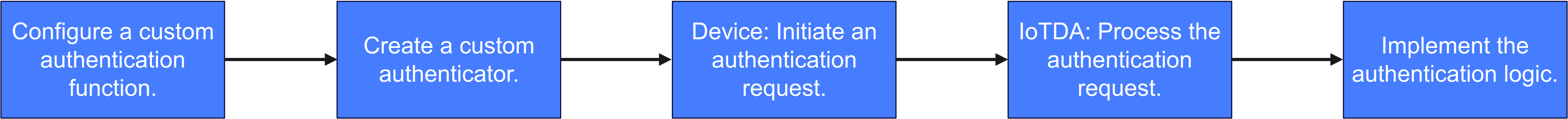

Process
Figure 2 Custom authentication process

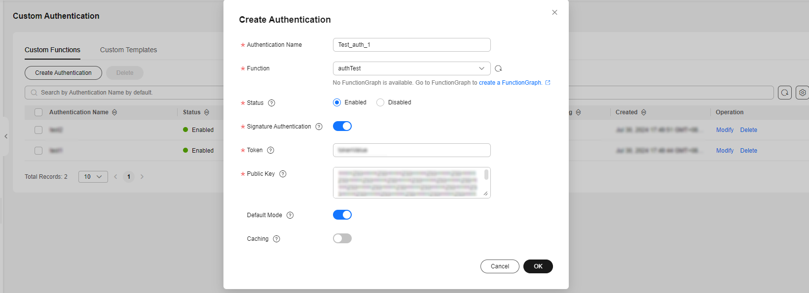

  2. Configure custom authentication on the console for storage, management, and maintenance. Max. 10 custom authenticators can be configured.
    Figure 5 Custom authentication - Entry
    Figure 6 Custom authentication - Creating an authenticator
    Table 1 Custom authentication parameters
    Parameter
    Mandatory
    Description
    Authentication Name
    Yes
    Enter a custom authenticator name.
    Function
    Yes
    Select the corresponding function from the list created with FunctionGraph in 1.
    Status
    Yes
    To use an authenticator, you must first enable it as it is disabled by default.
    Signature Authentication
    Yes
    After this function is enabled (by default), authentication information that does not meet signature requirements will be rejected to reduce invalid function calls.
    Token
    No
    Token for signature authentication. Used to check whether a device's signature information is valid.
    Public Key
    No
    Public key for signature authentication. Used to check whether a device's signature information is valid.
    Default Mode
    Yes
    After this function is enabled (disabled by default), if the username in an authentication request does not contain the authorizer_name parameter, this authenticator is used.
    Caching
    Yes
    Whether to cache FunctionGraph authentication results (disabled by default). The cache duration ranges from 300 minutes to 1 day.

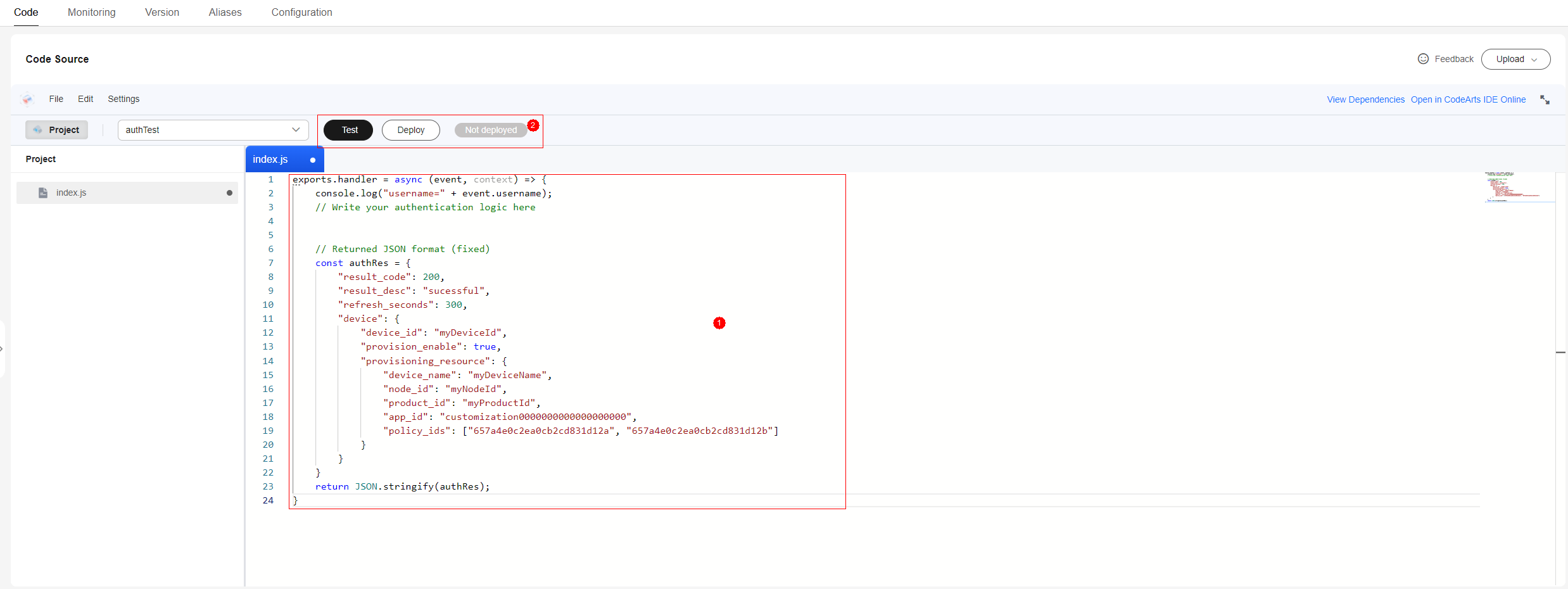

  5. Develop based on the processing function created with FunctionGraph in 1. Example for using the function and the JSON format of the returned result:
    exports.handler = async (event, context) => {
        console.log("username=" + event.username);
        // Enter the validation logic.
        // Returned JSON format (fixed)
        const authRes = {
            "result_code": 200,
            "result_desc": "successful",
            "refresh_seconds": 300,
            "device": {
                "device_id": "myDeviceId",
                "provision_enable": true,
                "provisioning_resource": {
                    "device_name": "myDeviceName",
                    "node_id": "myNodeId",
                    "product_id": "myProductId",
                    "app_id": "customization0000000000000000000",
                    "policy_ids": ["657a4e0c2ea0cb2cd831d12a", "657a4e0c2ea0cb2cd831d12b"]
        return JSON.stringify(authRes);
