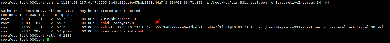

- When you establish a tunnel to connect to a cloud phone, there is no timeout exit mechanism for sessions. You need to terminate the connection in a timely manner after using it.
Take Windows as an example. After closing the terminal window, find the ssh.exe process in Task Manager and click End task.
Take Linux as an example. Run the ps –ef|grep ssh command to find the corresponding backend process, and then run the kill -9 {process ID} command to end the process.
