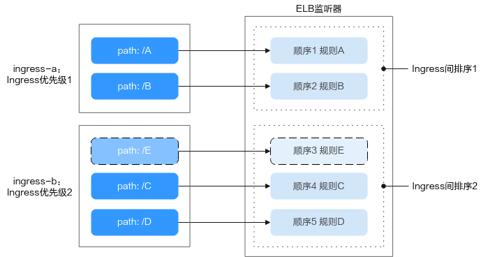

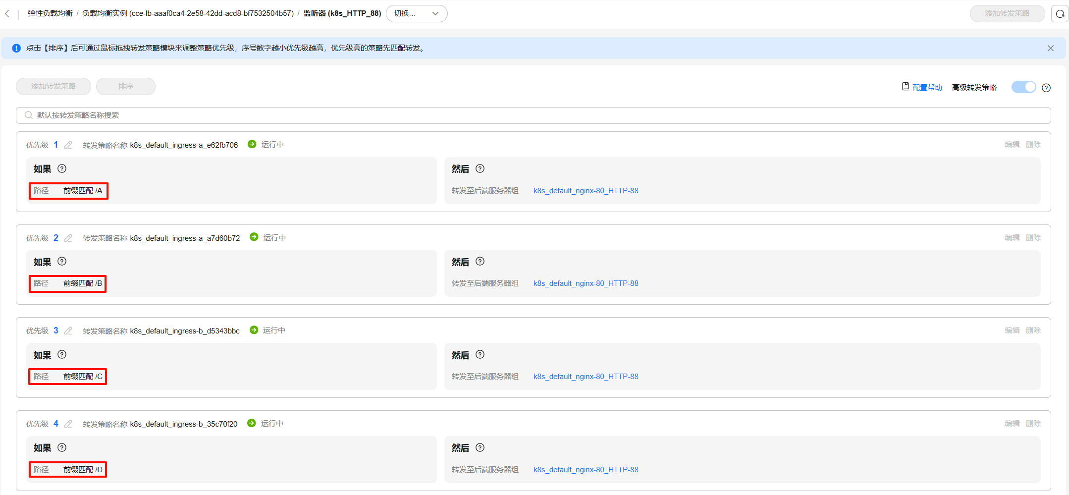

转发规则优先级设置示例
假设当前已存在ingress-a的kubernetes.io/elb.ingress-order参数值设置为1,且该ingress-a存在规则A和规则B;Ingress-b的kubernetes.io/elb.ingress-order参数值设置为2,该Ingress-b存在规则C和规则D。
ingress-a和ingress-b同时对接同一个ELB端口,此时ELB的转发策略顺序依次为:
转发规则顺序
转发规则
所属Ingress
规则A
ingress-a
2
规则B
ingress-a
3
规则C
ingress-b
4
规则D
ingress-b
图2 ELB的转发策略顺序示例1

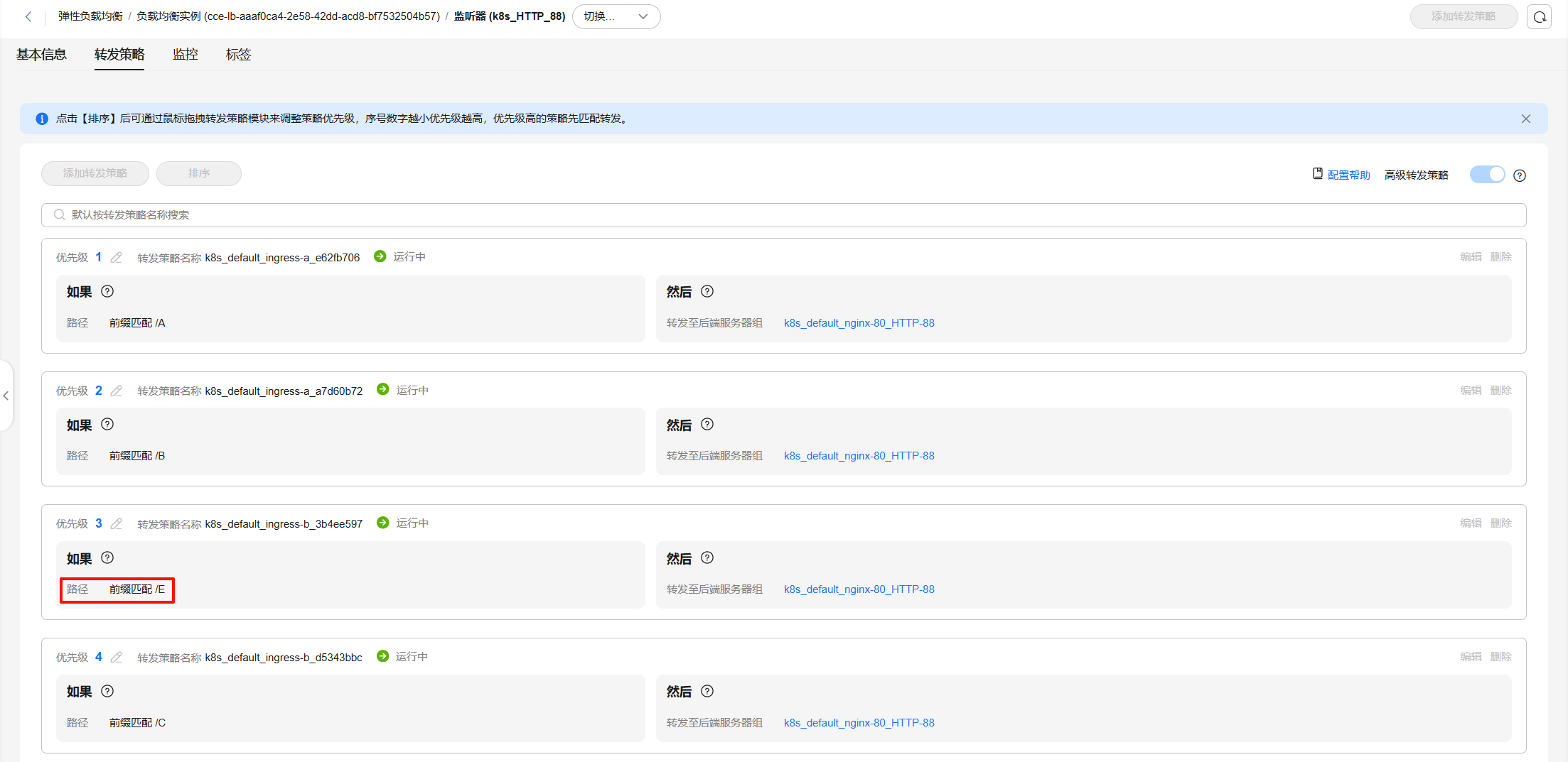

如果此时为ingress-b添加规则E,并将规则E的顺序设置在规则C、D之前,修改ingress-b的YAML如下:
apiVersion: networking.k8s.io/v1
kind: Ingress
metadata:
  namespace: default
  annotations:
    kubernetes.io/elb.port: '88'    # 对接的ELB端口
    kubernetes.io/elb.id: f7fb2aa8-34af-48fb-b451-16e8f675ff45   # 已有ELB的ID
    kubernetes.io/elb.class: performance    # 已有ELB的类型,该功能仅支持performance
    kubernetes.io/elb.ingress-order: '2'    # 不同Ingress间的转发规则优先级
    kubernetes.io/elb.rule-priority-enabled: 'true'   # 同一个Ingress的转发规则按照paths字段下的转发规则顺序进行排序
spec:
  rules:
    - host: ''
      http:
        paths:
          - path: /E  # 定义转发规则E
            backend:  # 该规则对应的后端Service,示例可进行替换
              service:
                port:
                  number: 80
            property:
              ingress.beta.kubernetes.io/url-match-mode: STARTS_WITH
            pathType: ImplementationSpecific
          - path: /C  # 定义转发规则C
              service:
                port:
                  number: 80
            property:
          - path: /D  # 定义转发规则D
              service:
                port:
                  number: 80
            property:
  ingressClassName: cce
则此时ELB的转发策略顺序依次为:
转发规则顺序
转发规则
所属Ingress
规则A
ingress-a
2
规则B
ingress-a
3
规则E
ingress-b
4
规则C
ingress-b
5
规则D
ingress-b
图3 ELB的转发策略顺序示例2
