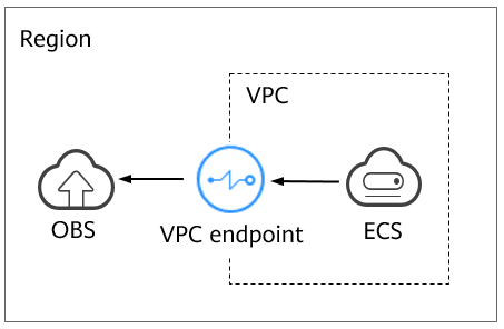

In the same region, if you want to use a VPC endpoint to access OBS over a private network, add OBS as a VPC endpoint service, and create a corresponding VPC endpoint in your VPC. You can then access OBS via the VPC endpoint.

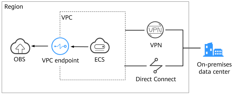

If you want to access OBS from an on-premises data center over a private network, use Direct Connect or a VPN gateway to set up a bridge between the on-premises data center and the VPC that is in the same region as OBS. Then, use a VPC endpoint to connect the VPC to OBS.

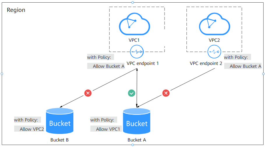

How the Dual-Policy Approach Works
Figure 3 How the dual-policy approach works

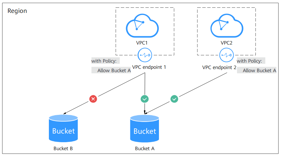

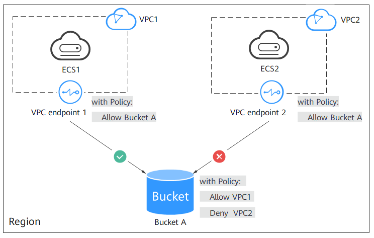

VPC endpoint policies and OBS bucket policies ensure data security by working on the request sources and the requested resources, respectively.
A VPC endpoint policy defines which resources in OBS can be accessed by servers (ECSs or CCE) in a given VPC. As shown in Figure 3, VPC endpoint 1 allows servers in VPC1 to access bucket A but not bucket B. Therefore, VPC1 can access bucket A but cannot access bucket B.
A bucket policy specifies servers in which VPC can access specific OBS buckets. As shown in Figure 3, bucket A's bucket policy allows requests from VPC1 but denies requests from VPC2. Therefore, VPC1 can access bucket A, but VPC2 cannot.

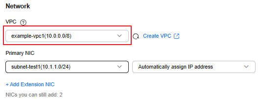

example-ecs1
Create this ECS in the example-vpc1 VPC and select a Linux OS, for example, Ubuntu 24.04 server 64bit(10GiB).

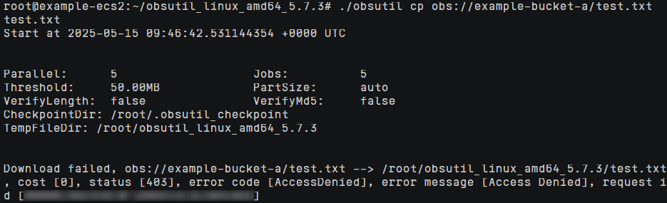

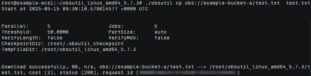

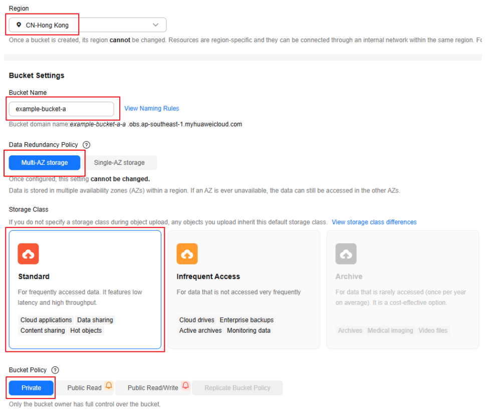

example-bucket-a
The bucket policy allows access from example-vpc1 and denies access from example-vpc2.
