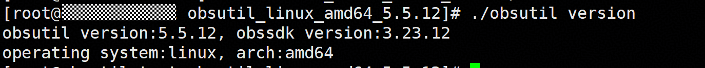

- Continue to run the following command in the directory. If the version number of obsutil is returned, the installation is successful.
./obsutil version obsutil version:5.7.9, obssdk version:3.24.12 operating system:linux, arch:amd64
