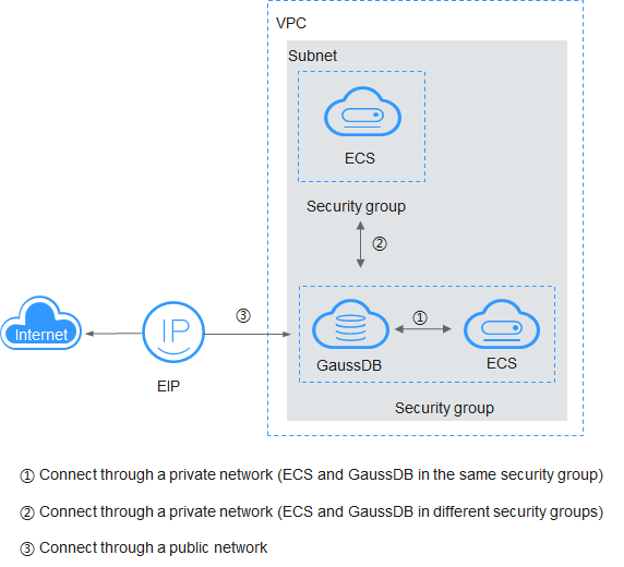

Figure 1 shows how an instance is connected.
- If the ECS and GaussDB instance are in the same VPC and security group, they can communicate with each other through the private network by default. In this case, you can connect to the instance through a private IP address.
- If the ECS and GaussDB instance are in the same VPC but different security groups, you need to set security group rules for both the GaussDB instance and ECS, and then connect to the instance through a private IP address.
- GaussDB instance: Configure an inbound rule for the security group with which the GaussDB instance is associated. For details, see Configuring Security Group Rules for a GaussDB Instance.
- ECS: The default security group rule allows all outgoing data packets. In this case, you do not need to configure a security group rule for the ECS. If not all outbound traffic is allowed in the security group, you need to configure an outbound rule for the ECS to allow all outbound packets.
- If the ECS and GaussDB instance are in different VPCs, you can bind an EIP to the ECS and use the EIP to connect to the instance. Ensure that both the ECS and GaussDB instance have EIPs.
- For details about how to bind an EIP to an ECS, see Binding an EIP.
- For details about how to bind an EIP to a GaussDB instance, see Binding an EIP.
